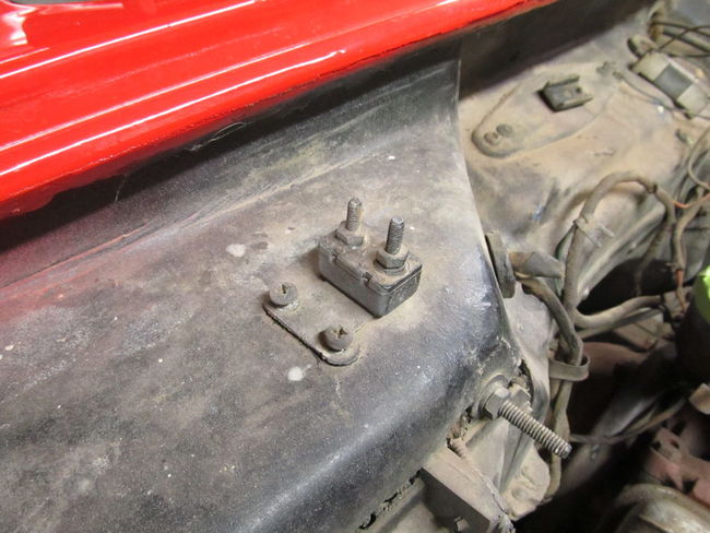

here is a picture of what appears to be a junction terminal
on the right upper side of the firewall area.
i cannot find any reference to it in any of the shop manuals
or restoration books or the the wiring diagrams.
i am waiting for my judging manual, hoping it will be in there.
does anyone know what this terminal is for
and how to wire it correctly?
thanks
iowa
Old Apr 29, 2011 | 10:37 PM
partsman41's Avatar
Joined: Aug 2008
Posts: 337
From: Battle Mtn NV
That is a circuit breaker and was probably added to power an accessory of some sort. Unlikely to be factory,possibly dealer installed,more likely previous owner.
