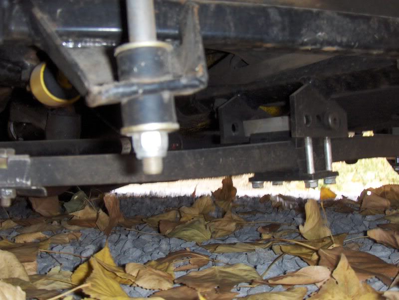

Left rear spring responce adjustment.
Left rear spring height adjustment.

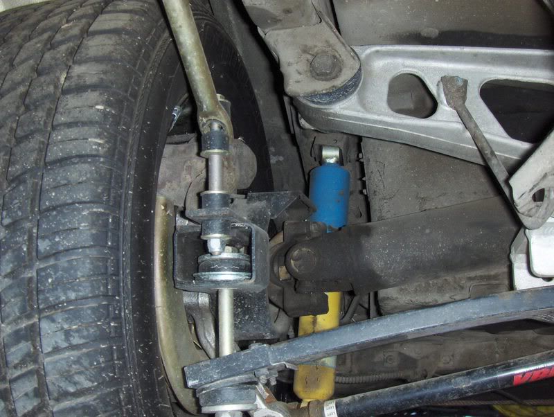

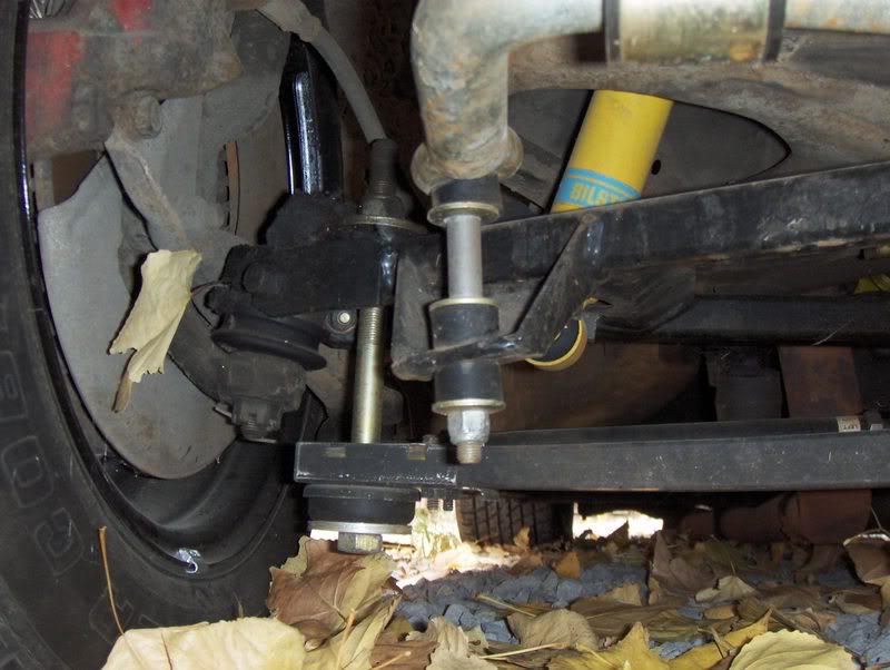

Right front responce adjustment.
Right front ride height adjustment.

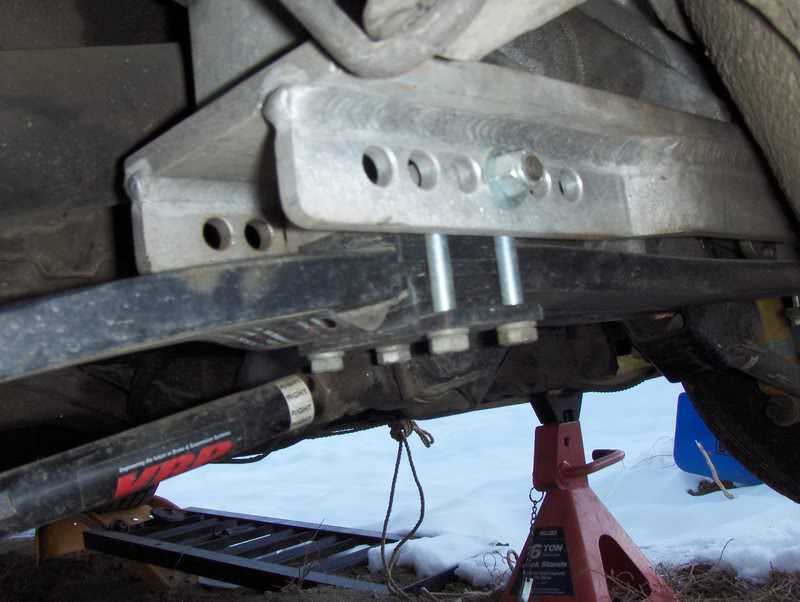

I like the way you can easily adjust the spring rate on the VB design. I noticed a "Right" label on the left strut rod. Is that OK? Also did you have to weld the brackets on for the front spring?

No welding, it is a bolt on system.
The strut rod goes to the right side of the left side. The other one is labled for the left side of the right. Follow me? That way you don't swap ends. It confused me at first, but that's how the paperwork shows it.
