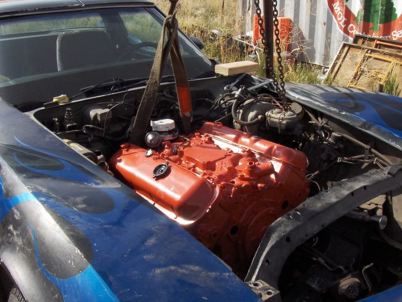

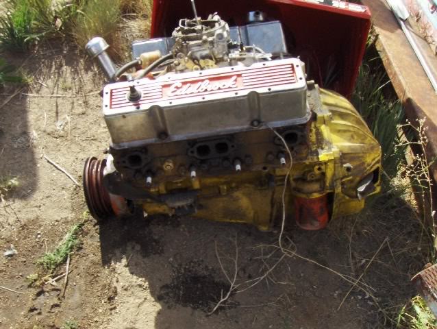

Y'all have been so patient, ( well, most of ya ),so here's a few pics ta get cha by.
This,
used ta be here.....

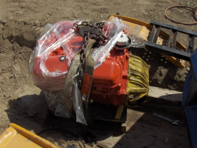

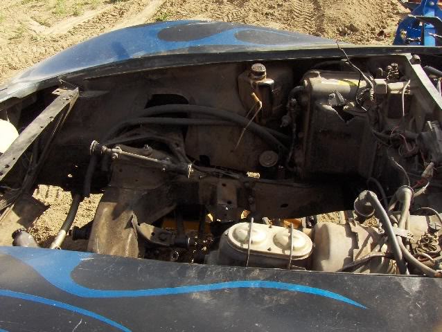

Now this,
is in it's place!
So ya see,.....
I am makin' progress.
