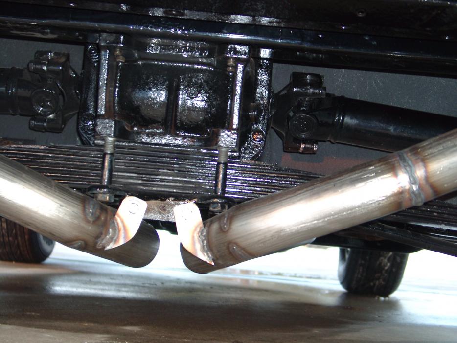

I struggled with the hangers also but decided to do my own thing to better secure the system. Here was my solution:

thanks for the info guys i really appreciate the picture Watwheel and i was thinking of doing something similar
