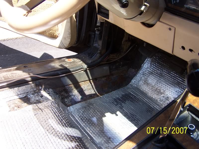

Here is my cockpit insulation project. First I removed the seats, 4 bolts each, then the door sill plates and the center console side covers and finally the carpeting. Here is what I found.

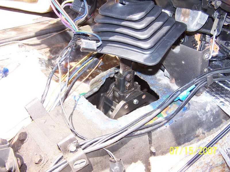

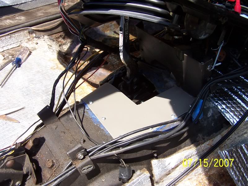

It looks like someone made a half hearted attempt at installing some insulation. I took out the partial sheets of insulation and tossed them in the trash. Then I opened up the center console and found BUBBA WAS HERE - check out the extra large hole for the shifter.

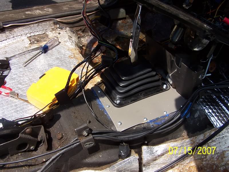

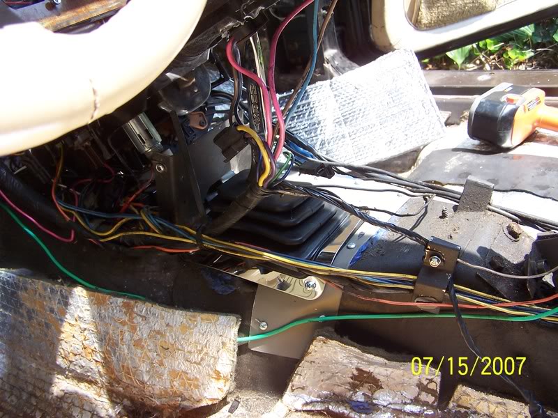

This is most likely where a lot of my unwanted cabin heat was coming from as well as a lot of extra noise too. I took some coil stock (aluminum siding) and fashioned a patch for the transmission tunnel, then installed a rubber shift boot.

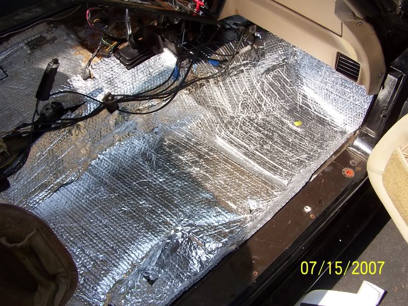

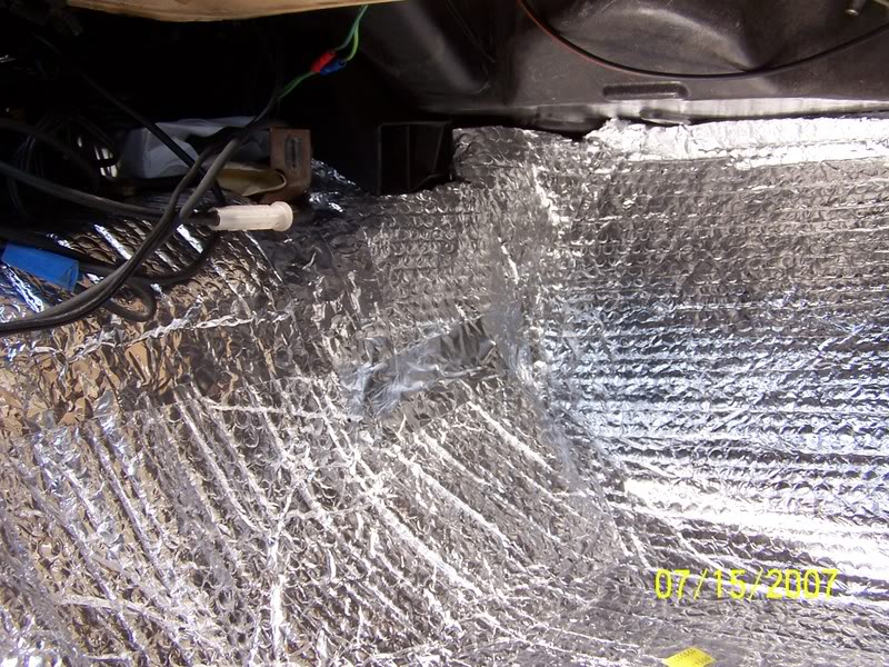

Then I purchased some Reflectix from the local building supply store, it is supposed to reflect something like 90% of the heat. It is also an economical alternative to Dynamat. It took about 6 feet to do each side of the car plus some extra pieces to do the transmission tunnel. I pushed the insulation into place, cut it to fit with scissors and a utility knife and I used foil duct tape to seal the seams.Name:  100_2552.jpg

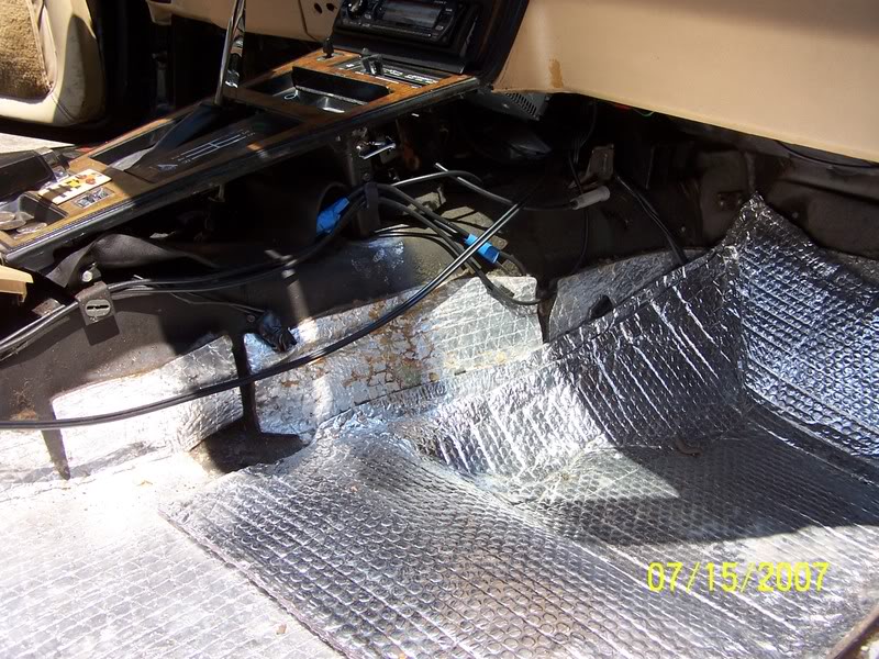

I was also careful to try and get up under the dash as closely as I could.Name:  100_2553.jpg
After the insulation was in on both sides I simply reinstalled the carpet, the sill plates, center console and side covers and the seats. The whole project took about 3 hours. Cockpit heat and noise have been reduced dramatically. My comfort level has increased and I had a good time doing the installation, it was not a very hard job to do. I highly recommend this project for everyone. Cost was about $50.00

DeeVeeEight, you do good work! That bottom shifter boot is sometimes overlooked, by fixing that you eliminated a major amount on heat. Well done, and again thanks for sharing and helping, PG.

I have one of those "Bubba special" shifter holes too. [&o]
Since I work at a metal plant, I'll use the same cure.

The reflectix is a thin sheet of bubble wrap with a layer of what looks to be aluminum foil on both sides. Total thickness is about 1/8" or less, it comes in a roll and is available in different widths. I found it in the heating and air conditioning area of the local home improvement store.
