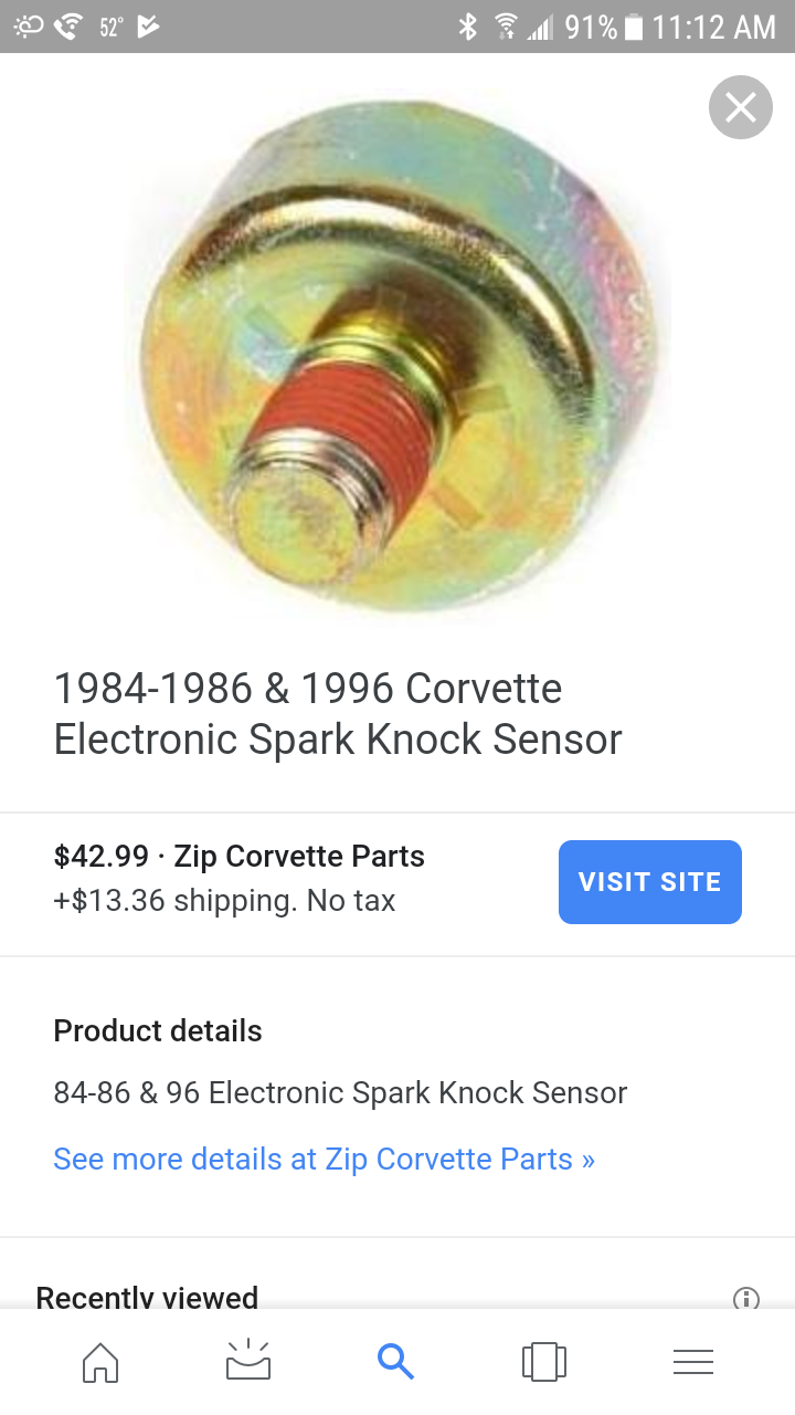

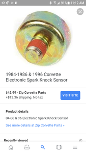

Zip Corvette lists a knock sensor for a 84-86.
Attached Thumbnails ESC on 82 Collector Edition-screenshot_20180426-111201.png
