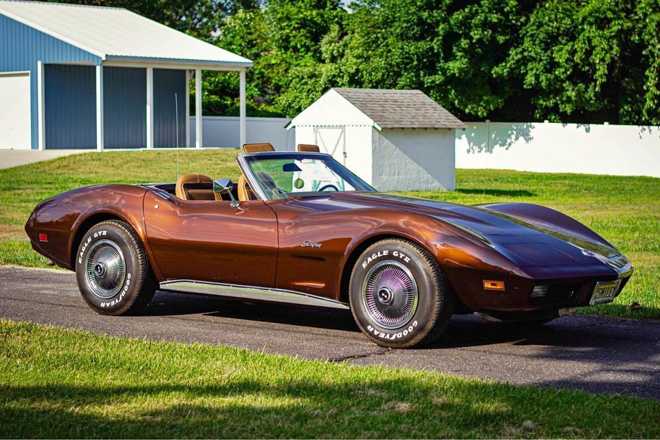

So, I just bought (yesterday) a 1974 convertible, and as a senior citizen am fulfilling a goal I should have reached many years ago in buying a C3 roadster. I have owned several Corvettes in the past, a couple C3's many many years ago (late 70's coupes) and then the infamous '84, then, I think, three, if I recall correctly, late 80's to mid 90's examples, and finally, my last one, a 2003 droptop we bought new and enjoyed for 3 years until very stupidly trading it in for a new 2006 final year SSR. (Please try to stifle your laughter guys!)
Anyway, I always loved the C3 ragtops and on impulse bought a local one offered for sale, a root beer finished auto trans L48. But it's nicely equipped with factory AC and I was extremely pleasantly surprised to discover upon arriving to see the car that the couple selling it had neglected to mention in their ad they also had the matching factory hardtop!
The car needs front and rear bumpers, and the AC isn't blowing cold, but my two "big" questions for you guys are:
1. The driver side window is down and won't go up. The prior owner said the window motor had been replaced about two years ago and because they rarely drove the car (and stored it with the top down and the windows down in their garage) they weren't even aware the window wasn't working until I tested it. Anyway, when I hit the switch and listen very carefully in a very quiet place, I can hear a very faint sound, and I don't know how to describe it....(it's not a "click", more like a very slight "thump" but VERY hard to hear), coming from the inside of the door. I'd love to hear some suggestions on what to do to track down the likely cause of the problem. The prior owners "guess" they may have cycled the window less then a dozen times since the repair.
2. The brakes. Now, as I said, I have owned C3's before, but the last one was over 30 years ago. I don't remember it being so hard to stop the car!! Now, of course I am used to our rather new Genesis G90's instant response to a very light brake, and my 2019 Ram 1500 also stopping with a relatively light touch. Am I just being swayed by what I am used to, rather than what I should expect from a car that is literally a HALF-CENTURY old? The car stops straight, no brake noise of any kind. It just takes what feels like so much more pressure to make it happen! To put it in perspective, it reminds me of my first car, a 1964 Chevy Biscayne that had no PS. no PB, no power ANYTHING. That's how the brakes on this little Vette feel. Normal for this car? I don't remember my past C3's feeling this way, but again, I am old, and my memory of my past C3's are from 30+ years ago and perhaps tainted my what I now drive everyday.
Finally, for now anyway, I was given a binder with receipts from a prior owner which is great! It shows that the AC was converted back in 2001. But the compressor, which is not activating now although all hooked up, (although that can be as simple as loss of freon) still has the old label on it for the old freon type. Shouldn't the mechanic have placed a replacement freon type label on it? How can I determine if in fact the work was actually done? BTW, the fan motor blows VERY weakly even on high. It does modulate even weaker when set on lower settings, so is this what should be expected, (unlike the arctic blast force of my new vehicles), or is this another issue to be fixed?
Looking forward to any advice and/or suggestions you guys can offer!

There are those people who will pay more for a car based on its color, but being a roadster with both tops, in very nice condition, I don't think so. At least not a significant amount. I'm curious as to why the bumper covers need to be replaced. How about pictures of the damage? Maybe check with your body guy about repairs?
Old Jun 25, 2024 | 10:01 PM
Posts: 977
I like brown, it's not my first choice. But it looks good with the buckskin interior. I'm not sure if it would hurt the valve much. It was the last year for the C-3 Roadsters until he 80s, so that's a plus. What color are the tops? I once had a Blue 70 with a white soft top and a Black vinyl hard top. From what I can see from the picture the front bumper has waves in it on the left side. I myself can put up with a lot of waves at $500 a pop for bumpers and the TruFlex are not a lot cheeper.
