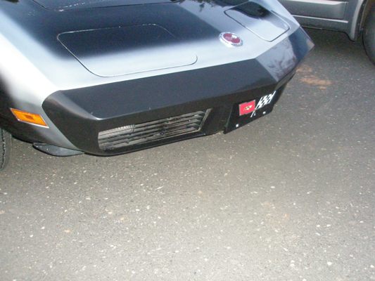

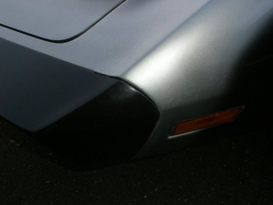

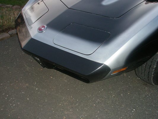

Old Mar 11, 2010 | 04:13 PM
SCHOON's Avatar
Joined: Sep 2006
Posts: 544
From: Flemington, NJ
Hope these pictures will give you an idea of the fitting
Attached Thumbnails Front bumper cover-vet1.jpg   Front bumper cover-vet2.jpg   Front bumper cover-vet3.jpg
Looks good. Is it a Tru-Flex?
