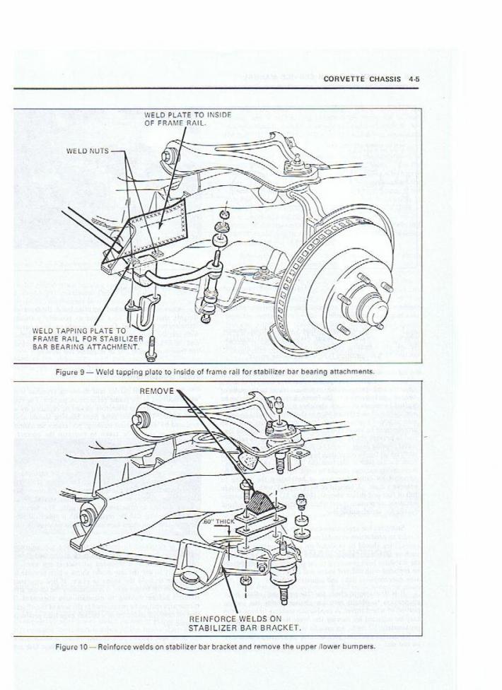

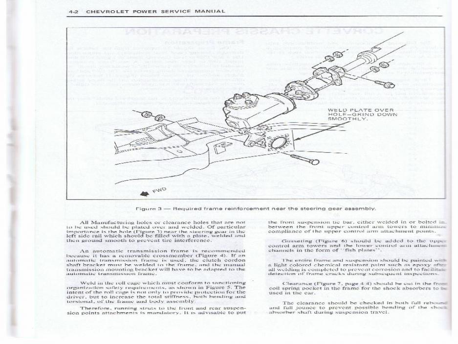

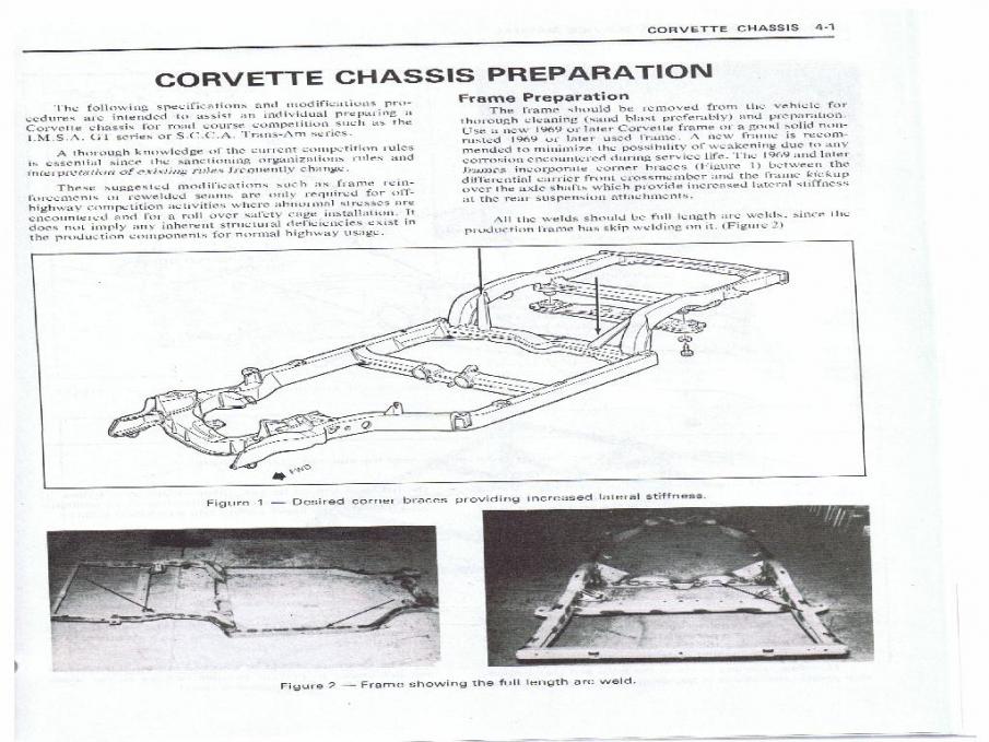

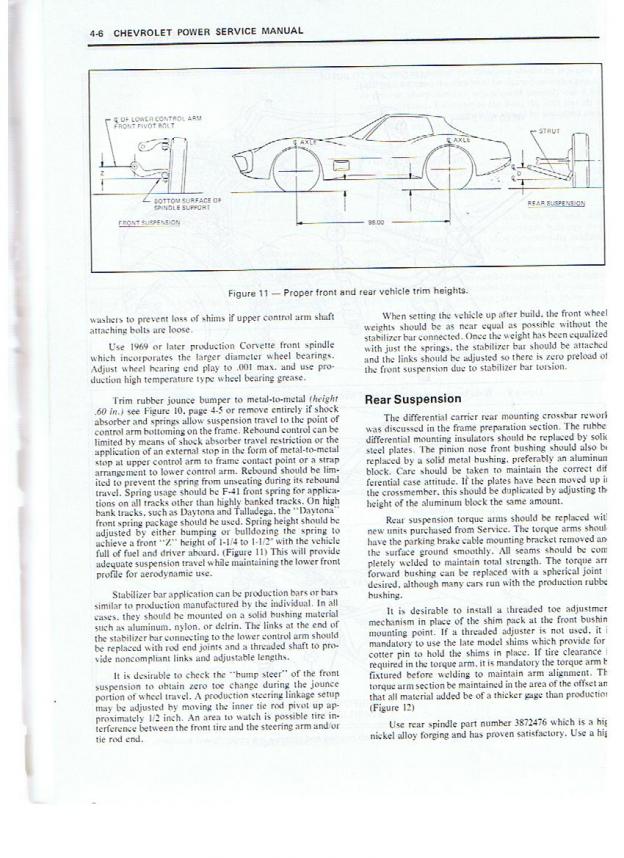

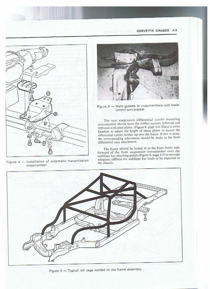

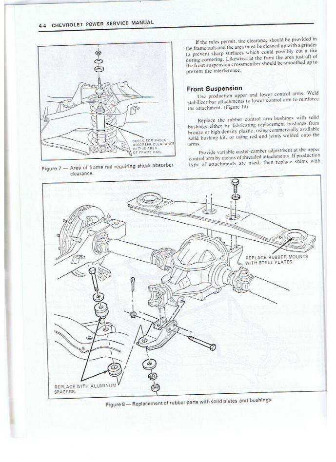

Old Jan 27, 2009 | 11:27 PM
Will add the rest tomorrow. I have a love/hate relationship w/ my scanner plus for some reason I can't add pics on my PC, so have to transfer to laptop to add to post.
Attached Thumbnails  gussets question-corvette-chassis-2.jpg    gussets question-corvette-chassis-3.jpg    gussets question-corvette-chassis-4.jpg    gussets question-corvette-chassis-5.jpg
File Type: mov
Old Jan 28, 2009 | 11:34 AM
Here's the last one as there is a limit of five. This comes from the Chevrolet Power 2nd edition book circa 1976.
Hope this helps.
