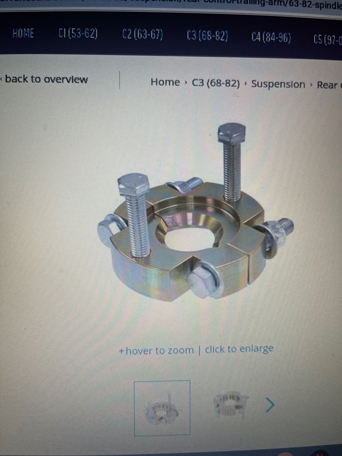

Pictures of trailing arm spindle puller It`s been used since 1963, expensive most mechanics built their own from the original. C-2 and C-3 tool

If the rear wheel bearings don't need to be replaced, there is a tool that goes on the inside after taking the U-joint off of the spindle. Basically it allows you to inject wheel bearing grease using a grease gun between the inner and outer race of the bearing. Granted this only does the inner bearing but I've done it over the years and have over 70,000 miles and the bearings are still good.
