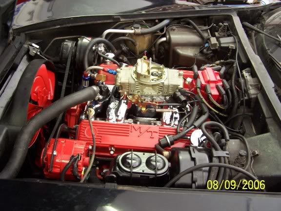

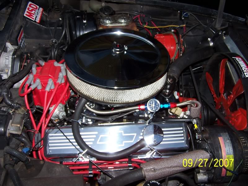

Hi Aldo,
Here'sthe carburetorI have on my engine, but I have an Edelbrock RPM Air Gaphi rise intake manifold and an aftermarket hi rise hood. This carburetor has mechanical secondaries which are desireable for manual transmission cars. I removed the manual choke and added an electric choke kit to mine.
http://store.summitracing.com/partde...p;autoview=sku
I use a 14" air cleaner with a drop base and I use an air filter for a 1969 Corvette (350 engine) which is not as tall as the later ones, itgives me a little more hood clearance.
Here's the carburetor and intake manifold
