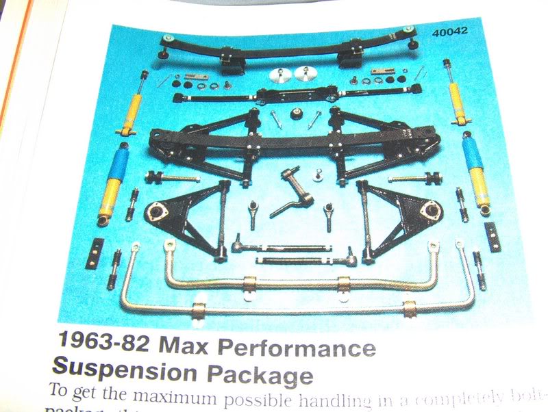

I've been looking at ecklers, but I'm not really sure which kit I should get for the monospring conversion. What all do I need? Is there a complete conversion kit that will come with everything?
Old Oct 14, 2007 | 11:02 AM
  #12
Default RE: I could use some help deciding what to buy..
Ecklers front conversion kit, part number, A7181. $789.99
rear kit, part number, A7138. $ 489.99
The complete system that I chose, see below.....
That's everthing you'll need for a complete conversion. The system bolts right in, with no mods required.

Very nice
I think I'm going to order the rear set now.
