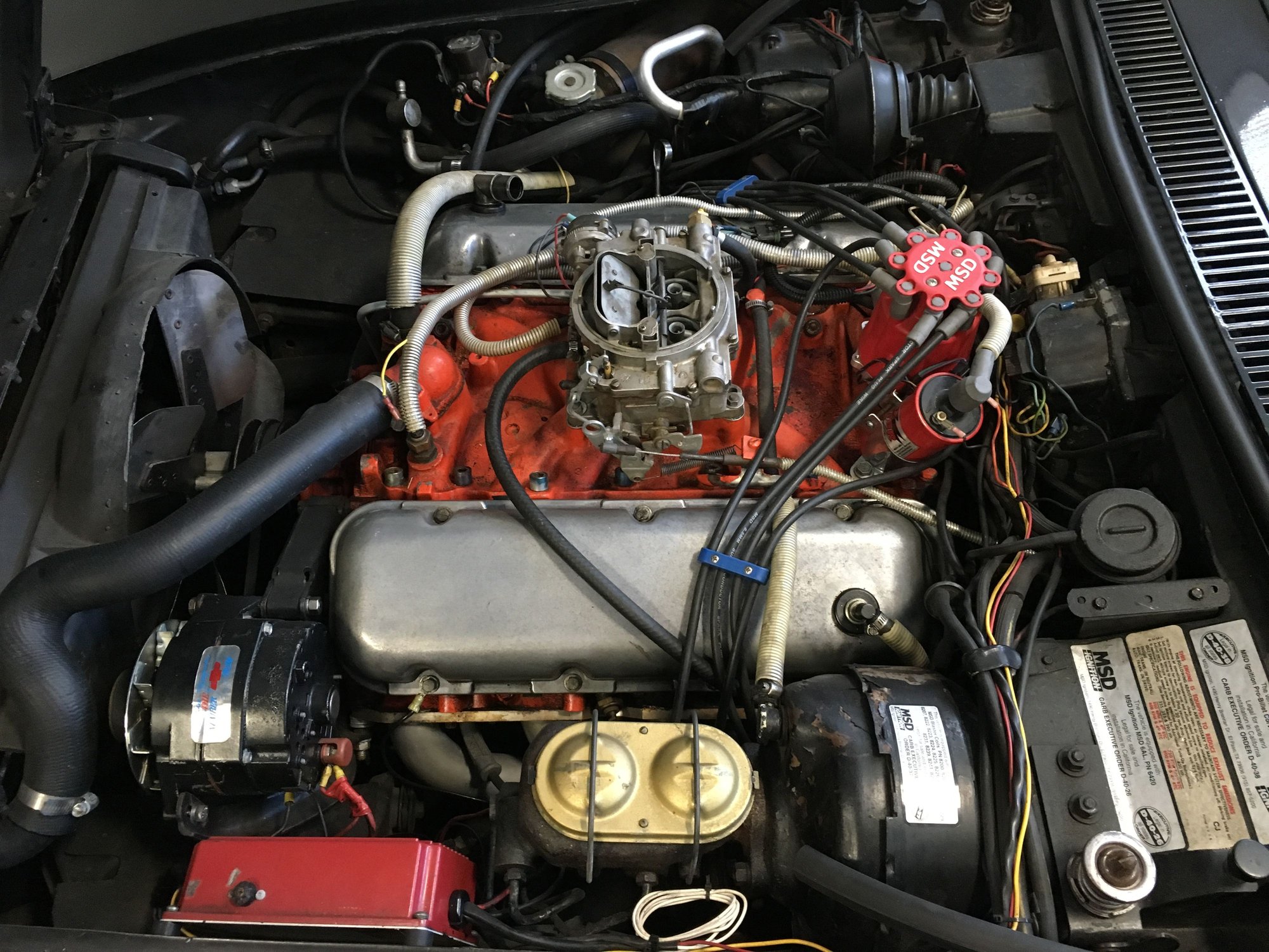

Hi all, newbie here, I just inherited a 1969 Stingray Coupe with a built LS1 427 from my dad who had decided that he can no longer give this car the level of love and attention it needs/deserves. The car has some deficiencies (probably more than I know right now) but at the minimum he hopes that I can get it back on the road so he can enjoy a few nice weekends with it this summer. The car's been garaged since winter of 2017 with carb and exhaust leak problems.
This car was built by a guy named Tod Howarth (you may have heard of him) in 1981 and was raced all through the 80's. Tod told me that it has an LS1 with a Cam pushing at least 475 h.p. (for some reason, my dad seemed to think it was 550 h.p. but he never dyno'd it to my knowledge).
Here's what I know about the car:
-Holley Pro-Jection (analog) 900 cfm 4 bbl throttle-body fuel injection
-Holley Street Dominator Intake
-MSD ignition
-Headers
-4 speed transmission (not sure what though, no reverse light connector, any ideas?)
Here's the issue.
Last winter he figured out that one of the injectors on the TBI seized (due to water getting into the gas tank and the car being outside in freezing temps) so his mechanic removed the Pro-Jection system and put a borrowed Edelbrock 4bbl carb and mechanical fuel pump on it so he could drive it up to my house for winter storage. So now I need to to give this carb BACK to his mechanic but I don't know what to put on there. Should I go back to EFI and spend tons of money on a new self tuning system? Or should I find a decent carb? What though?

Bob: Welcome to the forum. Assuming you have a square bore manifold, I would go ahead and put a Holly or other brand four barrel back on it. If the rear rotors still have the rivets holding them on, be sure to mark the rotor position so you can put them back on in the same position. This is because they are machined as an assembly and if you re-index them, the run out will most likely be out of spec. Also highly recommend using a stainless steel parking brake rebuild kit.

Congrats on the project! Personally, if it was setup by a builder with the EFI I would try to match that. A builder knows more than I. Plus I like to do some playing/learning with tuning.
