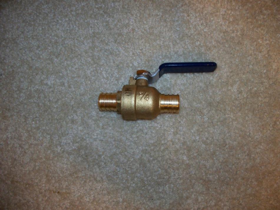

Hi MikeC3, looks like you have a good idea! I put a ball valve on the 5/8 line last year but the heat still came in after a while, just got the 3/4 shut off and will be installing that this week. Let's see if the A/C works any better with two valves, PG.

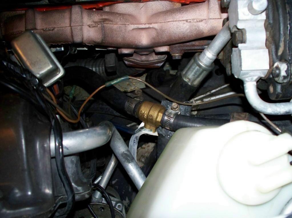

Here's the 5/8 one installed

That looks a lot cleaner than the gate valves I used. I've seen some vacuum operated dual valves but can't remember where. One of these days will have to look again.

Thanks for the reply DV8, the only seals that I can confirm that are good is the one inside the right kick panel. I still have only the one ball valve shut off installed on the 5/8 heater hose. It works 100% and I had it in the off position today. I turned the thumb wheel to heat and got heat inside the car? Than I turned that thumb wheel to cold and turned the A/C thumb wheel to max A/C and got cool air. I'm don't understand how I could get hot air inside the car with the ball valve on off. I will install another ball valve on the 3/4 hose this week and see what happends then. I still have the R12 A/C system. I'll let you know what happends next.

Hey PG. I put in both manual ball valves last week. I didn't want any hot water to seep back up the other hose so I completely blocked off the heater core. It was pretty warm out this weekend and got to go for a few rides and I'm extrememly pleased. There was no hot air coming from the vents at all. The air that did blow through was just about outside air temp.

PG, I think the reason you need a valve in the return line is because of the heat conduction thru the water eventually heats up the water in the heater core.

There is a definite difference with the heat coming from the vents after plugging both hoses. And, in the winter, I'll need to open the valves for heat, so it's perfect.
