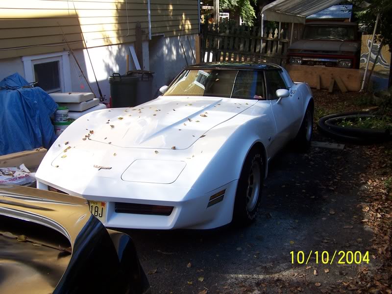

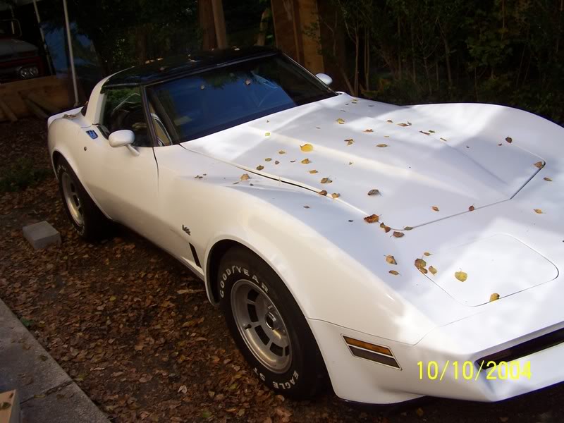

Before I found Christine, my '79 Corvette, I had purchased a white 1980 Corvette from a seller in Salem, Oregon that I saw on ebay. The sellers statement went like this - "1980 Corvette, 350, auto, air, PS, PB, PW, body and paint are straight, this car has never been in an accident. So I waited for the end of the sale and bid on the car. I won it and then I arranged to have the car shipped cross country. A few weeks later this is what I got.
Not too bad looking at first, then I took her to my mechanic for a look see, here's where the nightmare starts.

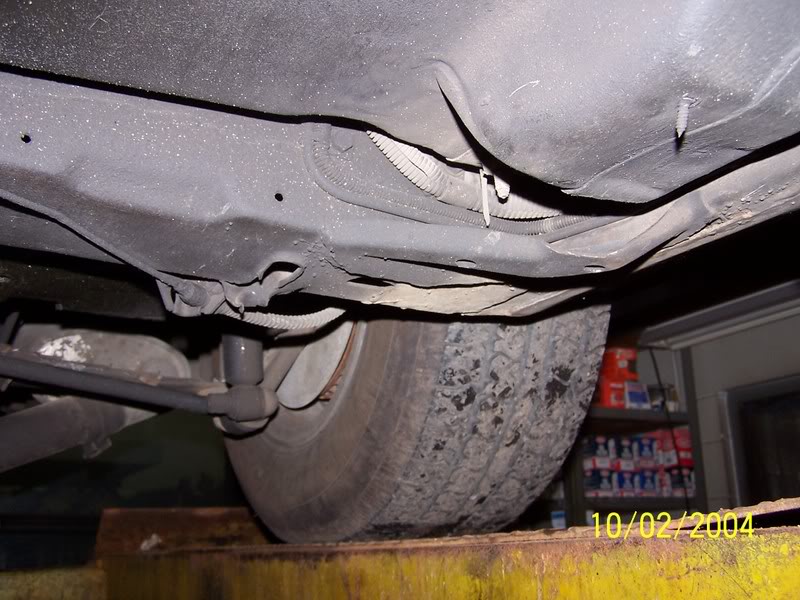

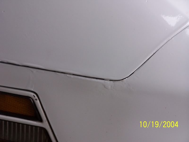

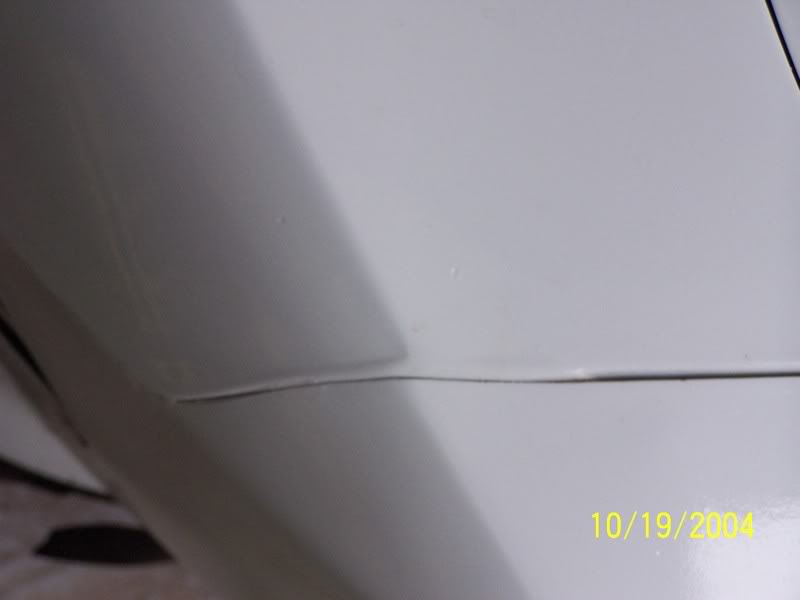

You just got to love the body shop that did this work!
Notice how the corner of the frame is kinked and the frame holes are torn out.

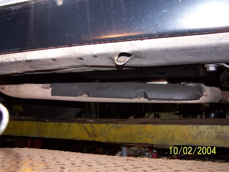

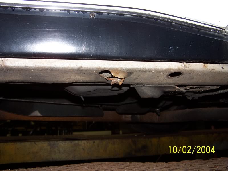

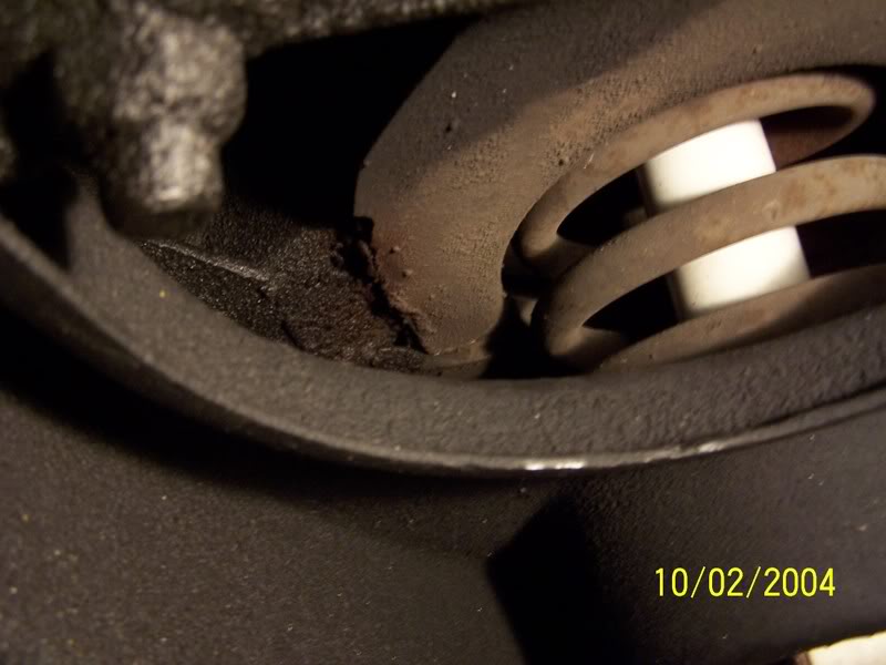

Here the spring pocket and frame are cracked straight through and need to be re-welded.

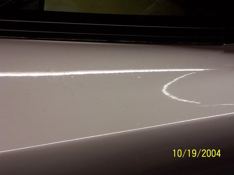

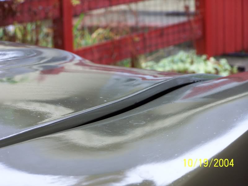

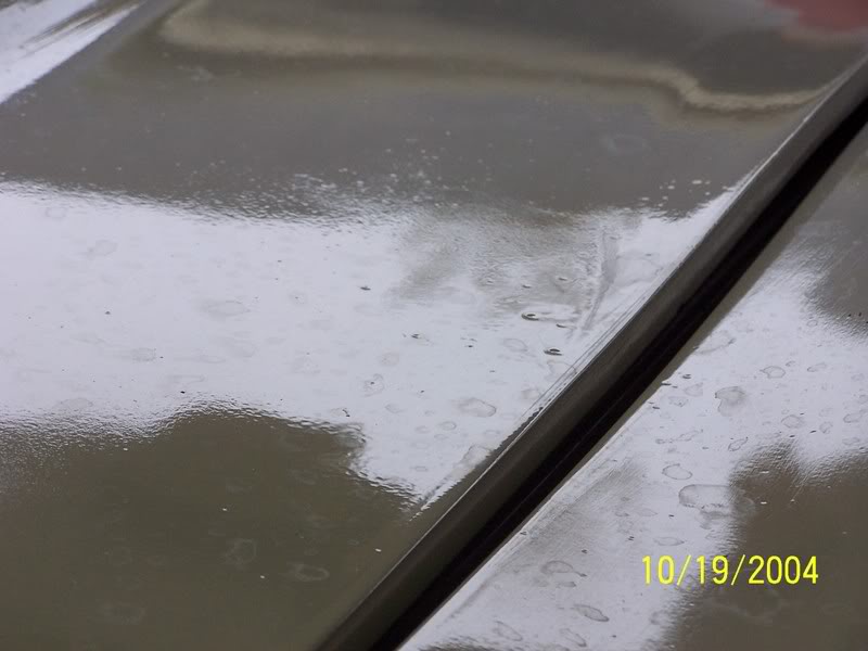

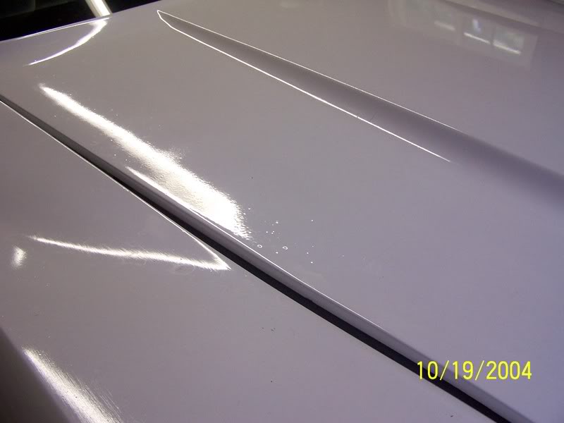

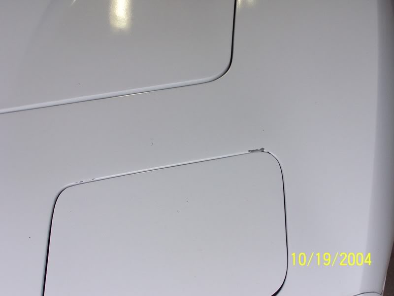

A stock hood should not be as badly misaligned as this is and you just got to love the mirror finish on the paint! It looks like it was sanded with 80 grit paper and then painted.
