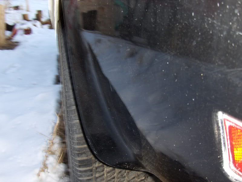

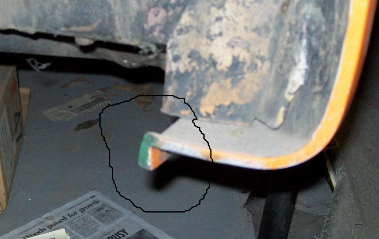

The stock wheel offset is -0.5" (~-13mm). I have the American Racing Vectors which are 8.5" wide. With 255/60X15 BFG T/As, only required minor trimming on inner fender lips up front.
Attached Thumbnails Now on to rims and tires-corvette-fender-relief-001-cropped.jpg   Now on to rims and tires-corvette-fender-relief-002.jpg

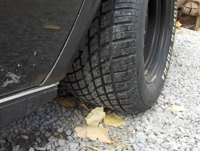

My 10" rear tires on 8" rims. I have 9" tread in front. I think it's a great look!
Note the space at the top of the tire, between the tire and the fenderwell. Plenty of room.
