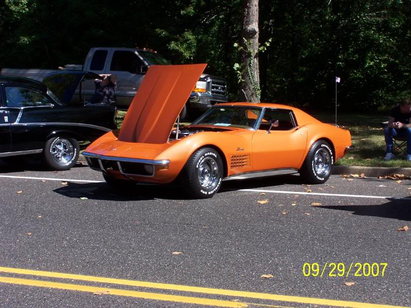

Uh, it was this one here
And I did like you said, I talked to the owner about the car. He only paid 30 grand to have it painted..... I'll be lucky if I can come up with 5!
[sm=icon_cheers.gif]
Wonder what kind of shape it was in before? Here in the KC area for about $10K and no real body damage, you can get a real good two-stage urethane paint job. Maybe he went with lacquer. Nice looking car. It might be the camera or my monitor but the color looks more like mine than the Ontario Orange of that year.

If he paid 30 grand to have that car painted, I would love to do some work on his car for him!!! I had mine media blasted, quite a bit of body work done, and painted for ten grand. Don't see 20 grand of difference between his paint job and mine. I think sometimespeople tend to "overstate"their costs to maybe impress people. Does'nt work for me though. I think if you shop around you'll be surprised at what you might find price wise.

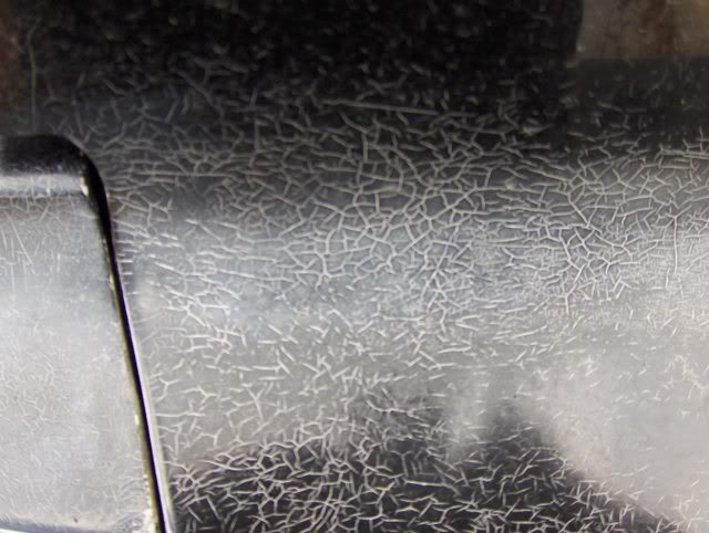

Does your paint look anything like this?
I just call 'em my "Heat Sheilds",to prevent burn up duringre-entry in the "Starship". [sm=shades.gif] (
Yup, it's gotta come off, at least to the factory primer.
How you do it will be your choice. You can sand it down, and wear out your arms, or you can have it blasted. Blasting gives you clean removal and more even surface when you're done. (...and ya can get it all off )
)Yup, it's gotta come off, at least to the factory primer.
