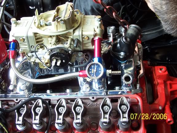

Here is a picture of my Holley Carburetor. You can see the choke valve (closed) on top. The round black thing on the side of the carburetor has the bi-metallic spring inside of it. Mine is an electric choke, so it has a wire going to it that runs current through the spring and warms it electrically. Many older Corvettes have a metal rod that connects the choke valve to a spring that is located under a metal cap on the intake manifold. If the Choke spring is old it may be worn out and need to be replaced, or it may just need to be loosened and adjusted from a summer to a winter setting. Once the choke is properly adjusted, cold starting will be much easier. Carbureted cars are a lot more finicky than fuel injected computer controlled cars when it comes to cold starting.
