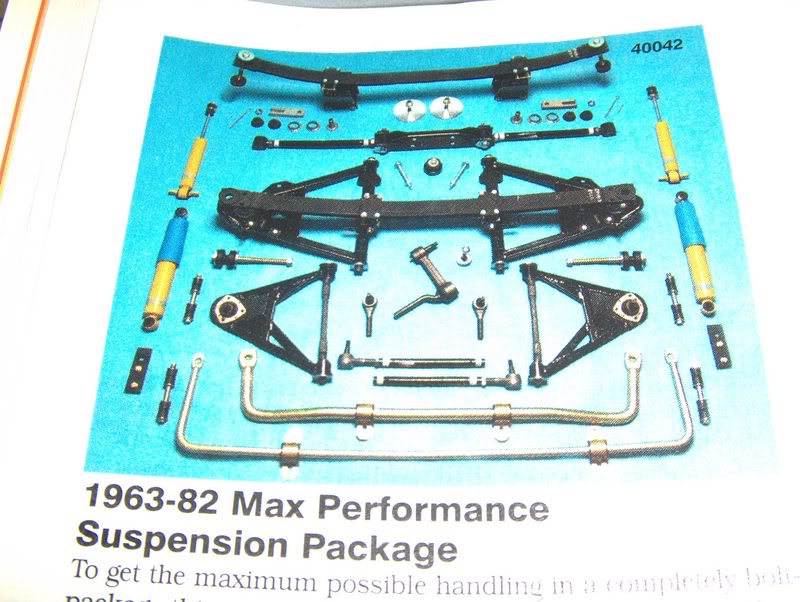

How much difference would the mono leaf make and thanks for your guys' responses, i appreciate all the info i can get
Old Nov 3, 2008 | 06:12 PM
Default RE: Upper Control Arm, Need some help
I have the Mono composite front and rear.I can adjust ride height and spring responce on each corner.
Check with Vette Brakes or Ecklers. They both sell the suspension system that I have. Vette Brakes actually developed the system that they and Ecklers sell.
Here is the system,..
The 'Starship', handles like she's painted on the road. Flat and fast as he!! in the twisties.

Awesome man. Thanks so much for the info. I am really learning a lot on here, what a great place to find answers

BTW, I dropped in a BB to replace a worn SB, and the suspension holds the extra weight just fine.
I'm not tryin' to sell ya on my choice, it just seems to work for me. There are a lot of options out there. [sm=smiley20.gif]
Look and ask around.
