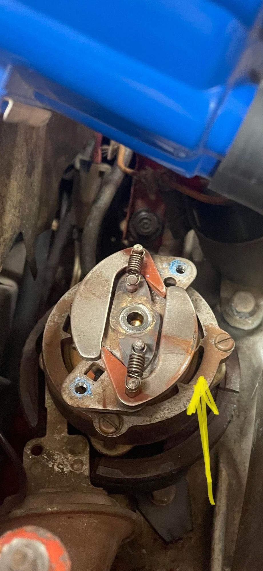

Hi, everyone! I picked up my new (to me) 1969 427/390 a week ago. Looking inside the distributor, I see a ring that seems to block access to the points for their inspection or removal. I haven't worked on a V8 for several years, and I don't recall seeing this part before. I'm sure one of you will be more knowledgeable. Is it some kind of shield that's simply removed for access by those screws I see? I've attached a photo with an arrow pointing to it. Thanks in advance for any advice!

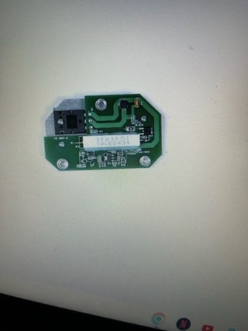

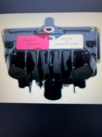

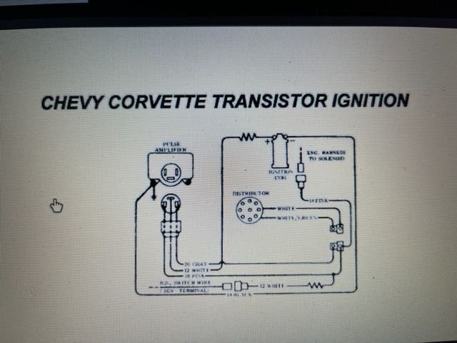

Welcome trhs to the forums. Have not seen that type of ignition in awhile, that is one of GM's first high performance transistor ignitions, used on high performance cars. From 1966 to early 70's before they came out with the newer style hei type distributors. Most of the gm cars had point distributors, yours was considered high performance, you won't find a set of points in there just the coil pole piece. like the hei's this old style was larger than the hei's, Thanks for using a picture that helps your explanation a lot. I installed one of those units in the early 70's from a corvette not sure which one,on my 70 350 roadster worked great, I will post pictures that might help, a very simple unit, I can't say exactly where the transistor amp unit is mounted, up by the radiator left side maybe for cooling reasons, should be easy to see.

Looking around I see you can find all the parts needed to rebuild or repair that system, that's nice but they are slightly pricey. If you found a 69 in good condition that's a really good find, it appears the distributor looks untouched, that's good. Brother had a 427 L88 in a 68 roadster fun car on the street. I found more pictures. Lots of C-3 owners and fans on this site, always open for questions.

Welcome to the forum. The C2s with transistor ignitions had the amplifier module on the driver's side next to the radiator.
