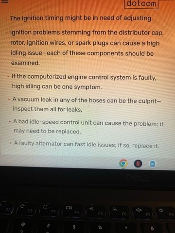

Posts: 978
Well it sounds like you are gaining, that good. I found some other ideas you can look at.
