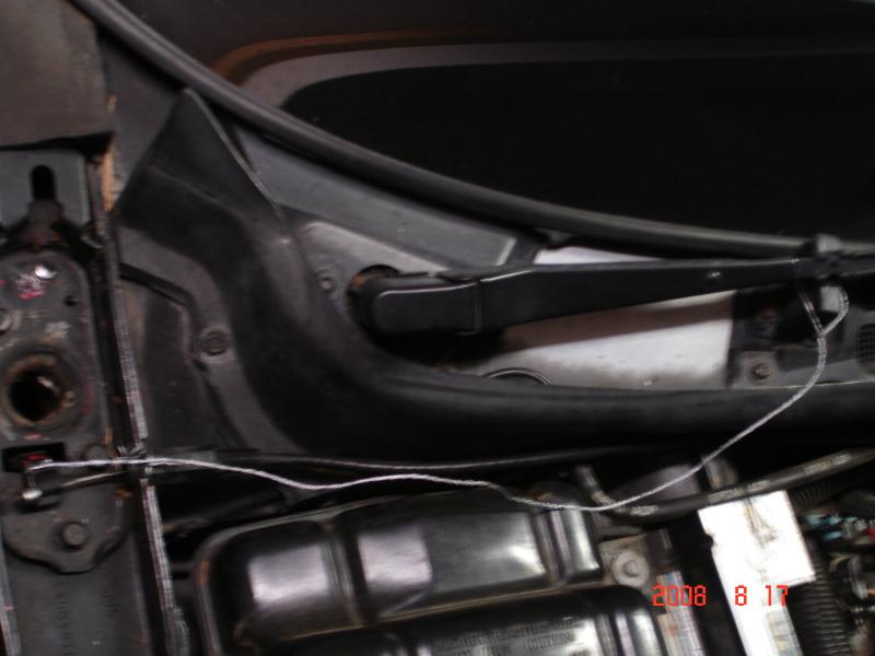

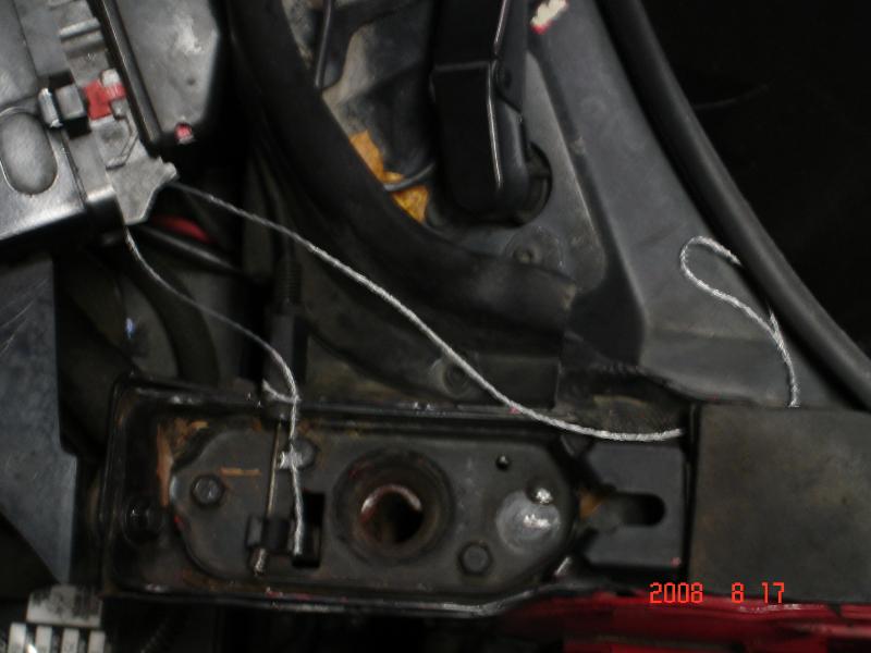

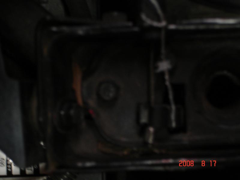

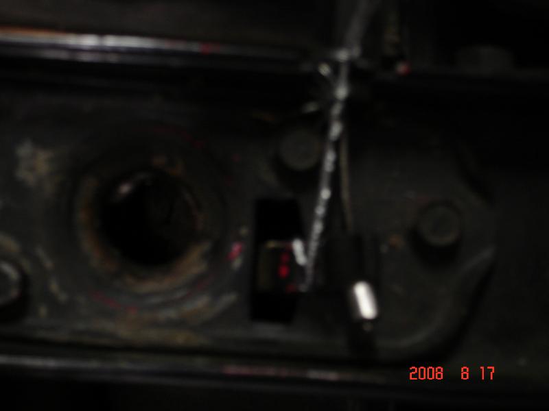

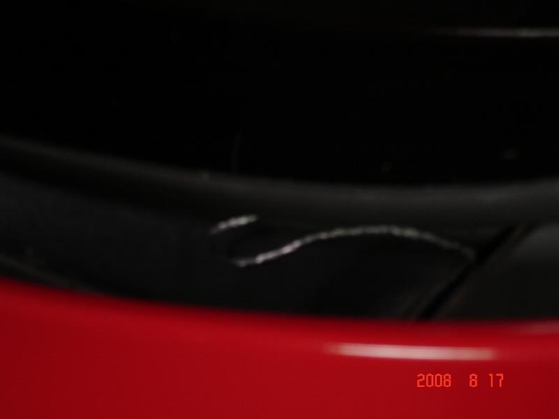

Screw the tool in the future and mount you some wires to each cable release under the hood. Then if the in car release fails all you have to do is pull on each of your emergency release cables and you can get that hood open in about 30 seconds. These pictures are large and of poor quality but I think you get the idea. BTW, with the hood closed you cannot see these cables unless you look at just a certain angle between the windshield and the hood. No one will know they are there:
