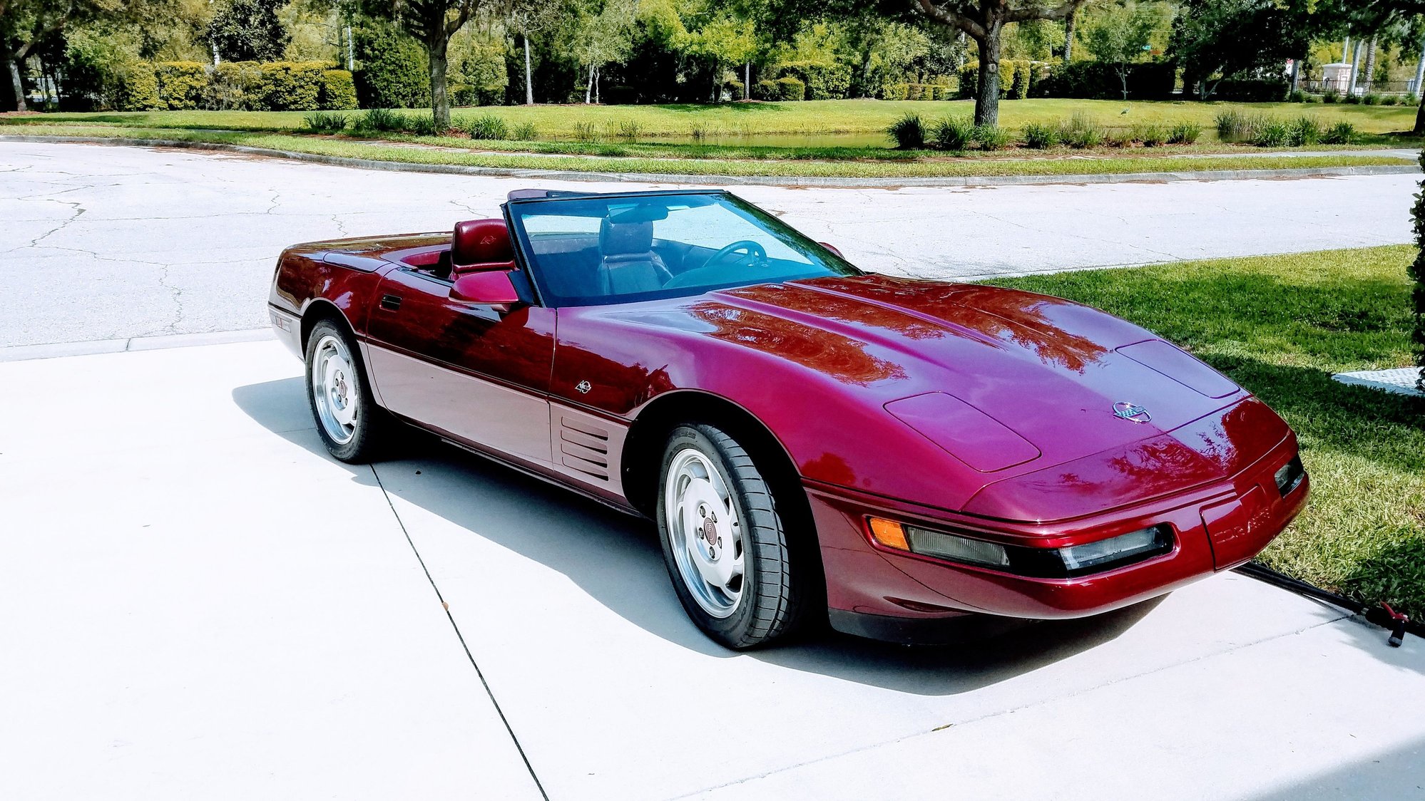

Can you feel the vibration mostly in the steering wheel or is it general body shake?
espy1949, very sweet ride; love the color. Is it MN6 or auto?

It is auto. You do feel it in the steering wheel, but the whole vehicle shakes. I went for a ride again this week and it dld it after driving over 40 miles. Got off the interstate and got back on and it had stopped. That is what makes it so hard to analyze. Had someone say I should check motor mounts. Any info you may suggest would be appreciated. I have put it on a lift but all the u joints seem tight. Thanks for your response .
