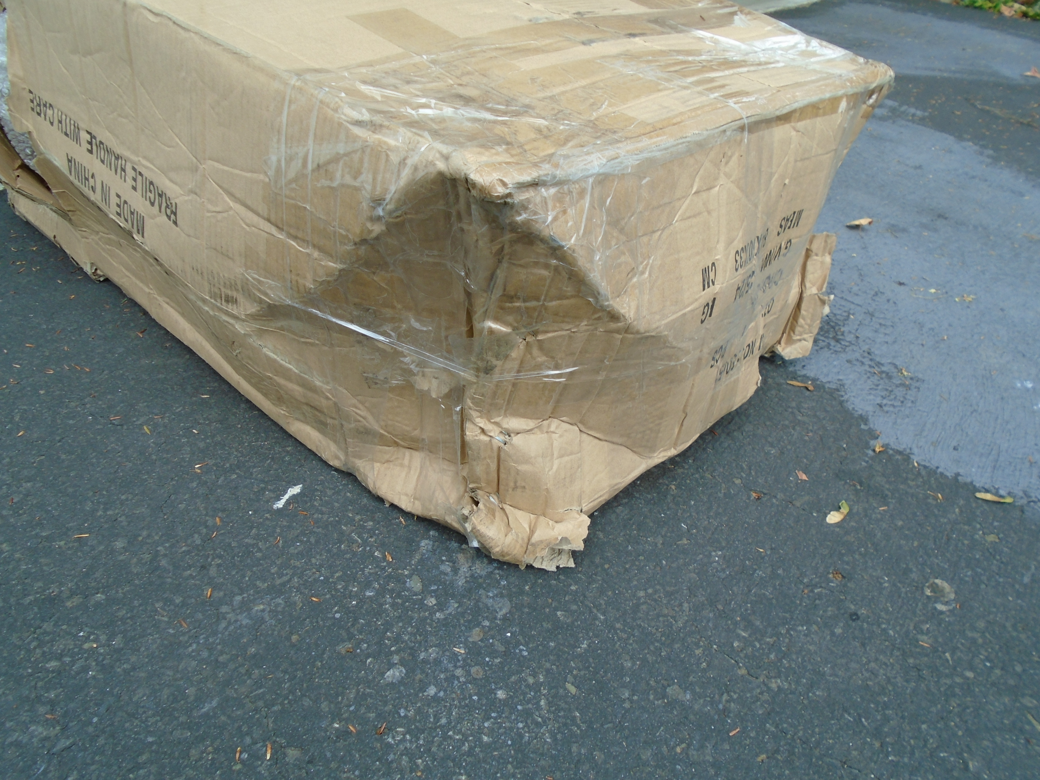

Default The box barely made it!!
The trip from California to Connecticut really took a toll on the box and contents. see the five attachments.

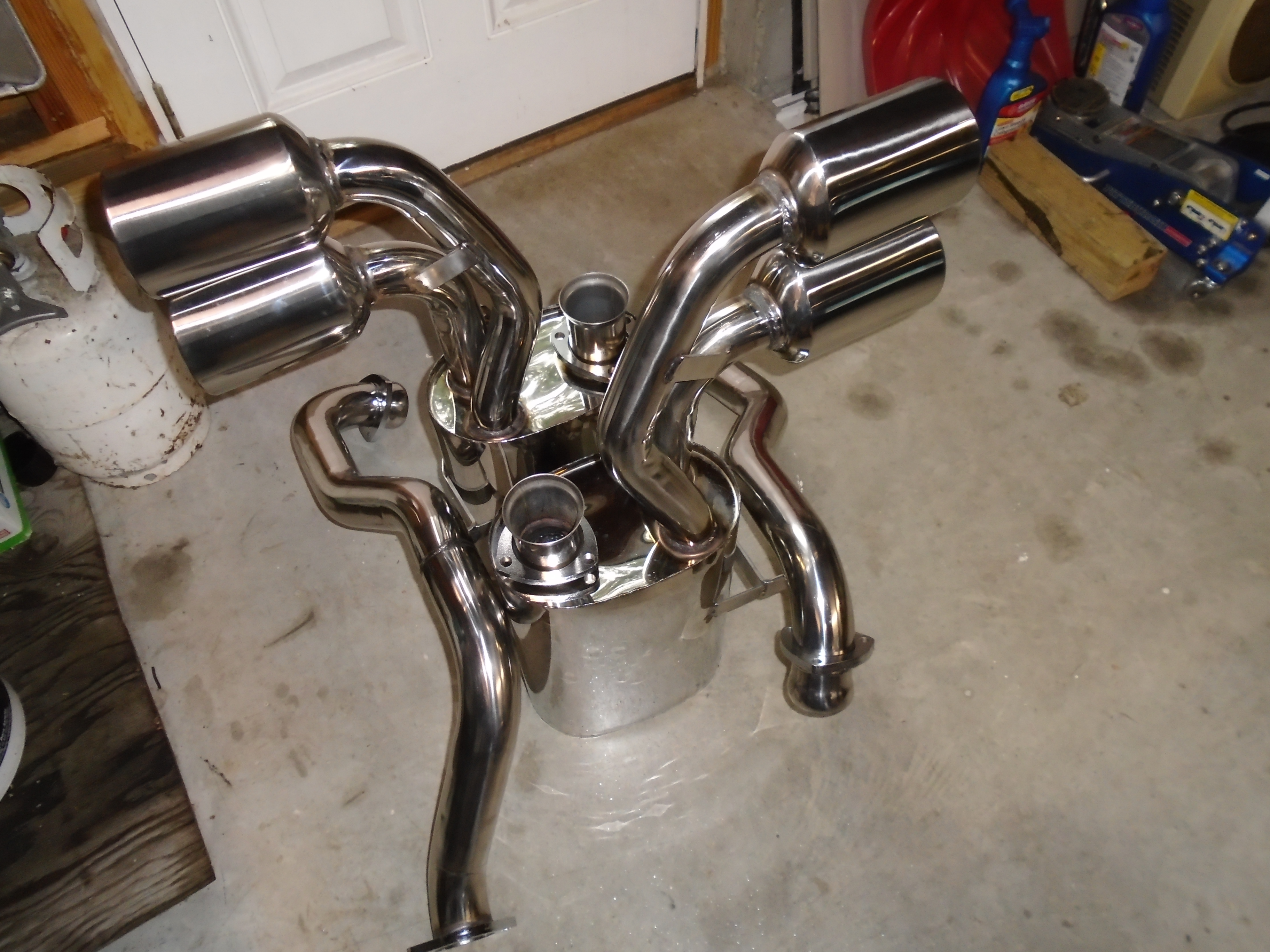

Default Not that bad afterall!

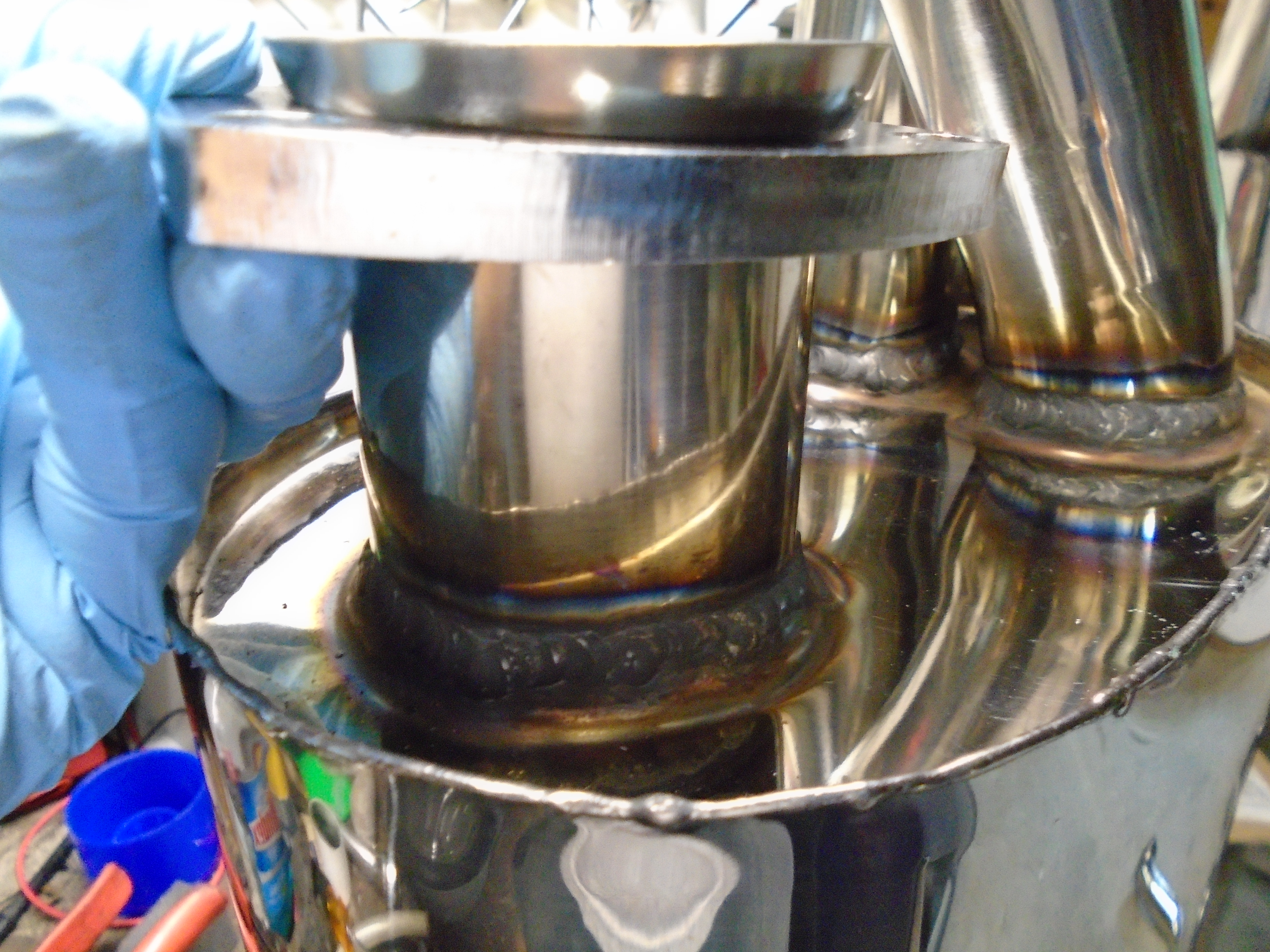

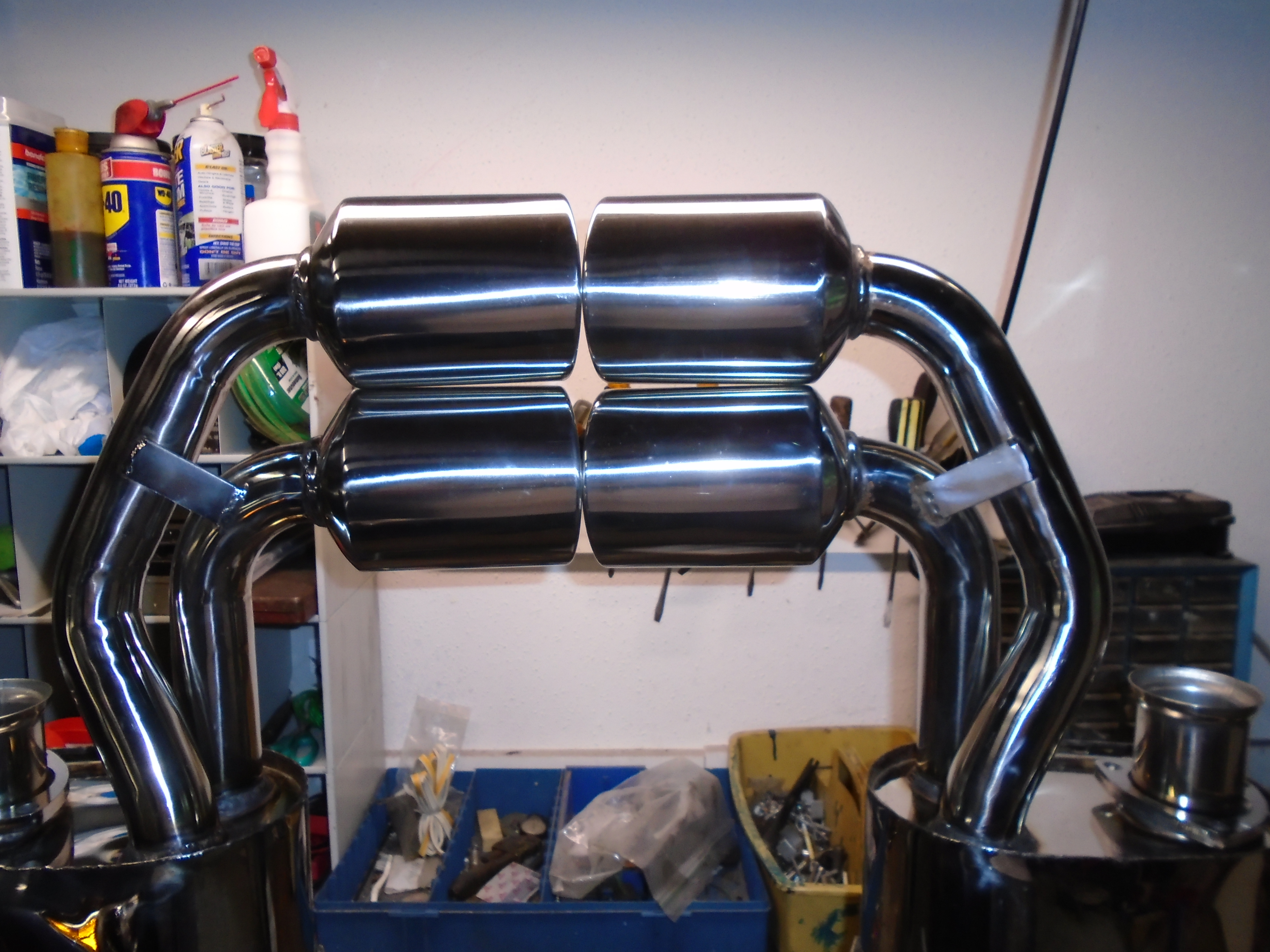

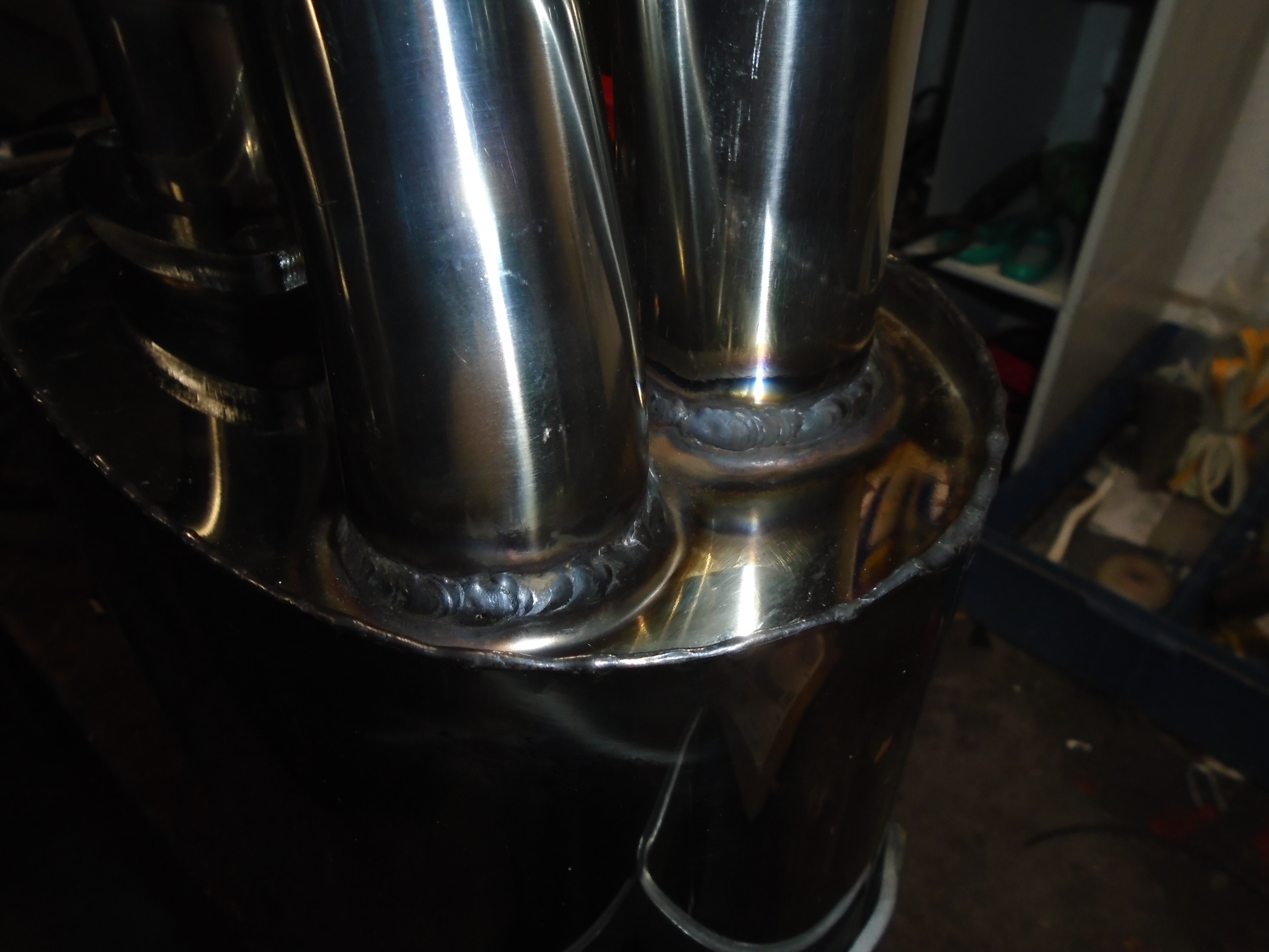

The components of the system were not as bad as the box looked. The stainless was highly polished, flanges are thick, the welds are allok as well.
Attached Thumbnails At 1/3 the price, are they any good???-dsc00305.jpg   At 1/3 the price, are they any good???-dsc00297.jpg   At 1/3 the price, are they any good???-dsc00313.jpg   At 1/3 the price, are they any good???-dsc00312.jpg   At 1/3 the price, are they any good???-dsc00299.jpg

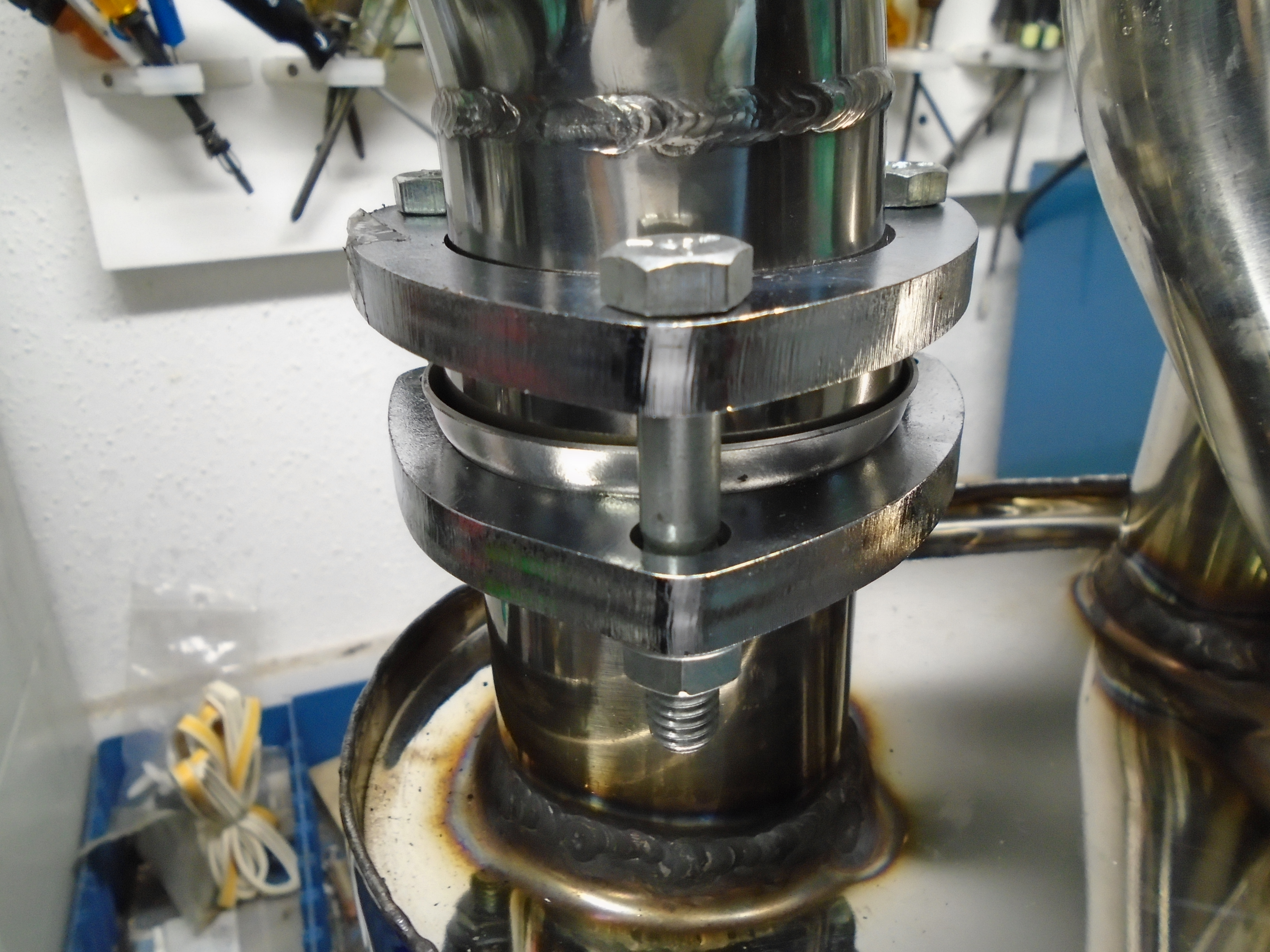

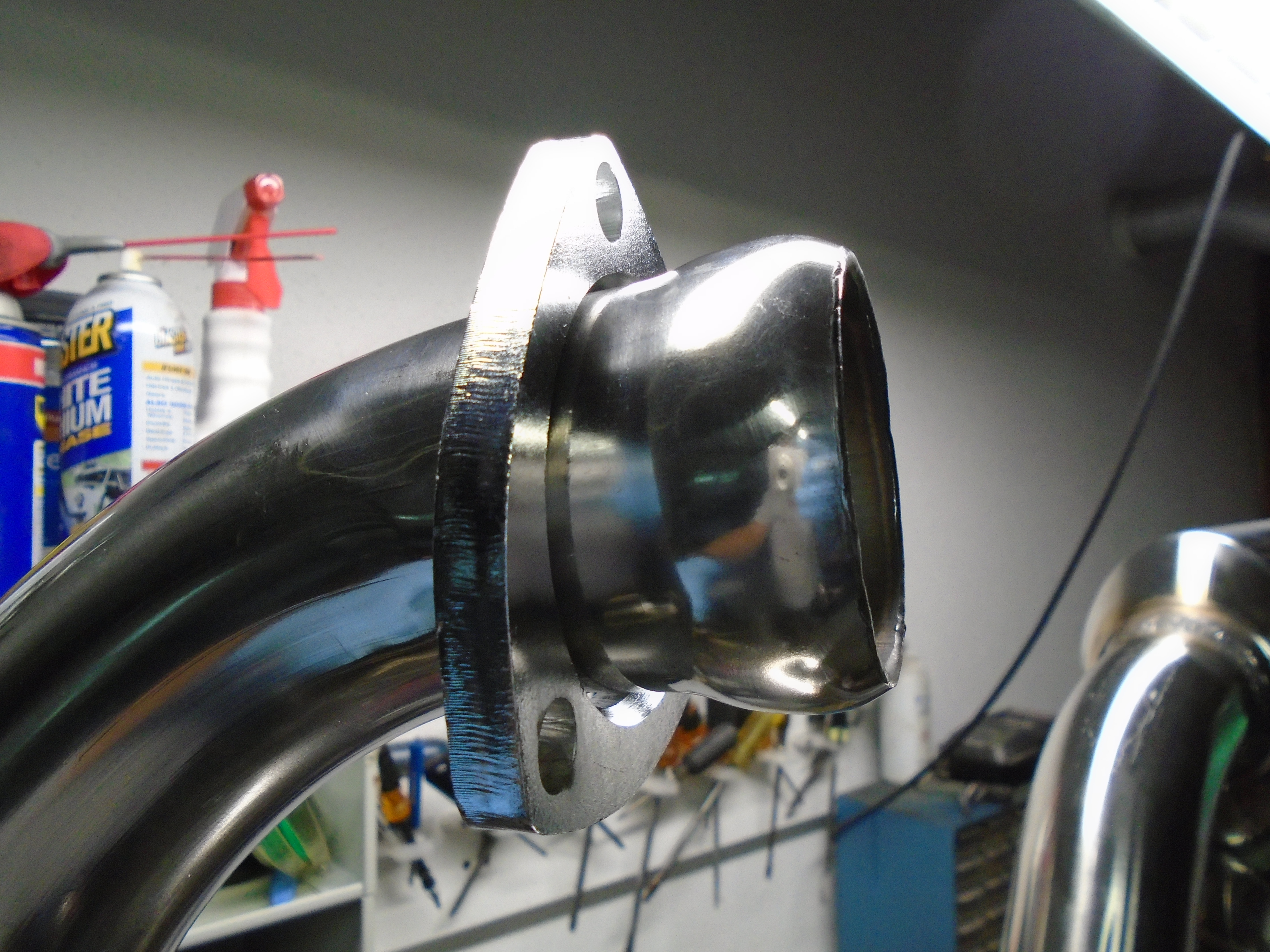

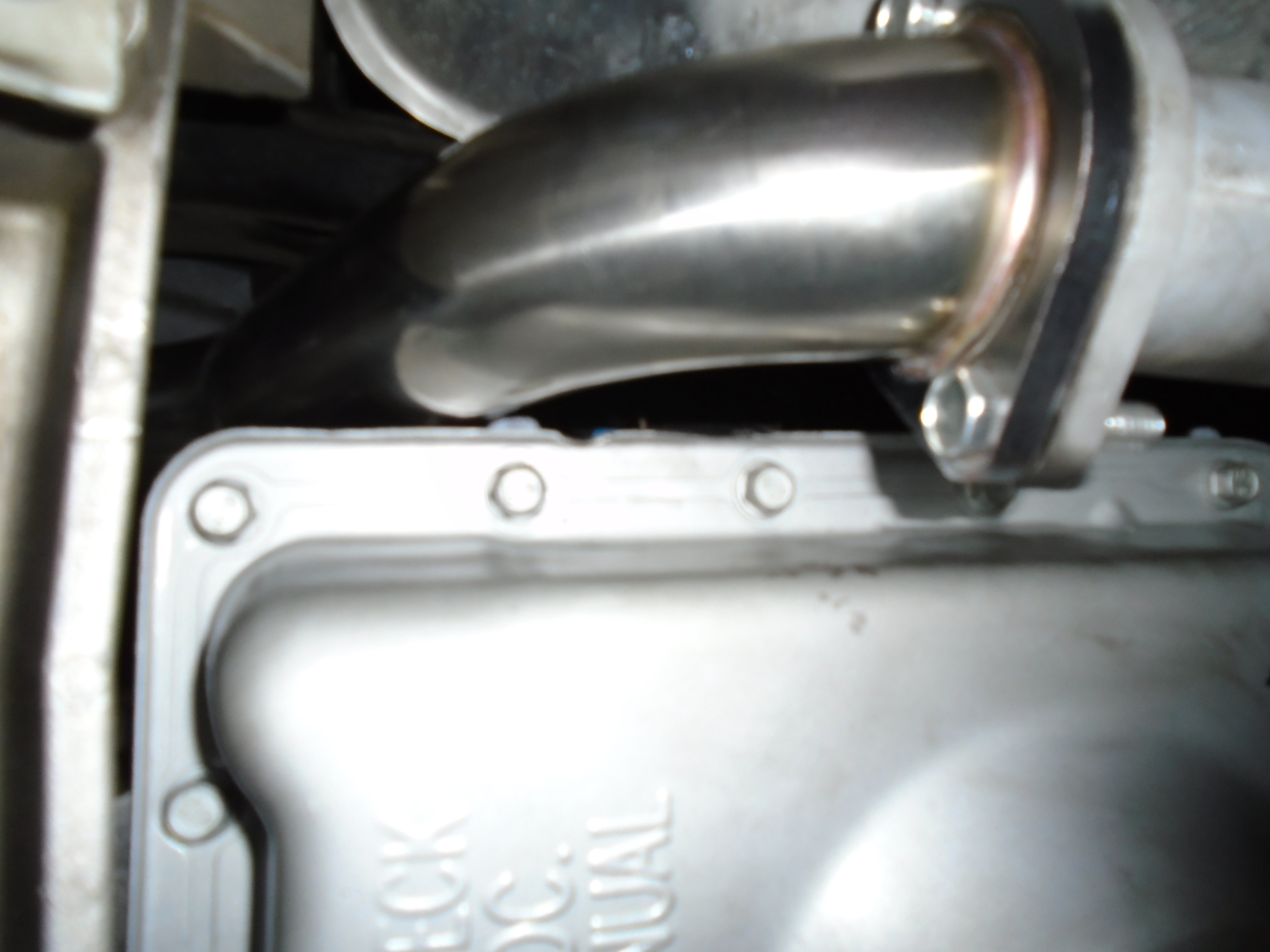

Default Some not so good problems!

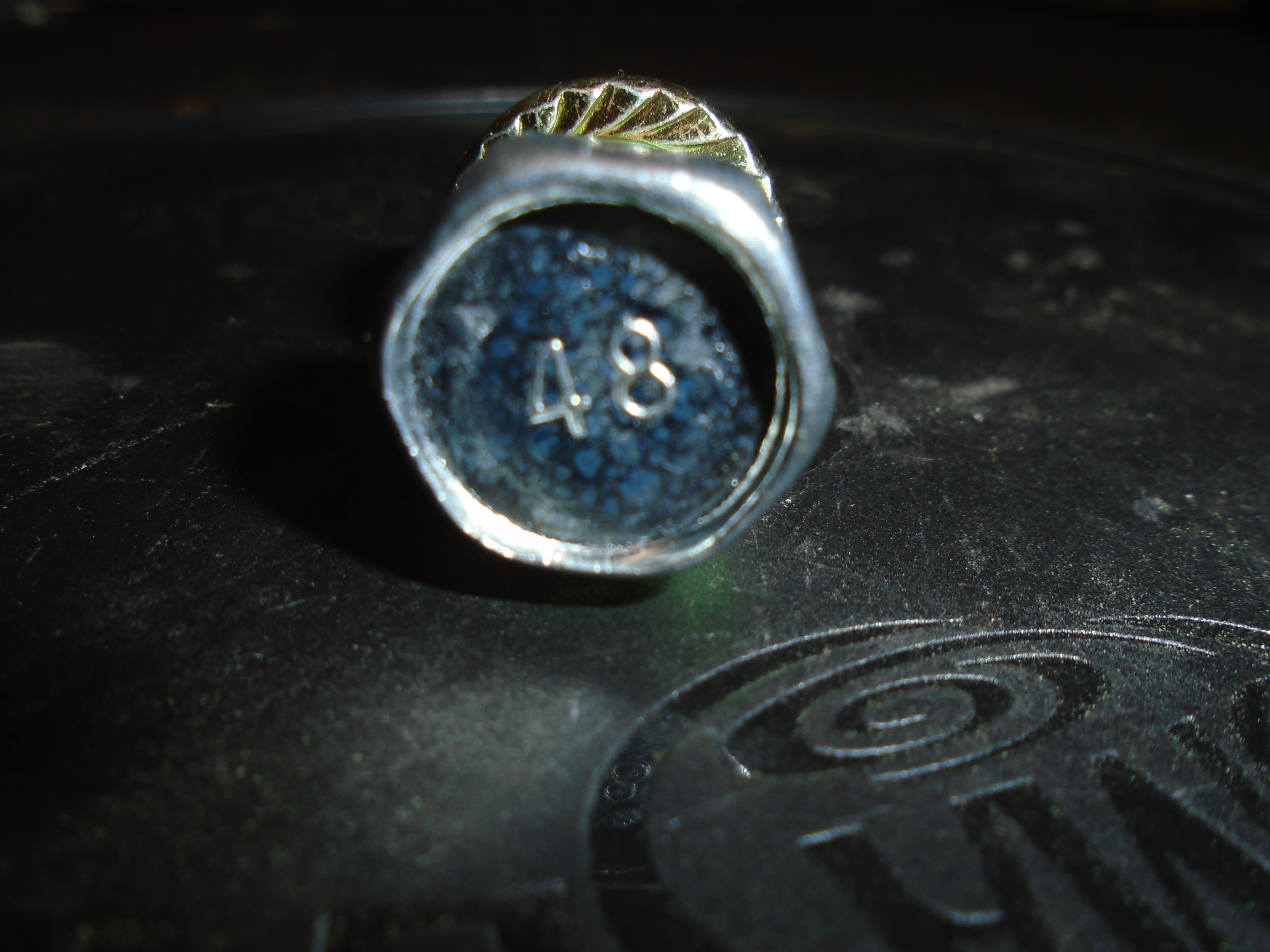

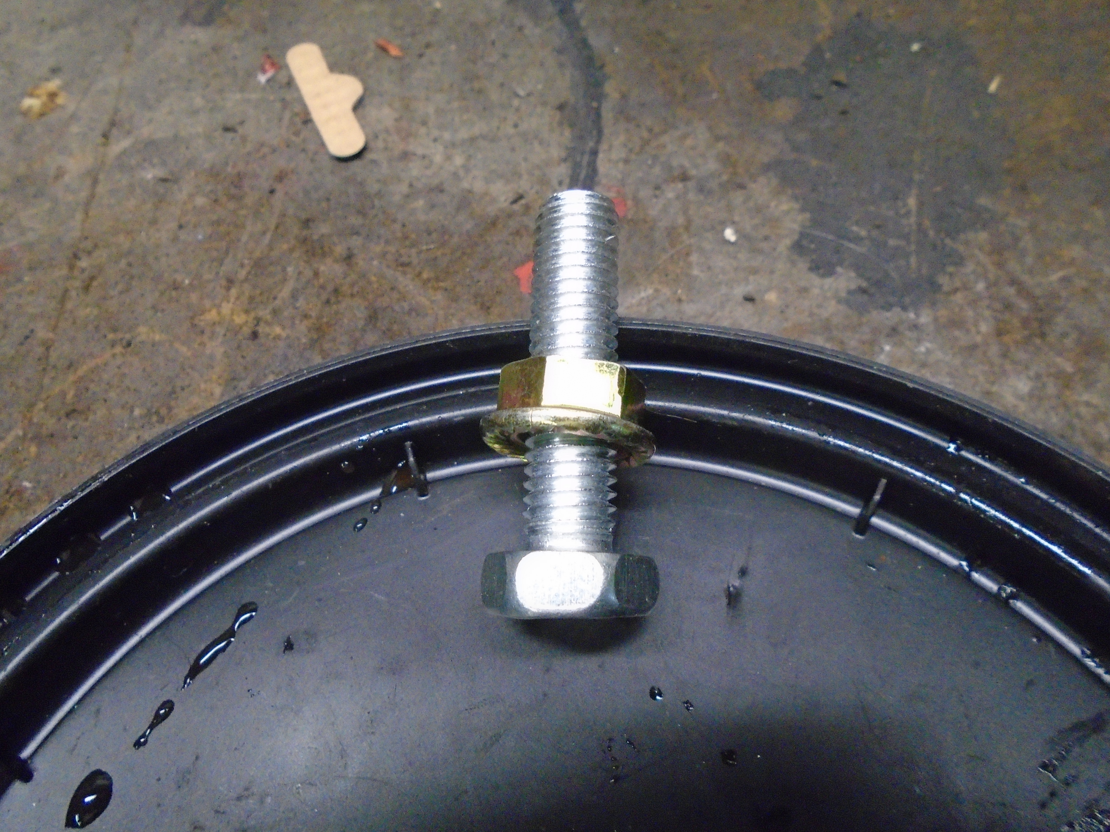

The hardware is junk, throw it away. Th corvette exhaust flange bolts are fine if not rusted. You will need 6 3/8 -16 grade five bolts 2 1/4 long with locknuts. They weren't supplied for the bell mouth connections. To get the mufflers out of the car it must be way up in the rear or on a lift.
Attached Thumbnails At 1/3 the price, are they any good???-dsc00314.jpg   At 1/3 the price, are they any good???-dsc00318.jpg   At 1/3 the price, are they any good???-dsc00322.jpg   At 1/3 the price, are they any good???-dsc00335.jpg
Old Sep 14, 2017 | 01:41 PM
DangerousDan's Avatar
Joined: Jul 2017
Posts: 9

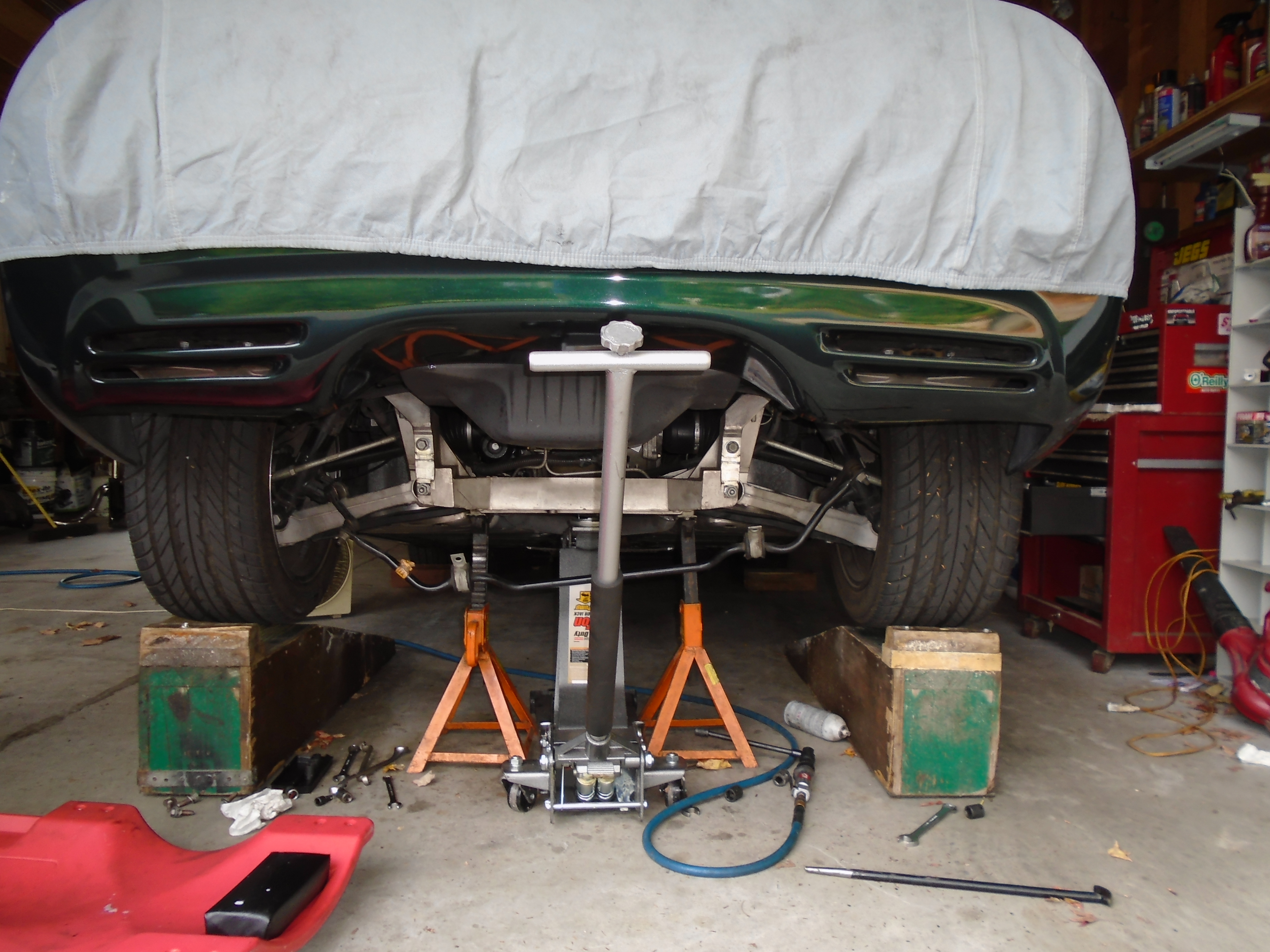

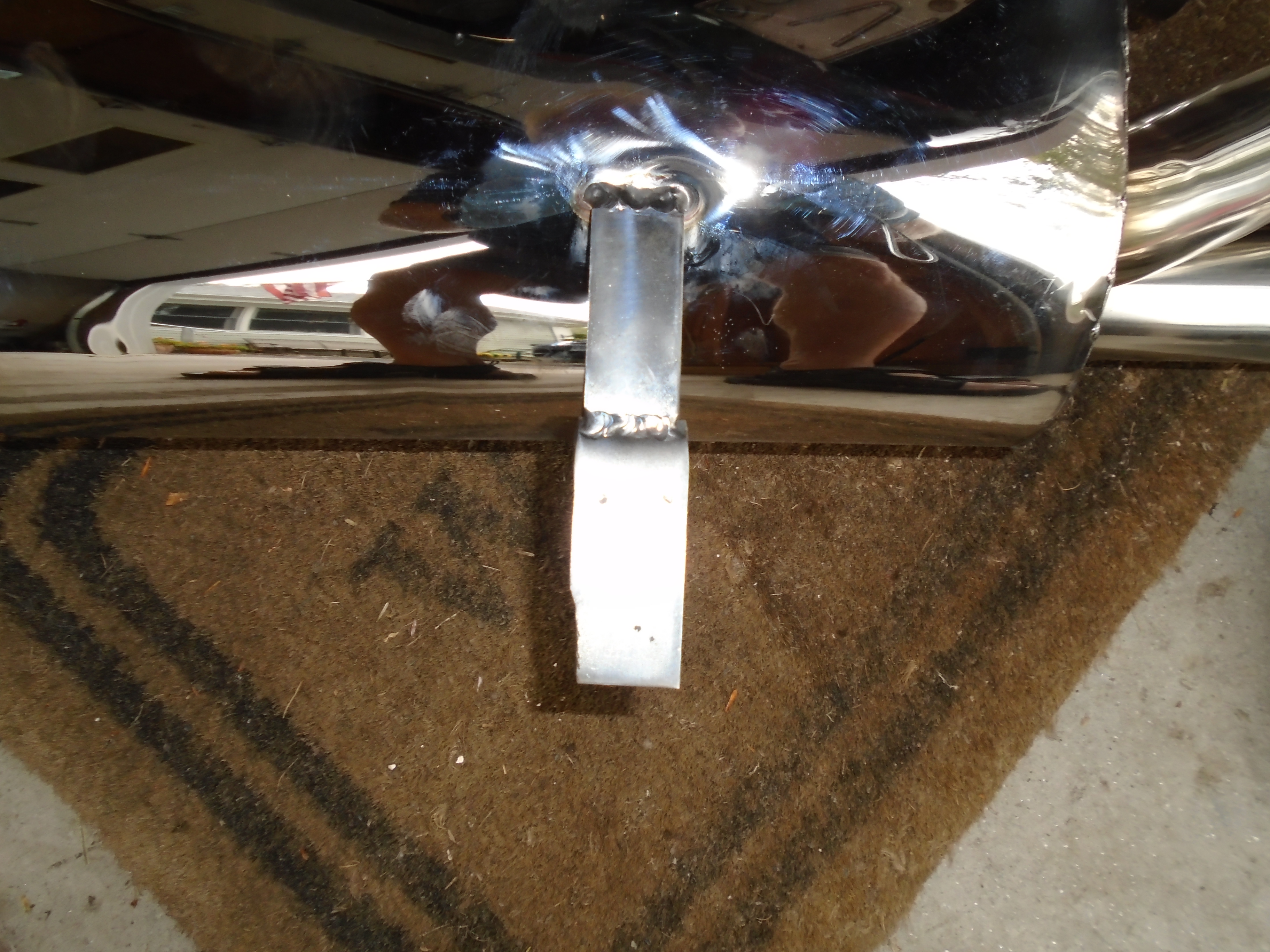

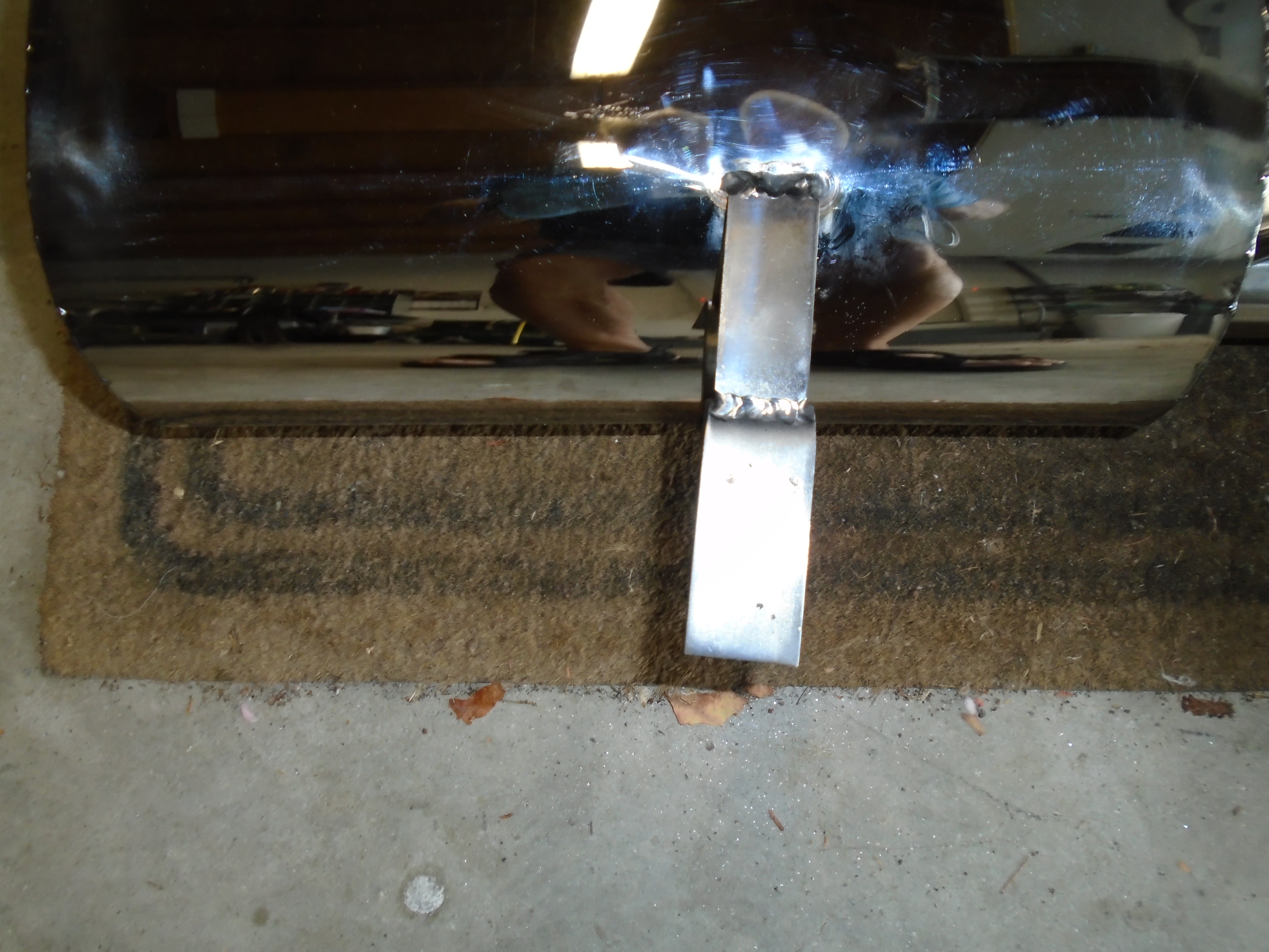

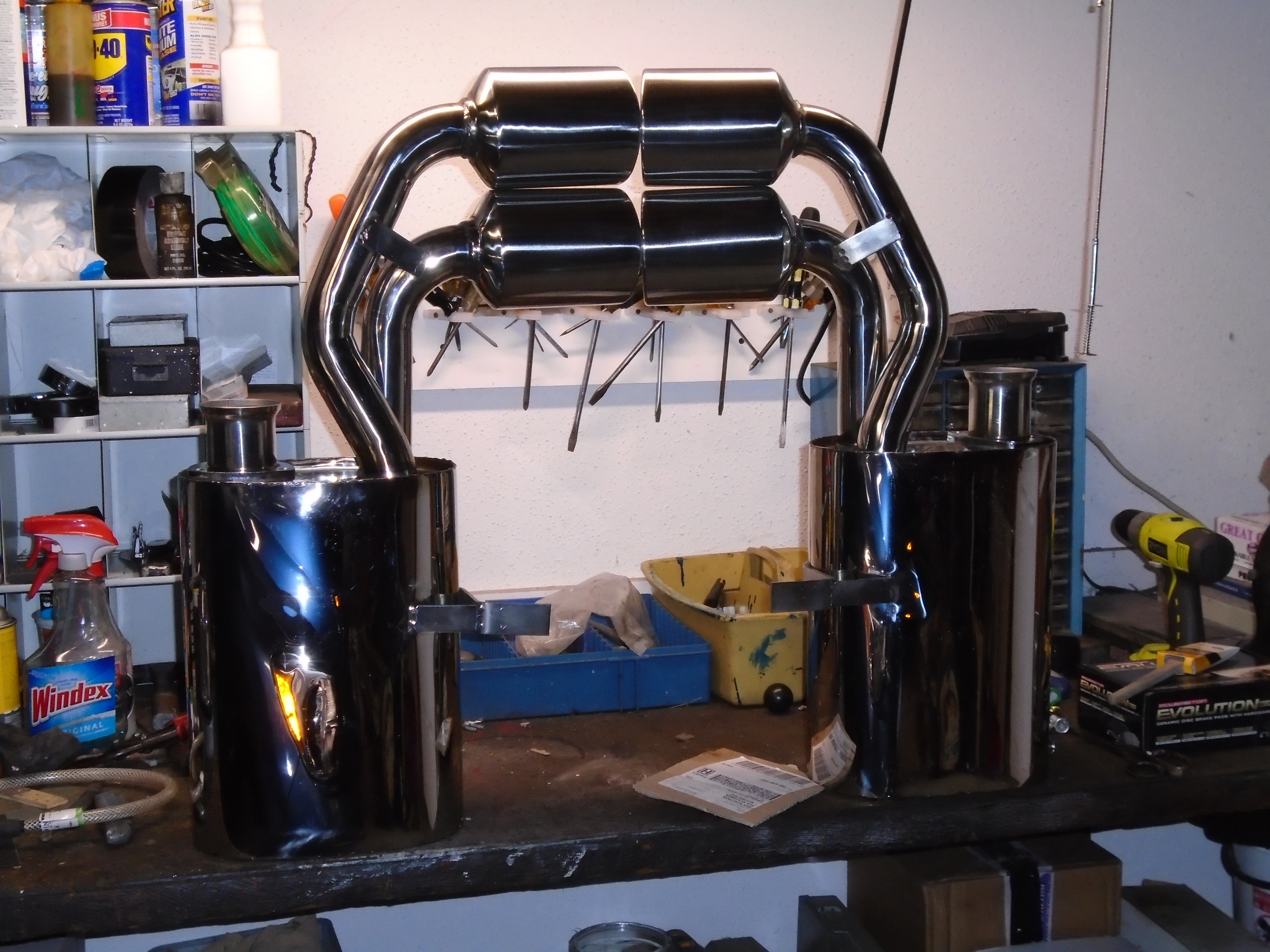

Default Trying to make it fit!!
I started with the drivers side exhaust pipe, that's very easy with lots of room. The left muffler was next and a big problem! The mounting strap was supposed to be mounted 90 degrees to the muff. See how crooked it was, I straightened it out the best I could. I would have had to grind a hole in the center trunk well to fit the pipe under the car.

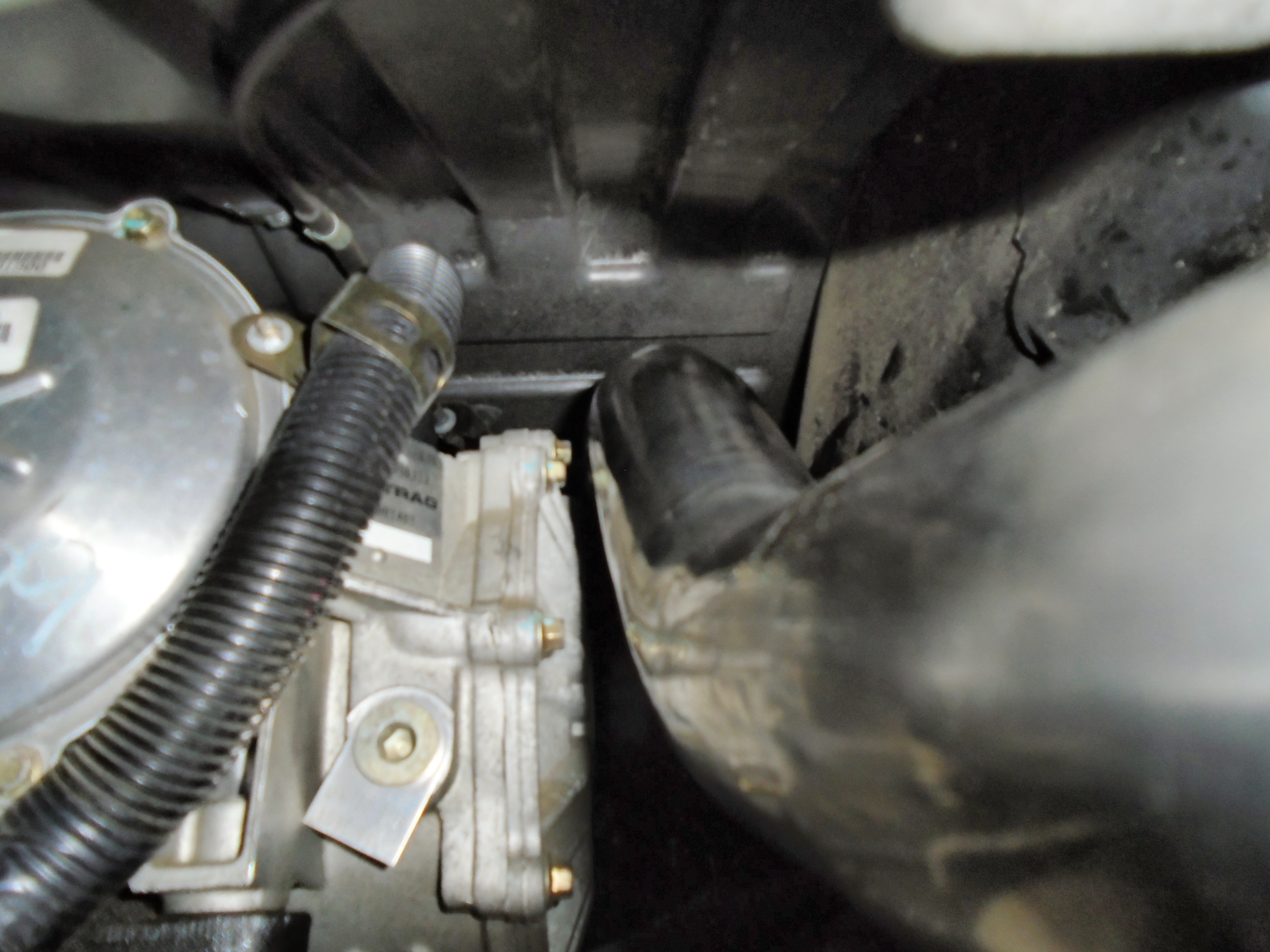

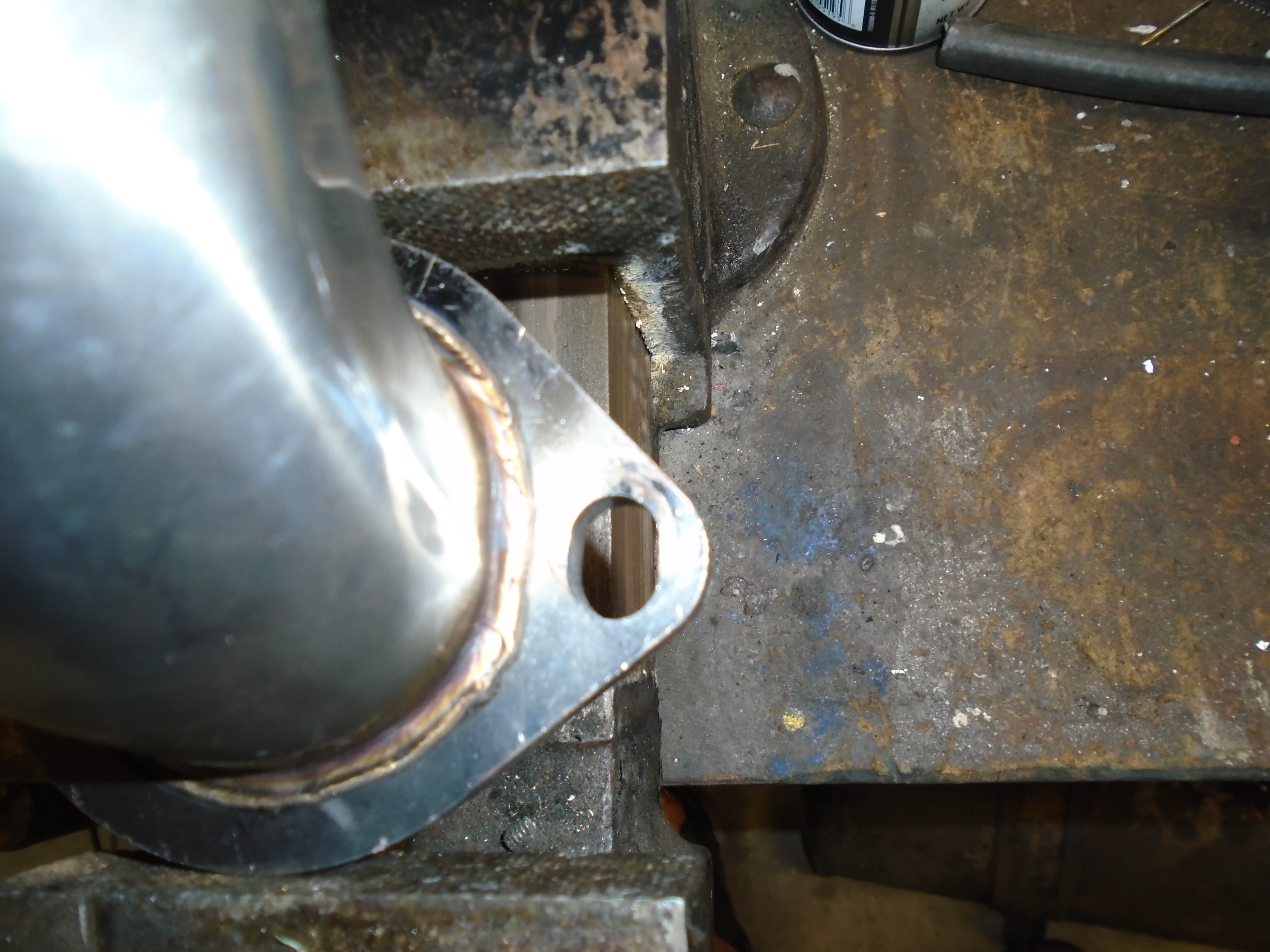

The passengers side was very tight on the heavy flange on the right pipe and the pipe itself. It wasn't clearing the transmission or the rear differential. I had to elongate the slots in the flange some more to rotate the pipe away from the obstructions.
Attached Thumbnails At 1/3 the price, are they any good???-dsc00336.jpg   At 1/3 the price, are they any good???-dsc00338.jpg   At 1/3 the price, are they any good???-dsc00344_1.jpg   At 1/3 the price, are they any good???-dsc00345.jpg   At 1/3 the price, are they any good???-dsc00350.jpg

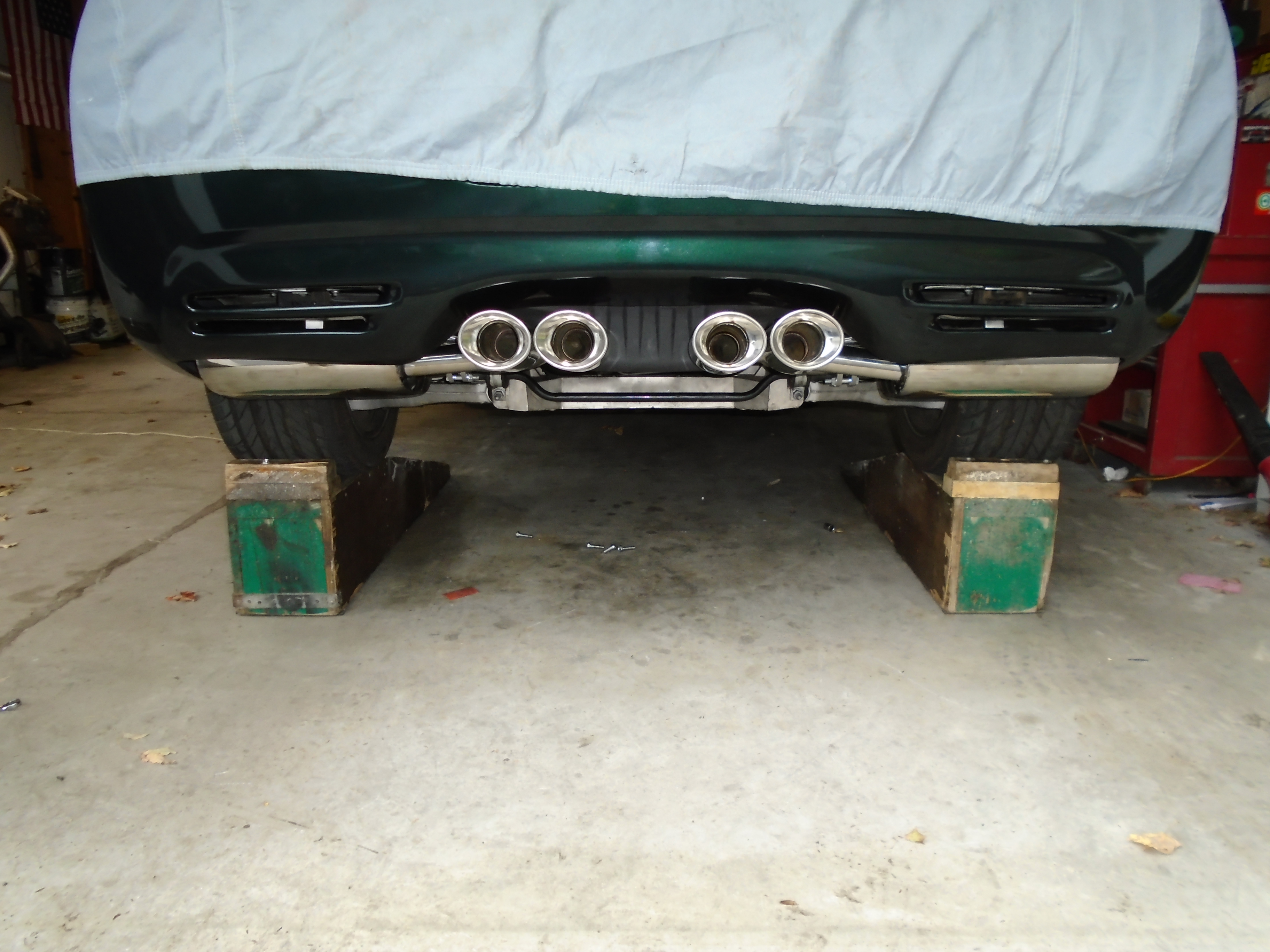

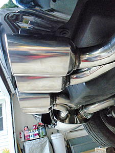

Default All most done!

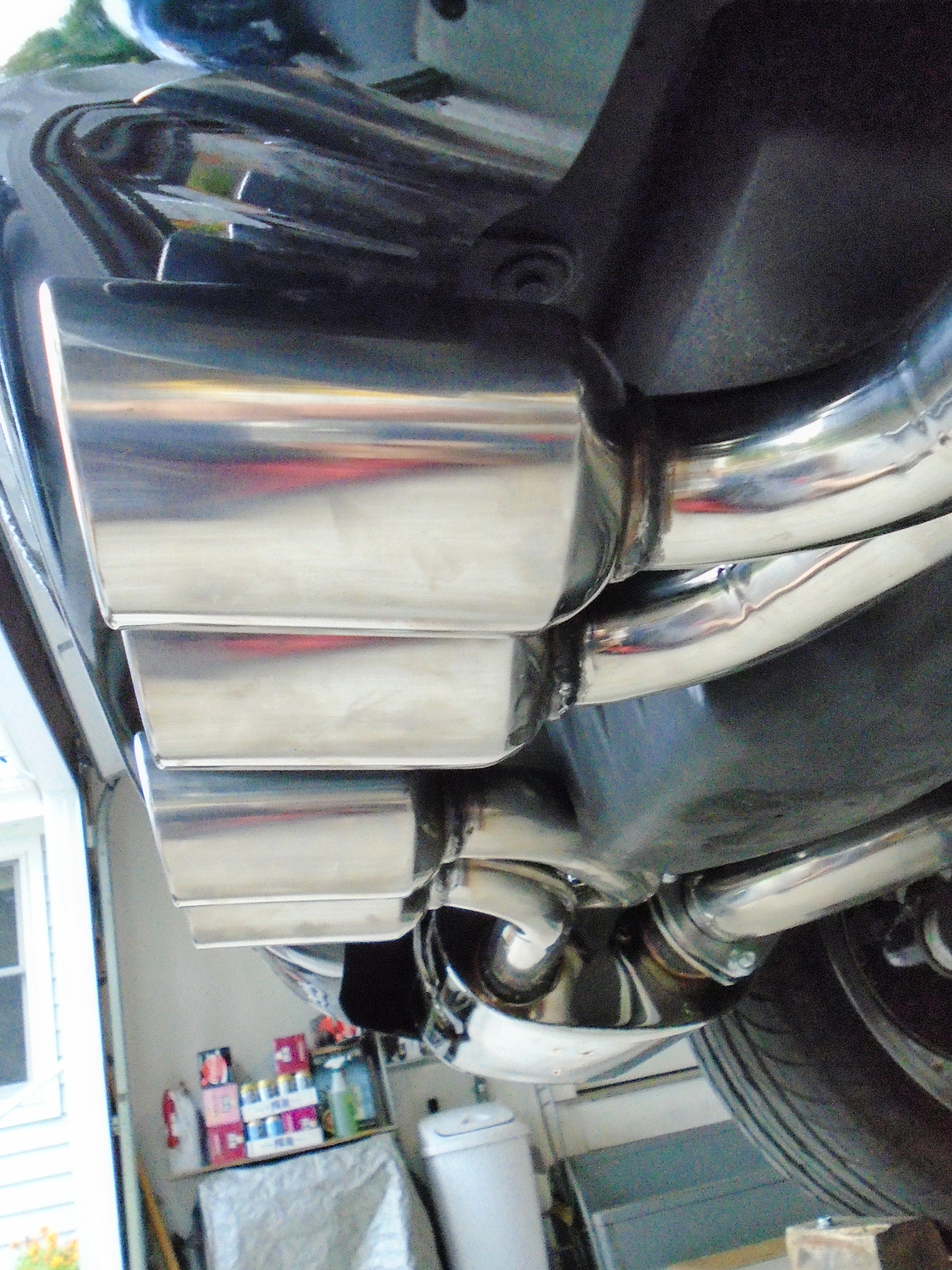

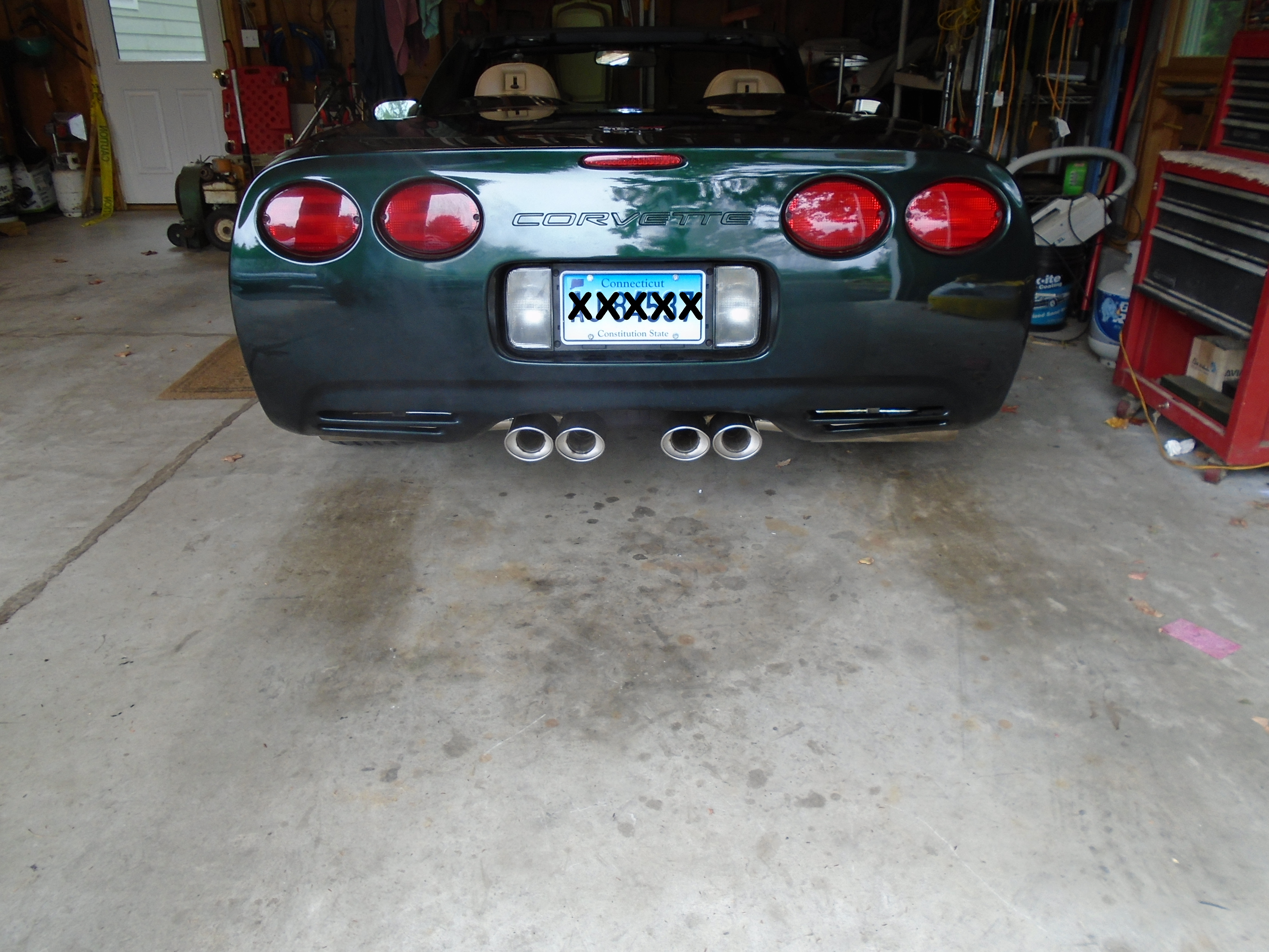

It's a struggle to get the tips all lined up in a row! I got them close enough that they look good. The installed appearance is very nice. the mufflers show under the car and thru the vents in the rear facia. Now for the ride to see how it sounds. If you want to wake the dead go buy something else! This system is only slightly louder than stock. It is a straight thru system with no baffles. Just two perforated pipes attach to the tip pipes surrounded by stainless steel wool. I was surprised that construction is so effective at controlling the noise.

Attached Thumbnails At 1/3 the price, are they any good???-dsc00355.jpg   At 1/3 the price, are they any good???-dsc00359.jpg   At 1/3 the price, are they any good???-dsc00371_1.jpg

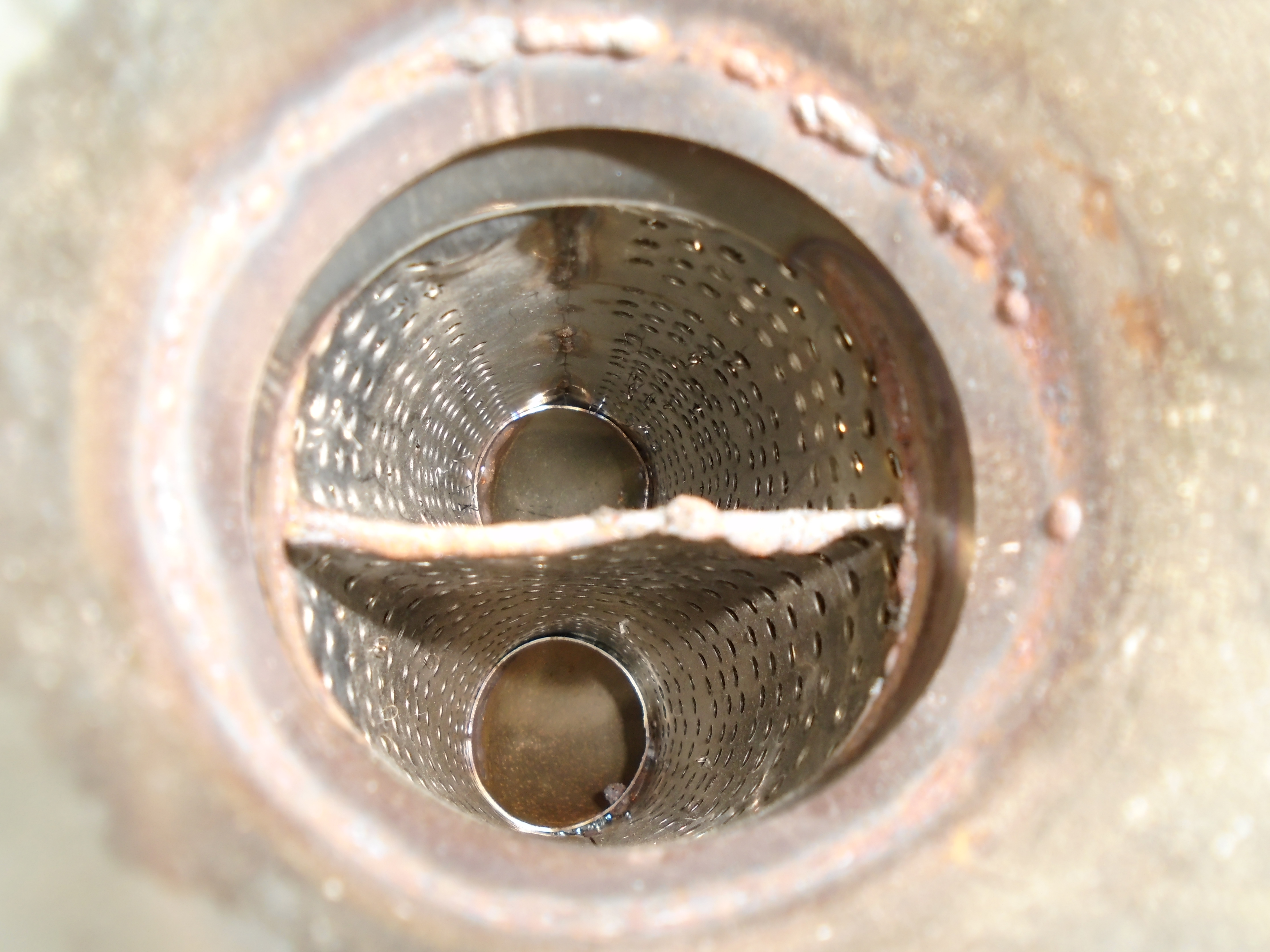

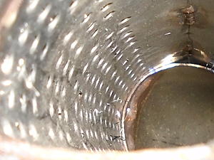

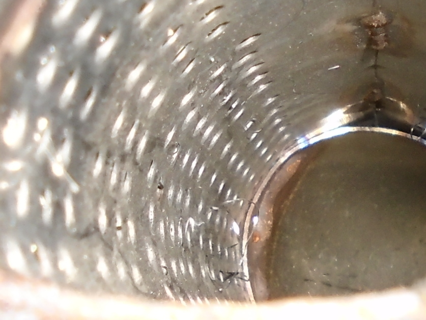

SEE THE CONSTRUCTION OF THE MUFF INTERIOR BELOW:
I hope the stainless packing loses some effectiveness over time. A little louder would be better.
Dangerous Dan
Attached Thumbnails At 1/3 the price, are they any good???-dsc00310.jpg   At 1/3 the price, are they any good???-dsc00310_1.jpg   At 1/3 the price, are they any good???-dsc00310-2.jpg

Default With 1000 miles on the system
The stainless steel wool is moving away from the perforated tubes in the mufflers! The system is beginning to sound like an after market system should.
