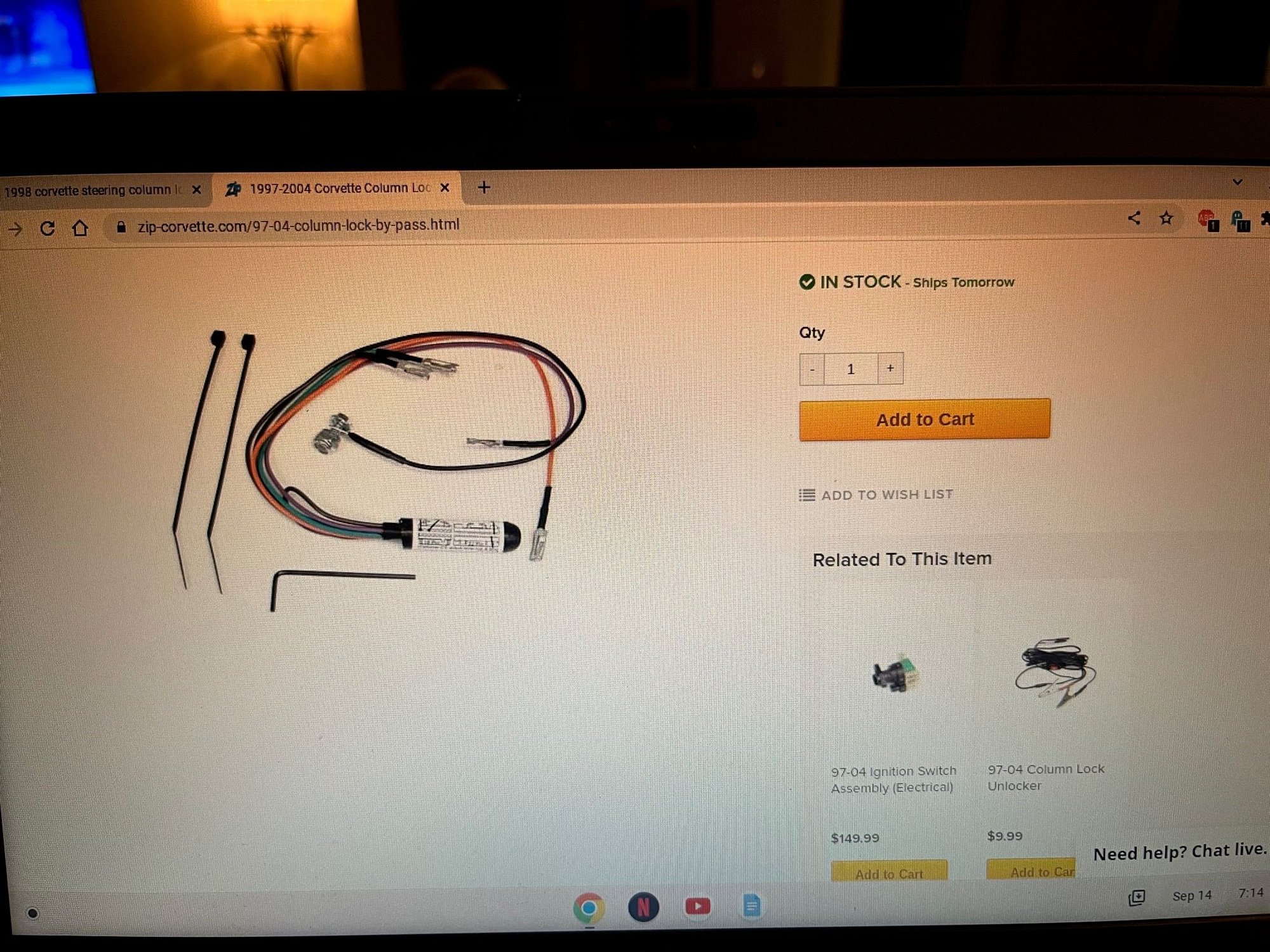

Welcome to the forums. I find it hard to believe the chevy guys wouldn`t look up any service bulletins. not very helpful I would say. Sounds as if there were bulletins. Zip corvette has parts to fix that issue I found I will post there literature..
Old Sep 14, 2022 | 11:08 PM

Sorry I'm not a mechanic but I have read all about the bypass. But my problem as indicated in my question is NOT that the column locks but that the message is displayed. When I actually start the engine the 'lock' message is still displayed but the column is NOT locked and functionality is normal. It is only locked when i turn the key to on and no engine started. Almost seems like a bogus message. Or a message that is telling me it is currently locked. But again when I start the engine - it is not locked. I simply hit the reset bottom and message goes away until the next time I start it up.
