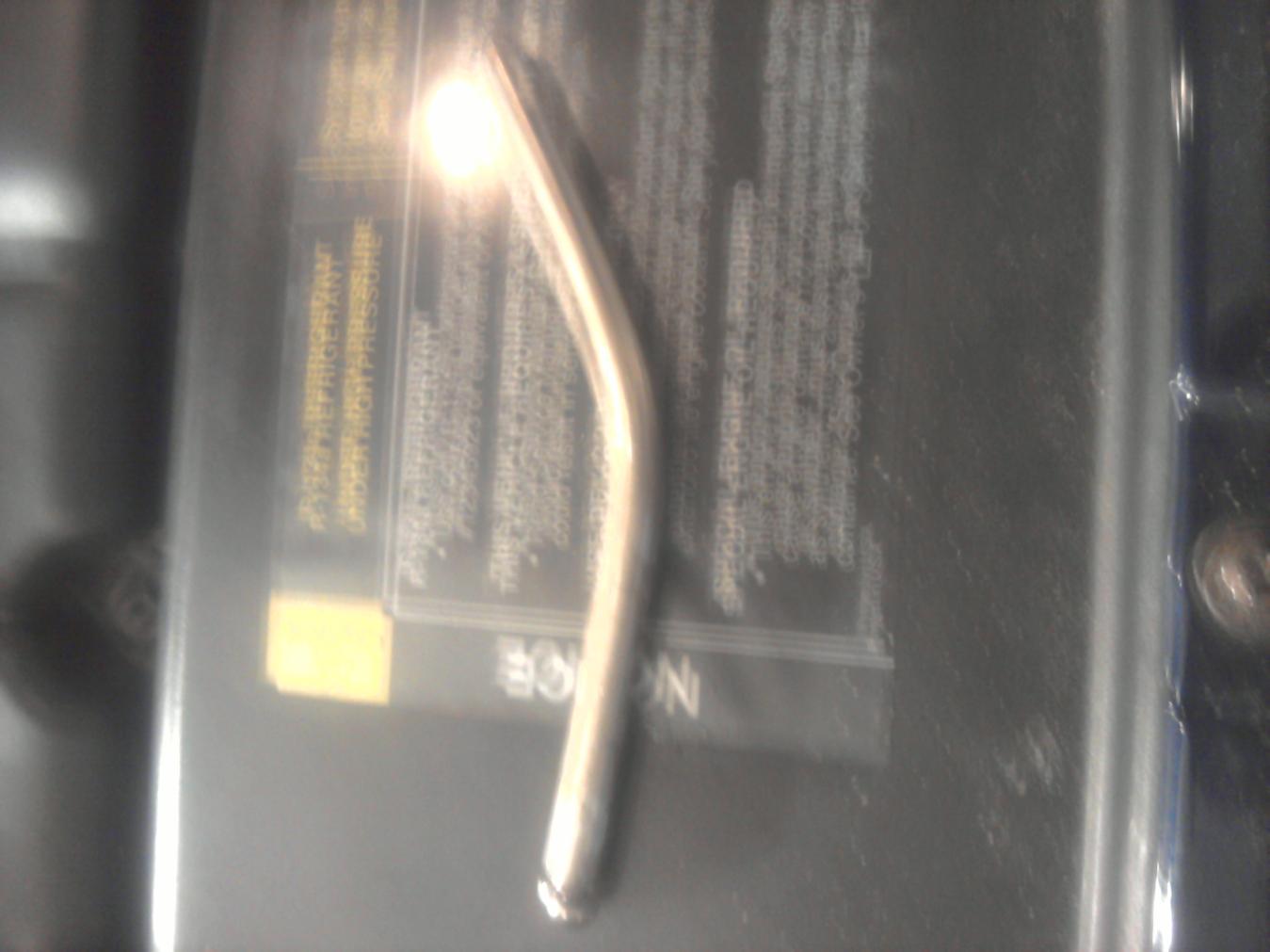

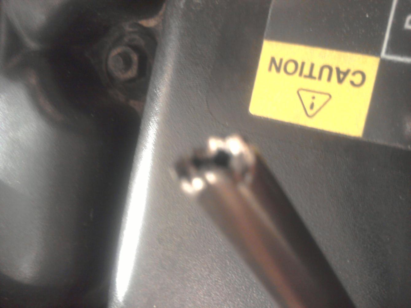

Ok bro's. I suddenly have this sick feeling in my stomach and my wallet! Check out what I found when I removed the valve cover. The rod bend and blew out the hole in the head. the end of the rod was broken off! What are my options now? Do I need a new head? Possible damage to the piston. New motor?

My diagnosis,.....
Lifter got weak, collapsed, the push rod was no longer in tight, got sloppy and broke.
Other possible cause with same result, broken valve spring. Although a broken spring can, more times than not, drop the valve enough to collide with the piston, I seriously doubt that this is the case. I'm 99.99% convinced it's the lifter that caused this.
The head could be just fine, looks like it to me. I'd pull that head and take a look in the cyl. to verify the head, piston, and block condition.
BTW, when you pull the intake manifold to get that head off, look in the valley of the block and really check the cam a lifters over. Look for any damage to the block in this area. If the block is alright, cool, figure on replacing the cam, lifters, and bushings in your rebuild.
I'd sure like to see some more pics as you move along, it would be a big help to those just starting out in doing their own work.

While further inspection I found another rod on number six cylinder doing the same thing to its rod hole. i havent pulled it yet but im suspecting it is bent also because of the way it has distorted the hole its sits in. rocker arm is not loose on that one though. Also I cannot locate the broken end of the push rod anywhere in the upper part of the cylinder head. I assume it is somewhere inside. anyone have an image of the inner cavity. where would the broken piece have ended up? one more thing, in my manual it didnt say anything about draining fluids for cylinder head removal. I think it would be a good idea to check the driver side head as well since im doing all this. all of this should be able to be down without removing the engine right?
Ive read that bent rods are common place on these vettes. any suggestions for a strong replacement rods?

Drain the water and oil. The water so ya don't make a mess, and the oil 'cause it's full of small metal shards from the broken pushrods.
Now go ahead and pull the intake and exhaust manifolds, and then the heads.
Actually, you can almost completely strip the block with it in the car, 'cept for the crank.
I'll wager that the broken piece fell through to the valley between the heads or on down in the oil pan.
