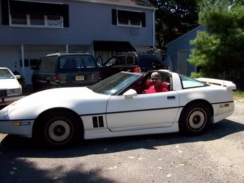

Boy! I'll say you guys have helped!!!!! I agree with building from the bottom --up!! why skip now!!!
when I bought this, I was told that there wasn't much I could do to increase HP, But! after reading through the different post here,
I can feel that itch comeing back[:@] So thanks, this helps, and so you know, it does smoke a little after idleing, but seems to stop after running on the warm side, it needs work in all areas so I'll be busy, And looking forward to doing the work needed. fortunetly my brother is a body mech, and thats a big help with the cost in that area, I'll be doing most of the prep, under his guidence and might even attempt to paint it as well. But, thats pending completetion of all the rest, So, I'll probably be old, broke, and gray before thatName:  TheVette004.jpg
