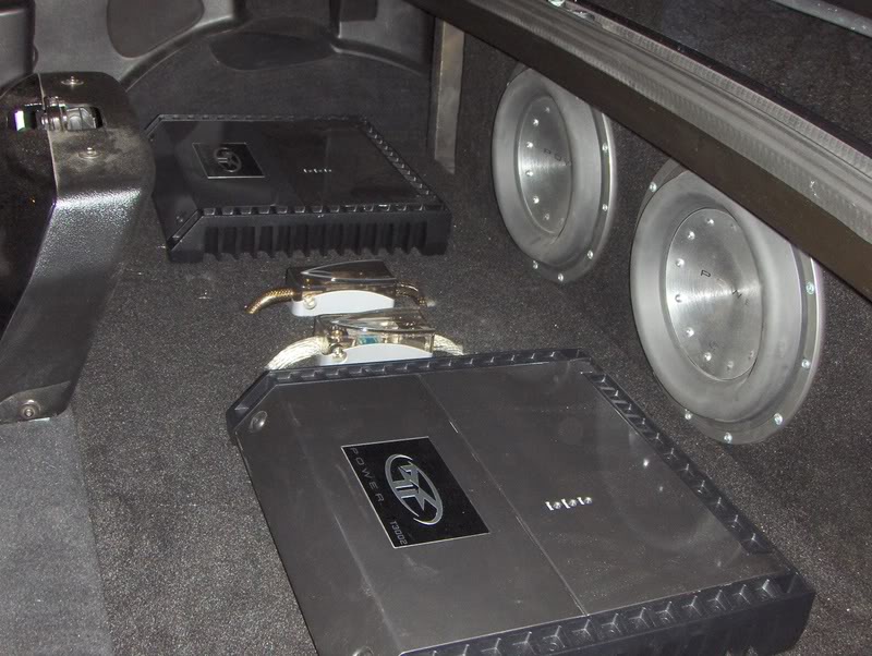

Its funny you asked, Ive got a 99 convertable. And i just spent alot on the audio upgrade around two thousand watts....But when the stereo is turned up the lights dimm and the volts drop down under 12 and all hell breaks loose, Anyway I ordered a High output alternatorfrom a place called Ohio Generator, Over 200 amp and that is supose to do the trick. I have an extra battery, But the only way to go is called the big 3,1) alt. 2)alt. to battery wire 3)alt. ground......The alt is $500 bucks....I will keep you up to date after the install....
You guys with the big sound systems will have to take the advice from the man at the audio store when it comes to watts necessary to drive your speakers. You can do the math when you need to figure out the charging system capability, total watts used with everything running devided by the system voltage = amps, for example- 5000 watts w/sound, lights,A/C, devided by 14.5 volts = 345 amps. You can add up the wattage of each item if known to come up with load your putting on the charging system.
