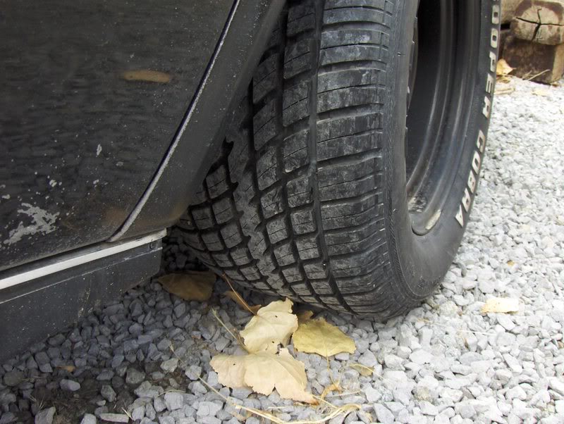

I have the stock 15 x 8 ralley wheels that I got from Ecklers. No clearance probs, and tires are still inside the wheel wells.

These are pretty wide, and look great. Still in the wheel well.
Cooper Cobra Gt Radials,P265/50 R15 Rear, on the 8" ralleys.
I don't have a photo with these wheels and tires on my Vette.
Oh, wait........yes, i do. I'll have to findthem in my files, and will post the pics when I get home after work.

This is the only one I found. [&o]Not very good, I'll go ahead and take some pics and post them in the next couple of days.
A full 10" of rubber on the ground.

C3: I'm curious to know how much clearance you have to the parking cable bracket on the trailing arm.
Old Dec 6, 2007 | 08:23 PM
Default RE: 10" rally wheels
I'll include that in the pics I take. I'll do the whole rearend, suspension and wheel clearance. I have the rear up in the air, so I shouldn't have any probs getting the pics. I'll try to get some measurements too.
