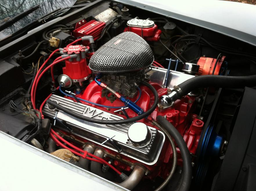

Hello everyone,
I just started driving my 1973 Stingray again after a week of decomish due to a blown water pump and bad alternator. As I tried to get into second gear I could feel and hear a vibration. Seems to be coming from the rear, and my father said the same thing. The previous owner had this car setup for racing, has a shift kit and first gear starts to high rev at 30 and then shifts at 50. 350 cui from a 71 Elco, Carter 4-barrel carb, edlebrock performer RPM intake, MSD 6-plus ignition control, long tubes...pretty sure that the tranny is original to the car (3 speed). Anyway, at highway speeds I can still feel the vibrations. My dad thinks it might be either the U-joints are going bad, or the fluid in the rear end might be low. Tranny fluid is good, and just changed the oil. If anyone can please help, it would be much appreciated.
Thanks.
Attached Thumbnails 1973 Corvette Rear End Problem?-img_0166.jpg   1973 Corvette Rear End Problem?-img_0168.jpg   1973 Corvette Rear End Problem?-img_0163.jpg
