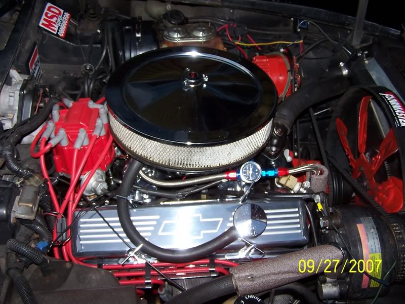

Old Jul 19, 2008 | 09:15 AM
DeeVeeEight's Avatar
Banned
Joined: Oct 2007
Posts: 594
From: South Jersey
Default RE: 1974 Oil Breather set up
Most aftermarket air cleaner bases have a hole pre-stamped in the metal for the oil vent hose. All you have to do is punch it out and hook up the 90* adapter that usually comes supplied with the air cleaner.
