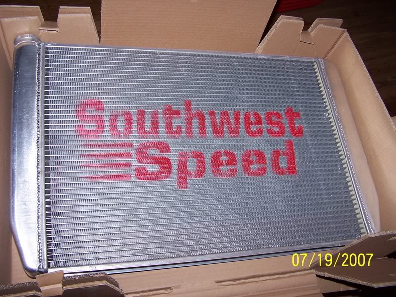

Remember this picture? This is a universal fit 19" x 31" aluminum radiator, $160.00 online plus $20.00 shipping. The only modifications needed were a stainless steel flex hose for the bottom hose and a little grinding to the top left radiator hold down bracket. Other that that it just slipped right in!

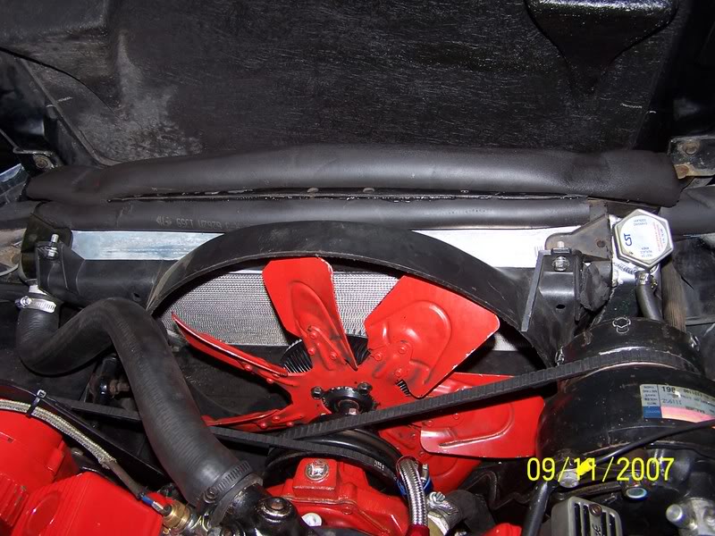

Here's the finished installation, stock shroud, fan and all. Stays real cool too!

$920.00 ????
WOW !!!!
I'll add a nice 2650 CFM electric fan with electric fan controller to the southwest unit for another 175.00 - that is still only a fraction of the 900 ++
Hmmm..... 350 vs. 920
both aluminum, both with electric fans....
hmmmm.....
