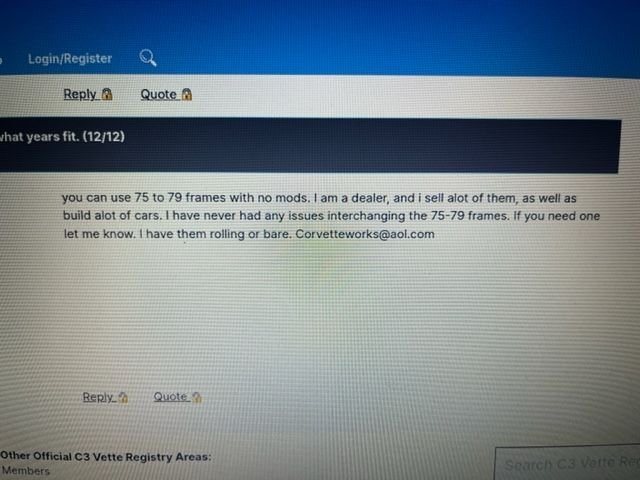

MarkV, I`m not an expert on frames, but have worked on many. I think you have the option of using the frame you have and swap transmissions, if the original frame is good. I did find an article on frames, I will post it.

I've been told I can't put an automatic transmission in a manual transmission frame because the crossmembers are different. Don't know if it's true though.
Thanks for the picture. I've seen it. I hope it's correct.
