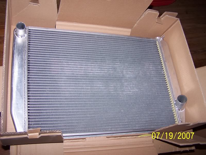

If you are looking to save some coin, check out the universal fit radiators from Griffin. They cost about half of what the DeWitts units do. All I had to do was a little grinding to the top left radiator hold down bracket to make it "just right" and install one of those fancy stainless steel flex pipes as a lower radiator hose. I saved a few hundred and had the satisfaction of having done it myself!
I wound up finding my 2 row aluminum radiator (19" x 27" if I remember right) on ebay from southwest speed for about $165.00, that'sless than what I paid for a copper/brass radiator!

Here's a nice link for ya Bro' ! Check out the PRICES!!!!! The 19" x 29" is what I got for mine!
http://www.southwestspeed.com/?sec=v...t&id=18491
Here's what they have to say about the measurements.
[*]*HEIGHT & WIDTH DIMENSIONS ARE WHAT THE RADIATOR WILL SLIP IN, ACTUAL DIMENSIONS OF THE RADIATOR ARE ABOUT AN 1/8" SMALLER

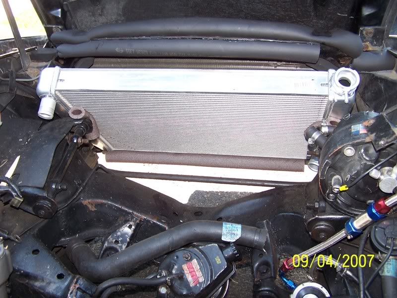

My universal unit went in real easy and the stock fan shroud went right back in too. I used a few pieces of pipe insulation as cushions to check the fit.

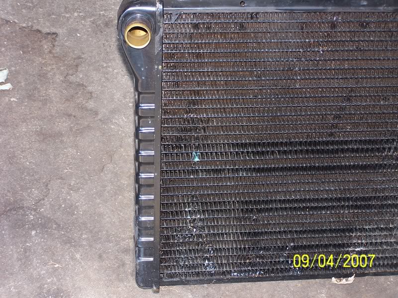

The original radiator has this skinny lower left tank and the universal one doesn't

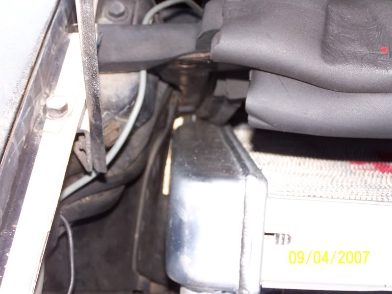

The fit on the left side was a little close so I simply shifted the radiator to the right about 1/2"
The completed installation, stock fan shroud and all.
