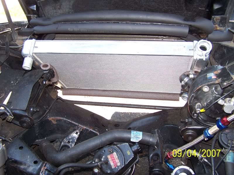

Here's the straight scoop on engine cooling as I have learned it (the HARD way!).
Aluminum radiators cool better than copper & brass units. They have better water and air flow characteristics and shed the heat better.
Electric fans are more desireable than engine driven fans where horsepower is concerned. Electric fans place less parasitic drag on the engine and this gives you more horsepower.
Engine driven fans are not subject to burning out or other electrical problems and are considered more reliable - as long as your fan belt doesn't break. For this reason some people prefer engine driven fans.
Your theory about power loss (degradation) from the alternator converting mechanical energy to electrical energy is correct but not fully applicable when factoring horsepower gain/loss.
The race car drivers remove their engine driven fans in favor of electrical ones for weight savings and horsepower gains. The show and go guys like to put in electric fans for the WOW! factor. I used to have an electric fan and adjustable thermostat set up in addition to my engine driven fan but after I put in the aluminum radiator I ended up removing the electrical components.
If you guys haven't guessed by now, I SWEAR by my aluminum radiator. I knocked my brains out (and my wallet too) trying to correct my cooling issues. The universal fit aluminum radiator was the best money I ever threw at the problem.
The only other thing that needs to be stressed about cooling our C3's is air flow. C3's are bottom breathers, meaning that they get air from under the front of the car. Air is then directed up over the face of our "back tilted" radiators. The problem is that the air wants to go up and over or around the radiator instead of through it. Our job is to seal off all of the air gaps around the radiator where it meets the radiator support and also the top of the radiator support where it meets the hood. This will force the air to go through the radiator instead of letting it bypass the radiator. Those of us with stock hoods may still find the factory installed foam rubber air dam on top of the radiator support but I figure after 30 + years they may have rotted or fallen off.
I did 2 things, first I ordered a radiator seal kit from Doc Rebuild and installed it, second and probably more cost effective, I bought a tube of 3M weatherstrip adhesive and some soft foam rubber pipe insulation and made my own supplemental air dam because I have an aftermarket hi-rise hood. I just kept on adding layers of soft foam rubber pipe insulation until my hood started to compress it in place. Here's a picture of my supplemental foam rubber air dam along with some of the Doc Rebuild pieces. You can see the compression marks from the twin turbo hood scoops (NO, I don't have turbo's - YET). The 3M weatherstrip adhesive is an awesome product too, easy to use and works great!
As stated in an earlier post, some of the small pieces of pipe insulation that you see are just cushions protecting the aluminum radiator while I was trial fitting it.
