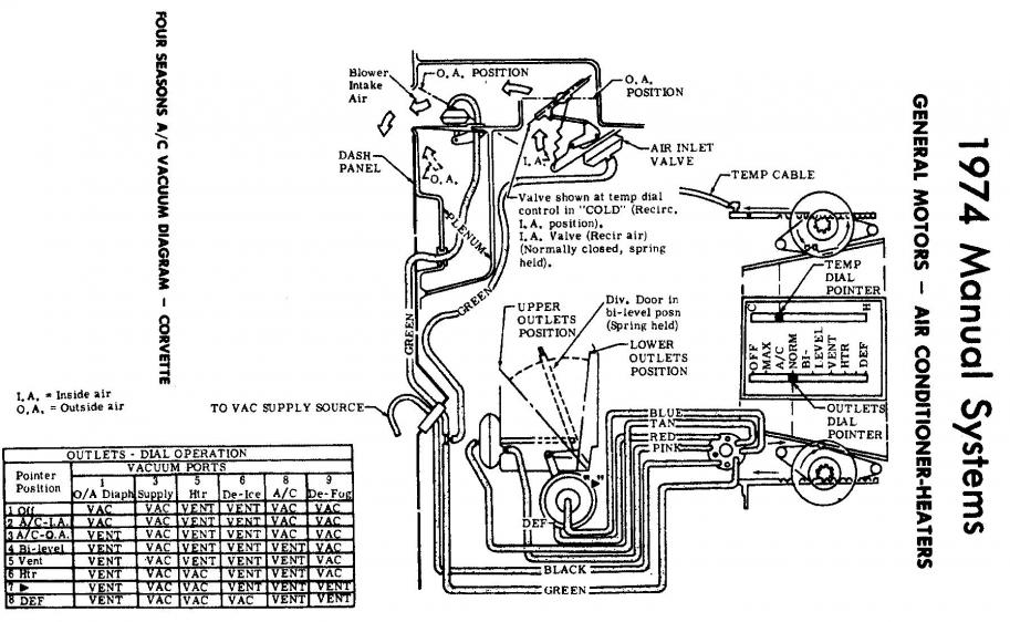

Welcome to the Corvette Forum. Defrost is the default position of the divertor door when no vacuum is applied. Sort of a safety feature since in the winter it's better to be able to see where you're going than have warm feet. Will have to troubleshoot the vacuum system.
hey thanks for the info and the pictures, this should help a bit. what is the best way to get to the lines? just take out the console, or is there a
specific part that tends to go bad? I have not done a lot of work on this car so I'm kind of new to its problems. just bought it last year.
In the first diagram you see a line called "To Vacuum Supply Source" lets see if that is connected, to do that:
Remove the air cleaner and look on the intake manifold just behind the carb, there is a fitting screwed into the manifold, that is where all the vacuum starts from. Follow those lines around, you should find 1 that has a "T" and goes thru the fire wall. That is the one that must be connected to "Vacuum Supply Source" in the diagram.

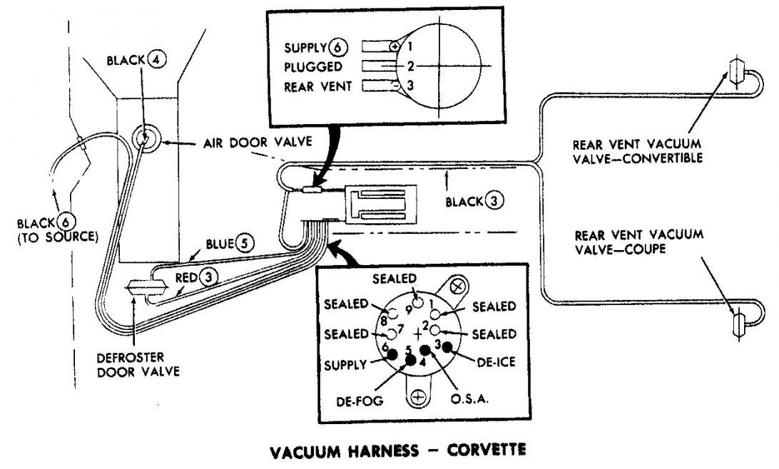

This is how it is on a 79:
Where it says to vac supply source, it goes through the firewall on the passenger side behind the dist. It connects to a junction (looks like a tree) right behind the glove box, just remove the inside of the glove box to get to it. On the diagram you see a cirlce with blue red tan and pink going to it, this is under the center councel below the contols. I pulled the dash and center to council to figure all this out and found out that the hoses from behind the glove box to the engine were rotten and just fell apart in my hands. You can get the hose at any auto parts store.

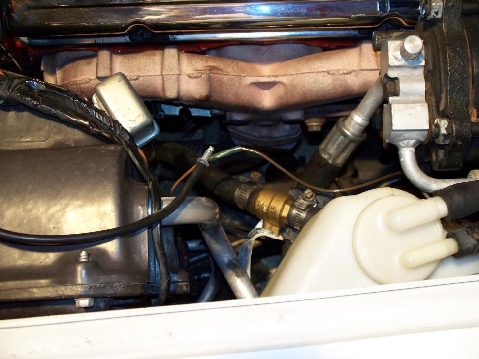

Do you have a cut off for the coolant going to your heater core? It would be a 3/4 inch hose coming out of the front top of the engine, a shut off valve, and then going down to the passenger side fire wall and connecting to a valve down there above the tire (a small vacuum hose will also come out of that valve. Open it in the winter to stay warm and turn it off in the summer to cut the heat coming into the compartment. Trust me, you will see the difference.

Hi again, you need a shut off valve to stop the hot water from circulating thru the heater core. Advance has it but it's listed for a 79, none are listed for a 74. The black hose coming from the left side of the picture is the vacuum hose that connects to the correct valve. When you turn the thumb wheel on the console it applys vacuum and that opens the valve to let the water circulate.
I put in a ball valve and pluged the vacuum hose. PG.
