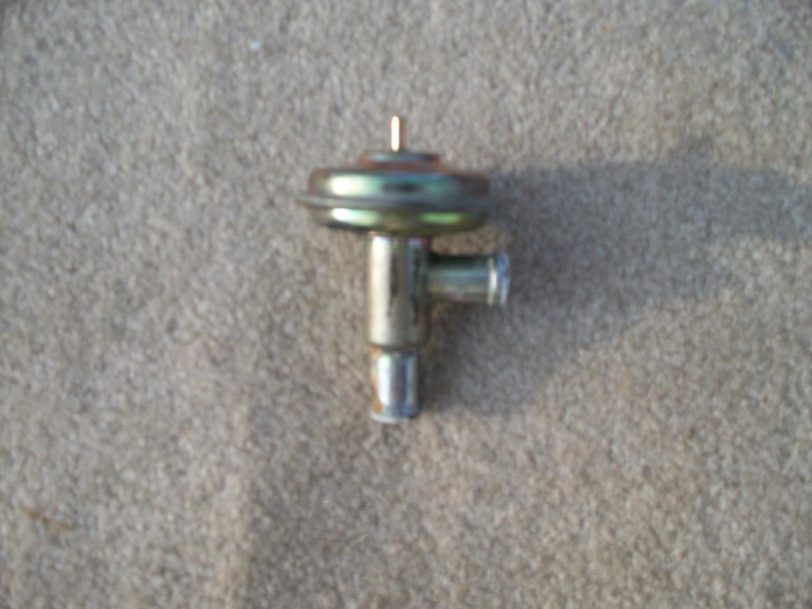

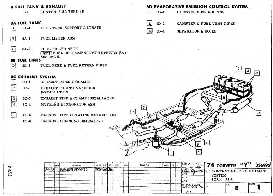

Actuators: In the Book they say to remove the grill to remove the actuators, I had a helper raise and lower the hood and took them out from the top.
The round thing might be the Vapor Canistor, one line goes to the tank and the other "T"'s with the PCV valve and then connects to full manifold vacuum at the carb.
My car came stock with A/C and the hot water shut off. Here's the one I took out. PG
Attached Thumbnails heating problem-stock-hot-water-shut-off.jpg   heating problem-vapor-canister.jpg

PG: Did you ever check the heater return line w/ the A/C on and the engine hot? I put a manual valve in my supply line and the heater core still would get hot after awhile from the return line so put a valve there also.
Since I put my own A/C in, wasn't aware of a valve in '73. Thought they started in '75 but since yours has one, then maybe mine should to. Will have to look for a vacuum port on the control head. If it does, might put a vacuum controlled valve in each heater line.

Hi 73shark, yes, after a long ride the other hose gets pretty warm. A second ball valve or a second correct vacuum shut off might let the A/C work a little better. PG.

That's kind of what I thought. If I can find a controlled vacuum port, I'll put in two valves. Otherwise will just stick w/ the two manual ones.

Do you have a cut off for the coolant going to your heater core? It would be a 3/4 inch hose coming out of the front top of the engine, a shut off valve, and then going down to the passenger side fire wall and connecting to a valve down there above the tire (a small vacuum hose will also come out of that valve. Open it in the winter to stay warm and turn it off in the summer to cut the heat coming into the compartment. Trust me, you will see the difference.
Hi, I'm resuming this post because I'm the new owner of the car and would like to fix the heating. Car has on AC, so is it supposed to have the cutoff valve? I dont find anything about inside the AIM...
Old May 7, 2012 | 11:41 AM
  #19
I believe the heater control valve was only on A/C cars but couldn't hurt to put one on as these non-A/C cars on a 90*+ rainy day are a sauna. Main reason I put A/C on mine.
