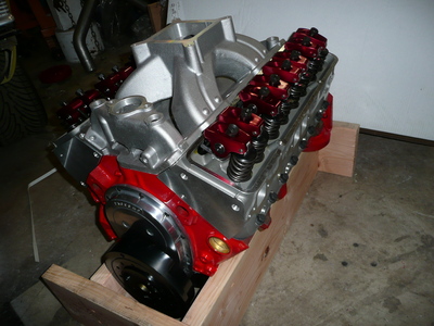

I tried to attach a pic...hope it worked. This is whats going in. It dynoed at 490HP with the dual plane "typhoon" intake and a Quickfuel Q-750, but the single plane "Hurricane" was offered to me for the same price. I checked out Vanacors web site, and they do look like nice hoods. Very good price, but do you think 2 1/4" cowl would clear?. I know I will loose low RPM power, but after talking with the engine builder, I decided this intake will be better for future mods I will be making. This car will be driven rarely, strictly for fun on a nice Saturday night.
