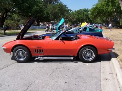

Here is the Patriots on my 69.

I took the liberty of bringin' up your pic.
Here it is.
Nice Vette ya go there. [sm=icon_rock.gif]

The patriots have 3 fake pipes and one real one for exhaust. If you check the description, the incoming exhaust is a 2" pipe. That's pretty tight if you plan on any kind of performance. You'll be reducing from 3" at the headers/collector to 2" at the lake pipe inlet. You might be able to find some lakes with bigger inlets, or find a real "nest of snakes" setup where the lake pipes are the collector, but... I wouldn't squeeze my exhaust quite that far.
