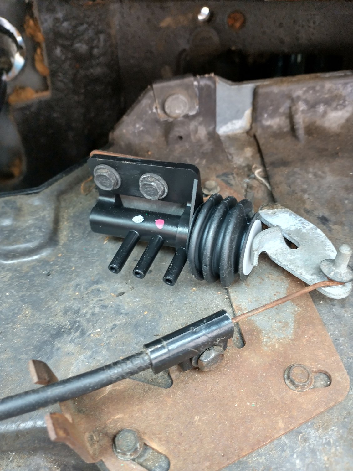

Hello everyone,
It's been a long hiatus - I've had to travel for work and did not have much time to tinker with the corvette. Thomas77 was correct, that small hose lead off to the HVAC controls. I ended up confirming this with a diagram I received with the HVAC hose replacement kit from volvette.com. I'll post a picture of this tomorrow, or early in the week if I can get to it.
I tested the vacuum actuators (diaphragm cans) for the headlights with a hand vac pump and found that they both worked. However, I forgot to test the headlight relays. After replacing all of the vac hoses and doing some troubleshooting with the HVAC vac system, both pop open pretty quickly (not simultaneously, but I'll take it). However, only one of them shuts. I have a feeling it's the that headlight relay.
I ended up tearing into the dash to find a battery drain, and in the process I replaced all of the vacuum hoses and all of the valves which I found to be leaky in the HVAC system. (leak tests were done with a vacuum hand pump) I should mention that none of the HVAC controls were working before this either. Here are the items I replaced (excluding the hoses):
Temperature control valve
AC water shutoff valve
Heater hose water shutoff valve
Blower motor and fan
HVAC controls work now, although that temperature control valve is not the best. If the lever isn't placed perfectly, it'll leak. It feels cheap and plasticy. Also, that AC water shutoff valve (see pic, its atop the heater box) has a really stiff spring. I can't move the temperature control lever all the way to "cold" without that spring forcing the lever right back. The old and leaky AC shutoff valve I replaced also did this, and I expected the new one to be less stiff or more lubricated. But no amount of tension/length adjustment in the control cable could overcome that spring without me holding the lever all the way to "cold". On top of all that, the air being blown by the fan is very weak, even at full blast. I can barely feel the air with my hand up against the vents, although it is there. So, more puzzles to solve.
