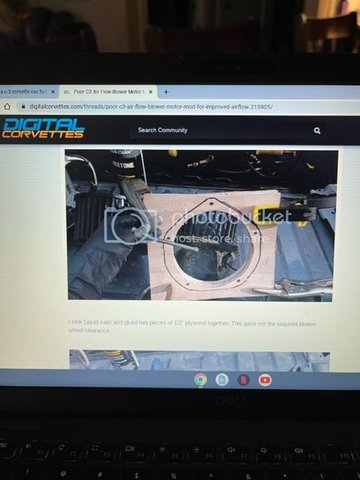

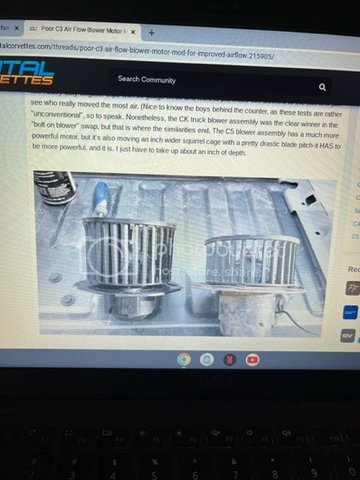

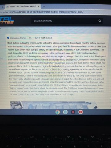

I read an article years ago that said you could use a C4 fan to move a greater volume of air. It did require a spacer between the fan and the ductwork.

Mr. 73 shark I saw the article about C-3 fan performance you were referring to I believe, It was an article on Digatal Corvette forums on 1/3/2014. Interesting article.

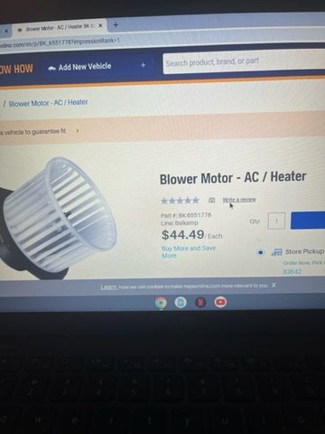

Found a fan and motor on rockauto, a/c delco for $38. I can`t find a ready made 1" spacer, but amazon had 1"x12"x12" plastic for about $25. I will make a spacer. I think it`s worth a try, thanks for peeking my interest..

I seem to remember from when I read the article that they used a piece of 3/4" plywood for the spacer. If I'm looking at this right, the extra portion of the C4 fan will actually be inside the spacer which will limit its effectiveness to increase air flow.

There was no password, it was an old story I ran across. I will go back and see how i found it. when i saw the story i remembered what you said about the C-5 fan and motor. this guy was using two pieces of 1/2" plywood glued together to make 1" spacer. then he mixed up some fiberglass resion to coat the wood for water proofing. I will search for the post.

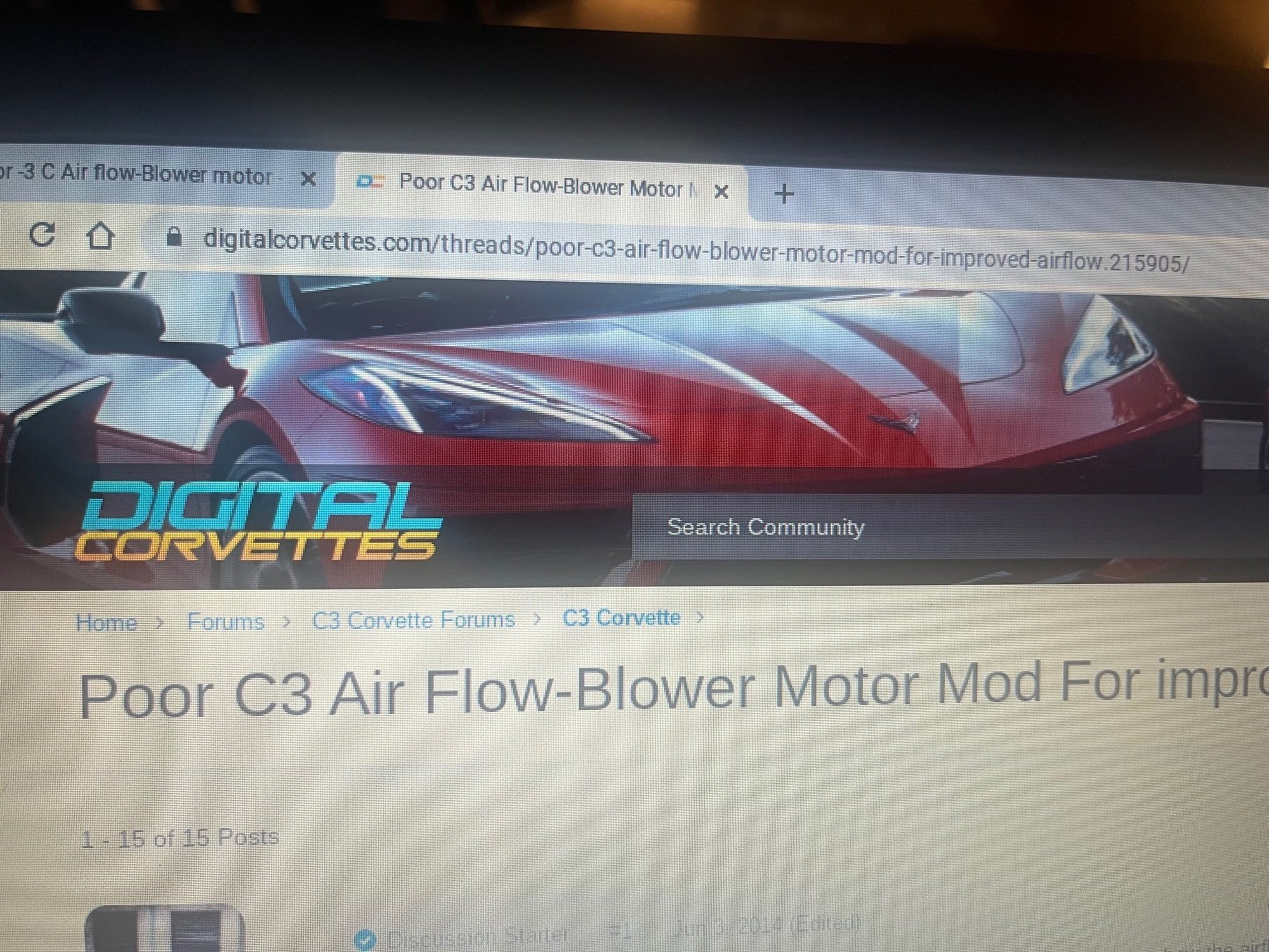

I found it by google search Poor C-3 Air flow-Blower Motor. And it took me to Digital Corvette story. No log in No password, I did get the date wrong it was jun 3 2014 not jan (reading has always been hard)
C-3 hvac modifications
Old Jun 25, 2022 | 10:51 PM
  #29
Thanks, found it.

I see that he used a C5 blower. Is that what you got?
