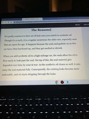

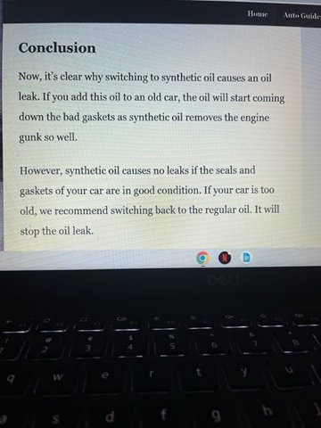

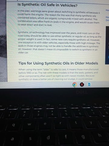

That's a very good question. Had 92 Jimmy 4.3L bought it with 100k miles, ran it for another 100K miles using synthetic blend oil, no issues. 2004 avalanche 5.3L 130K switched to full synthetic 2 years ago, started leaking and burning more oil. Considering switching back to the blend before pulling the oil pan. Try to find that happy medium somewhere. Found some information on this subject, thought it was interesting, hope it helps.
