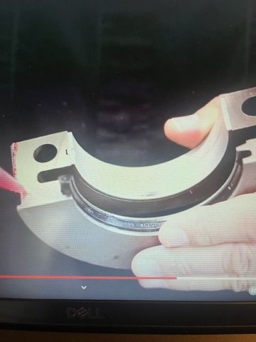

I have never been a big fan of additives, but I have seen them help sometimes. They are a lot like bandaids not really fixing the problem just making it look a bit better. It's a good time to deal with the oil pump if it has issues with the pan off. Found a picture of a guy installing a main seal and staggering the seal ends. I have done it this way.
