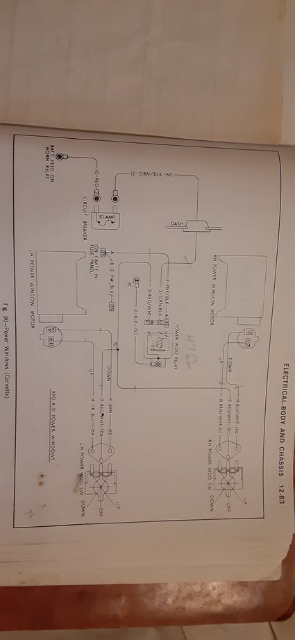

Apologies in advance. Test the motor on the passenger side for 12v ...wire colors? Thanks
Old Aug 25, 2020 | 11:32 AM
Posts: 4,213
Hope this works as I'm doing it from my phone.
Old Aug 25, 2020 | 11:35 AM
Posts: 4,213
If you can read this schematic, you can see that there are several places where the voltage could be lost.. 30 amp circuit breaker, the relay, and a possible broken wire in between somewhere. This is in addition to the motor itself being bad.
