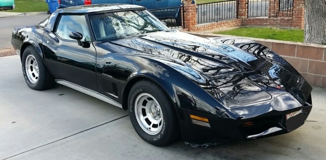

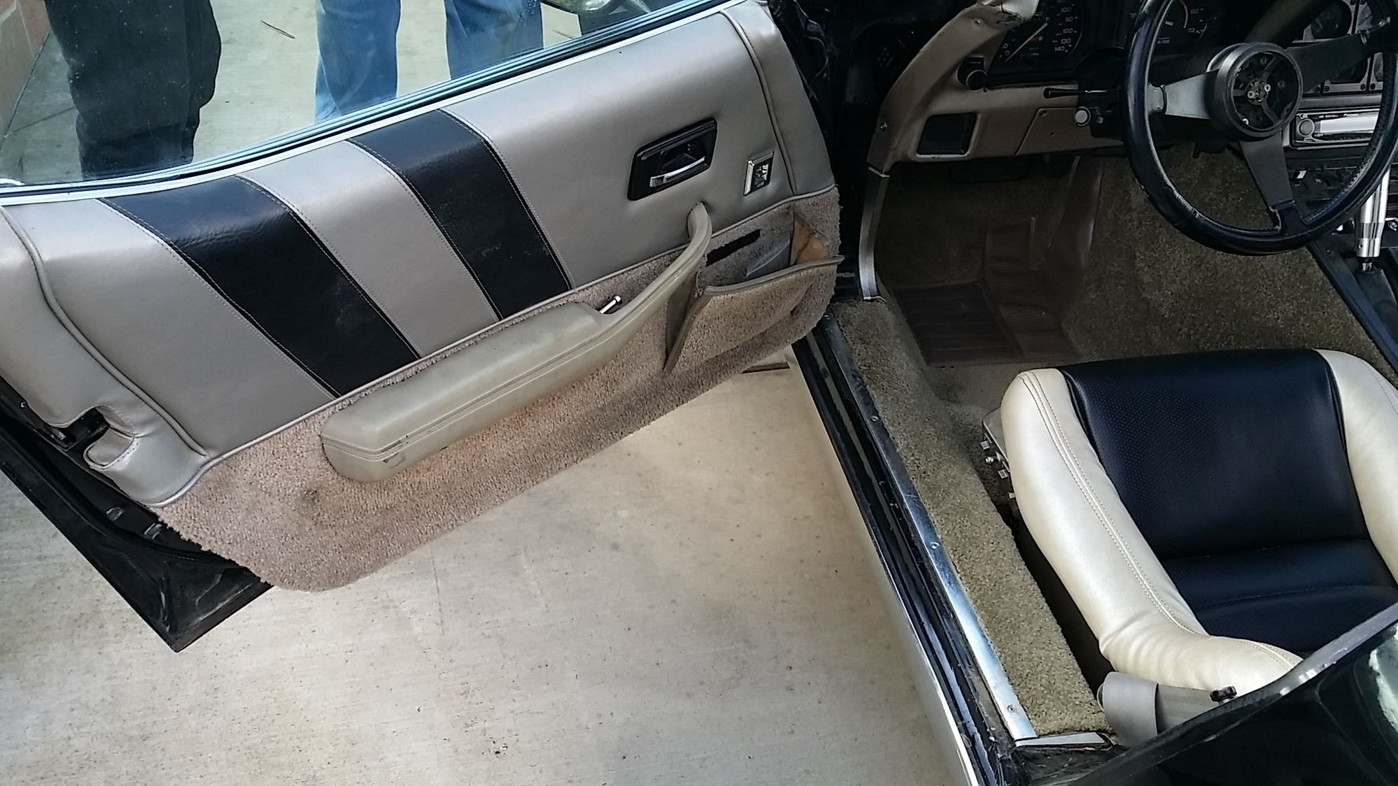

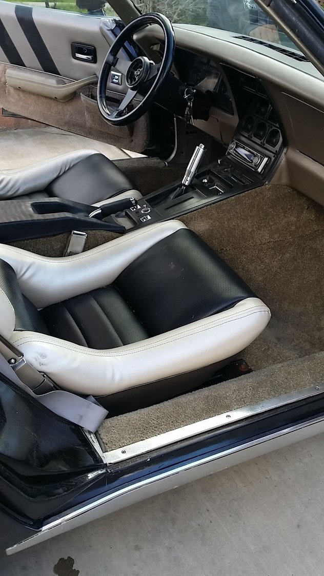

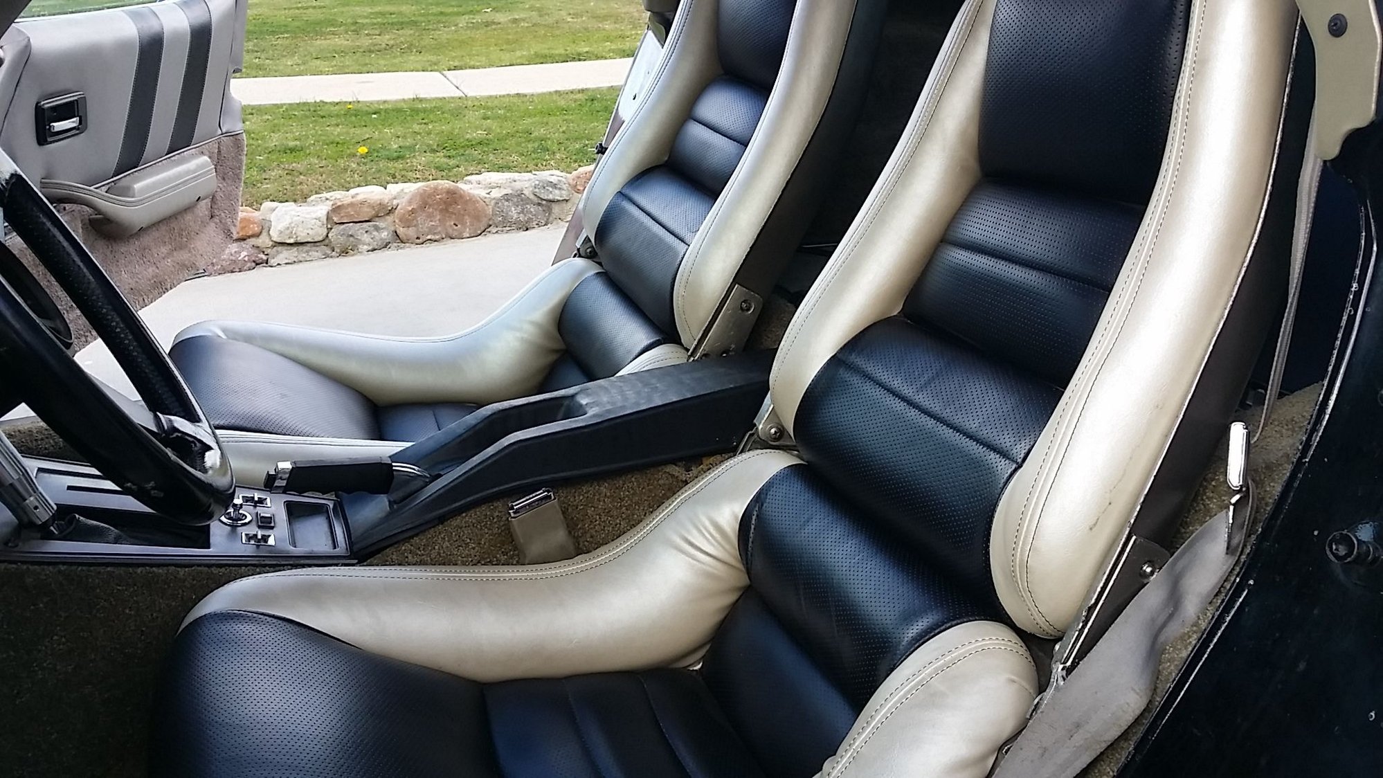

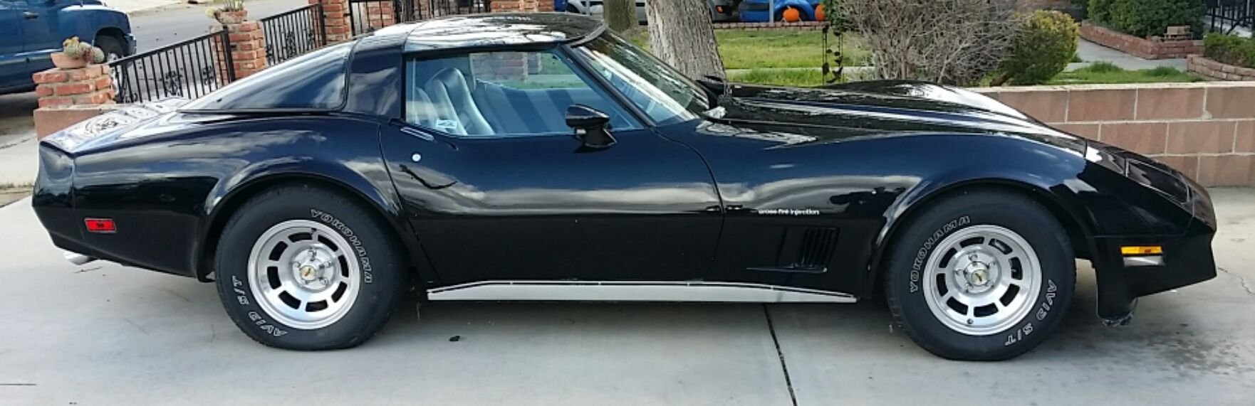

So his car is a 1982 CE driver condition. Clearly not original but not all that bad considering. I'll probably be stoned with boulders by other members but I'm not a big fan of the original CE paint jobs other than the price they bring when selling. If it still had it I would say yay. Since it doesn't I'm fine with it. Someone painted it before him and changed the interior some. Door panels and seats were redone. Swapped the wheels. Runs great and shifts great in spite of my not so favorite chevy cross fire setup.

Don't worry about what other people think about you modifying YOUR car. It's yours and you should have fun with it. It looks good by the way, and I would ditch the crossfire for a Holley 650 and Victor Jr.
