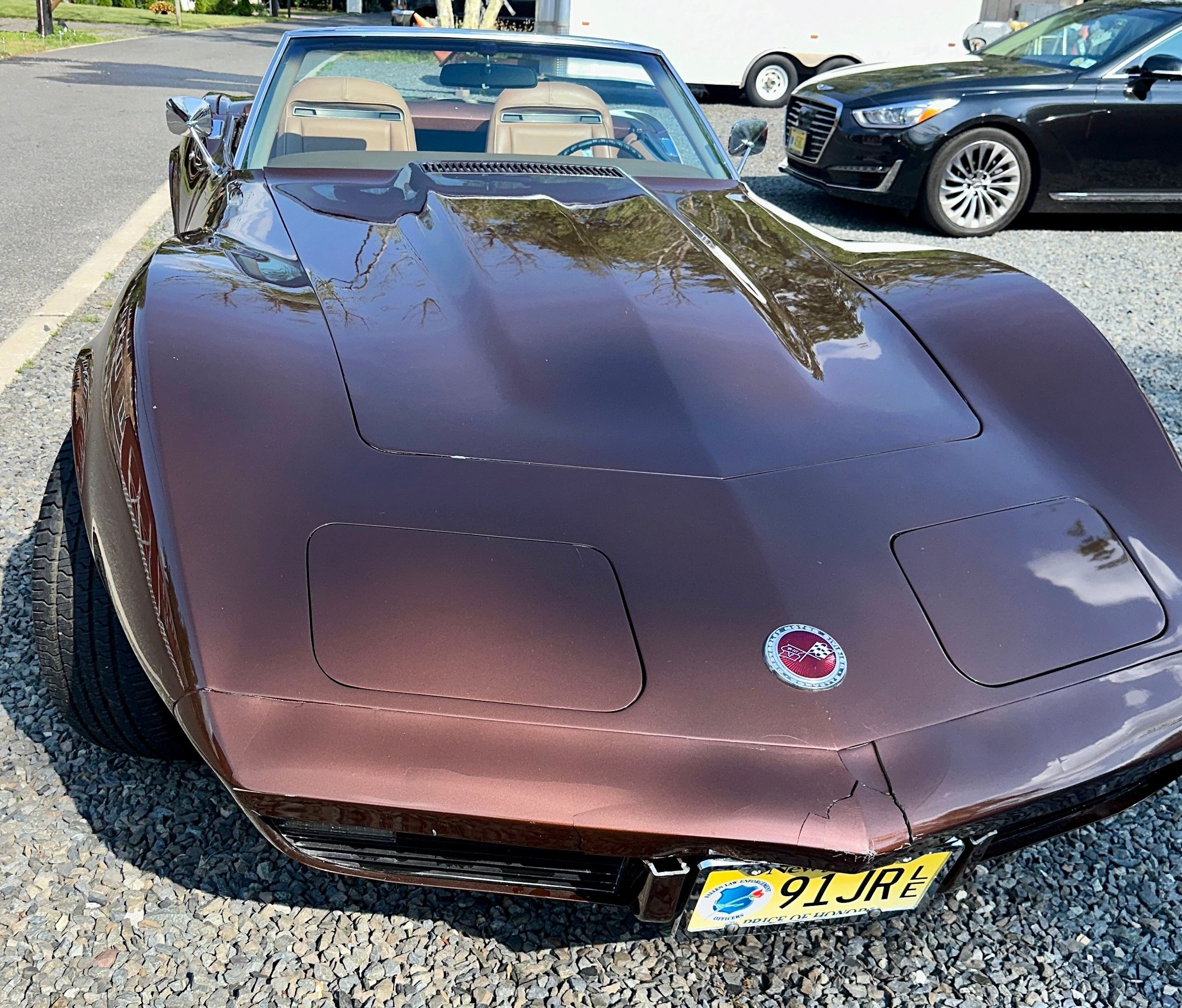

By the way, if you think my front bumper cover looks bad, the back one makes the front look like it's concours pristine perfect! Can't wait to get them both done!
