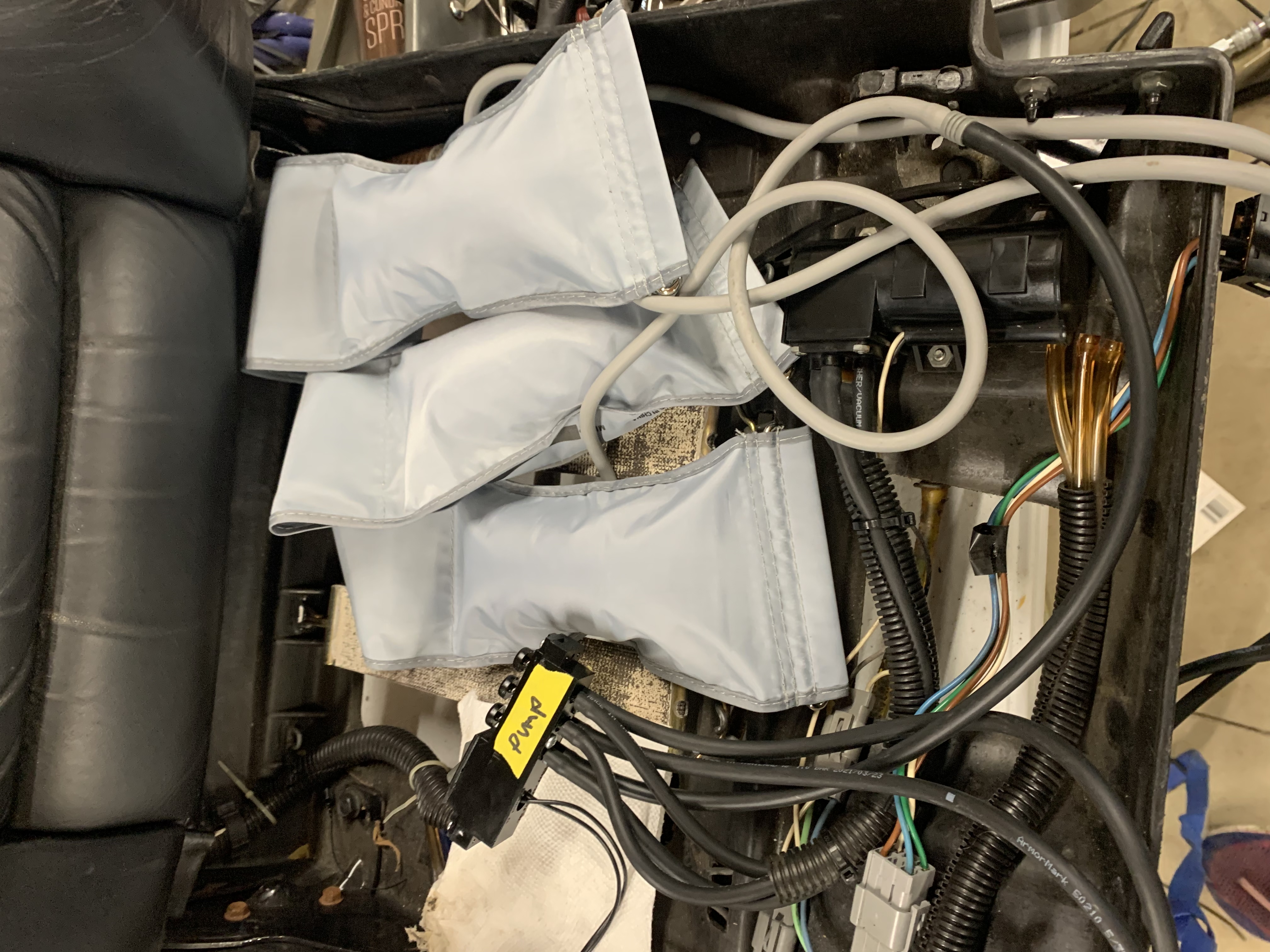

thanks for the assist. I am working my way through this. One of the lumbar air pumps was fried. I mean melted the plastic case was all deformed. Probably lucky it didn’t start a fire. The lumbar bladders were just a pile of paraffin. Luckily the other motors that run the side wings run forward and reverse when I apply power seems like neither of the switches are working. The lumbar release buttons appear to be working. I ordered 6 blood pressure cuffs for $10 each on Amazon and I bought a Ford lumbar air pump off eBay for $24. So for about $100 and a couple hours of my time I have things moving in the right direction. I need to do a little more testing on the wing motor switches to figure that out.
it bugs me when things don’t work.

Hey, keep in touch. Let me know if that works for you. So you intend to replace the bags with three individual bags (BP cuffs) and use the ford pumps. The next scarce item is the little plastic connectors. The hoses are generic but those connectors are scarce. Mine were fubared, I found a few several years ago but my seats have been on the back burner. I keep thinking I will get to them some day but......besides I like your ideas better than mine.

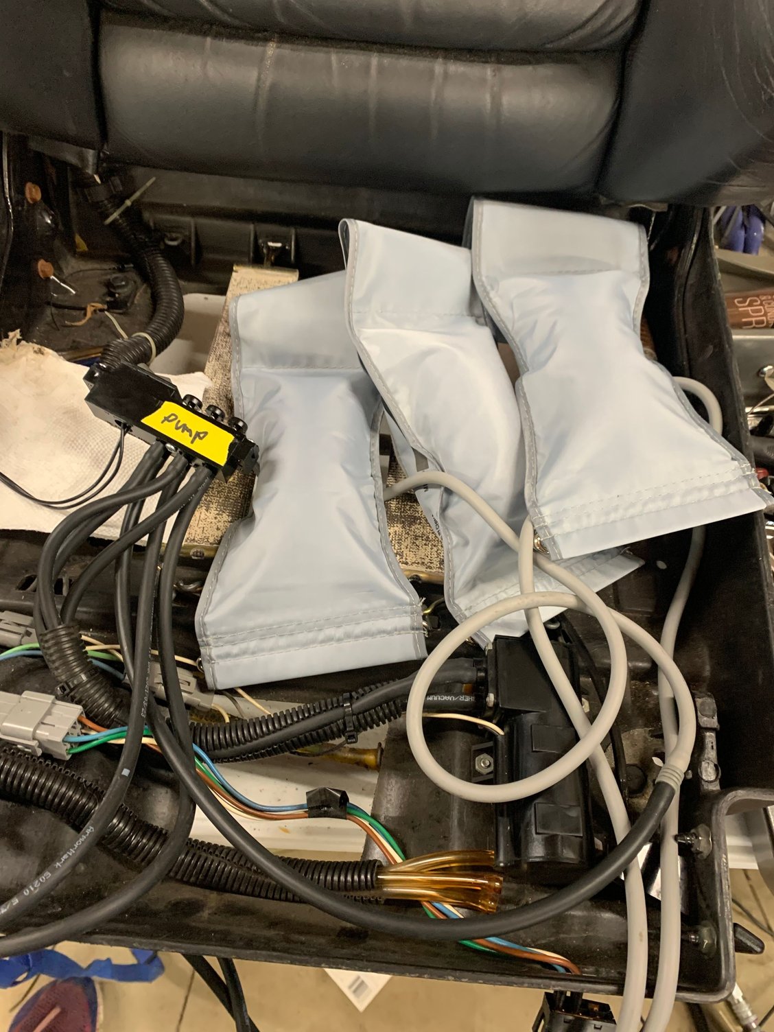

I have one seat done and the other in process. The blood pressure cuffs work great. I had to take the “Trumpet” switches all apart and clean / lubricate them as they were stuck open. I decided to replace all the lines too. The $24 eBay pump didn’t work so I bought a gm one for the corvette for $54 on eBay. The ford one wasn’t big enough CFM to fill 3 bladders at one time. I decided to tie wrap them together so they don’t move around in the seat. Took the side wing switches apart and cleaned them all up. In a few hours I will have 100% fully functional power sport seats. I used infant size blood pressure cuffs. They measure 9 inches tgey seem to fit better than the adult version.
