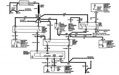

Here is a wiring diagram attached the MAF. Check your voltage from the MAF relay, not the burn off relay, as it is for cleaning contaminates of the hot wire sensor after engine shut down. Check for voltage from MAF relay and check ground with an ohm meter.
