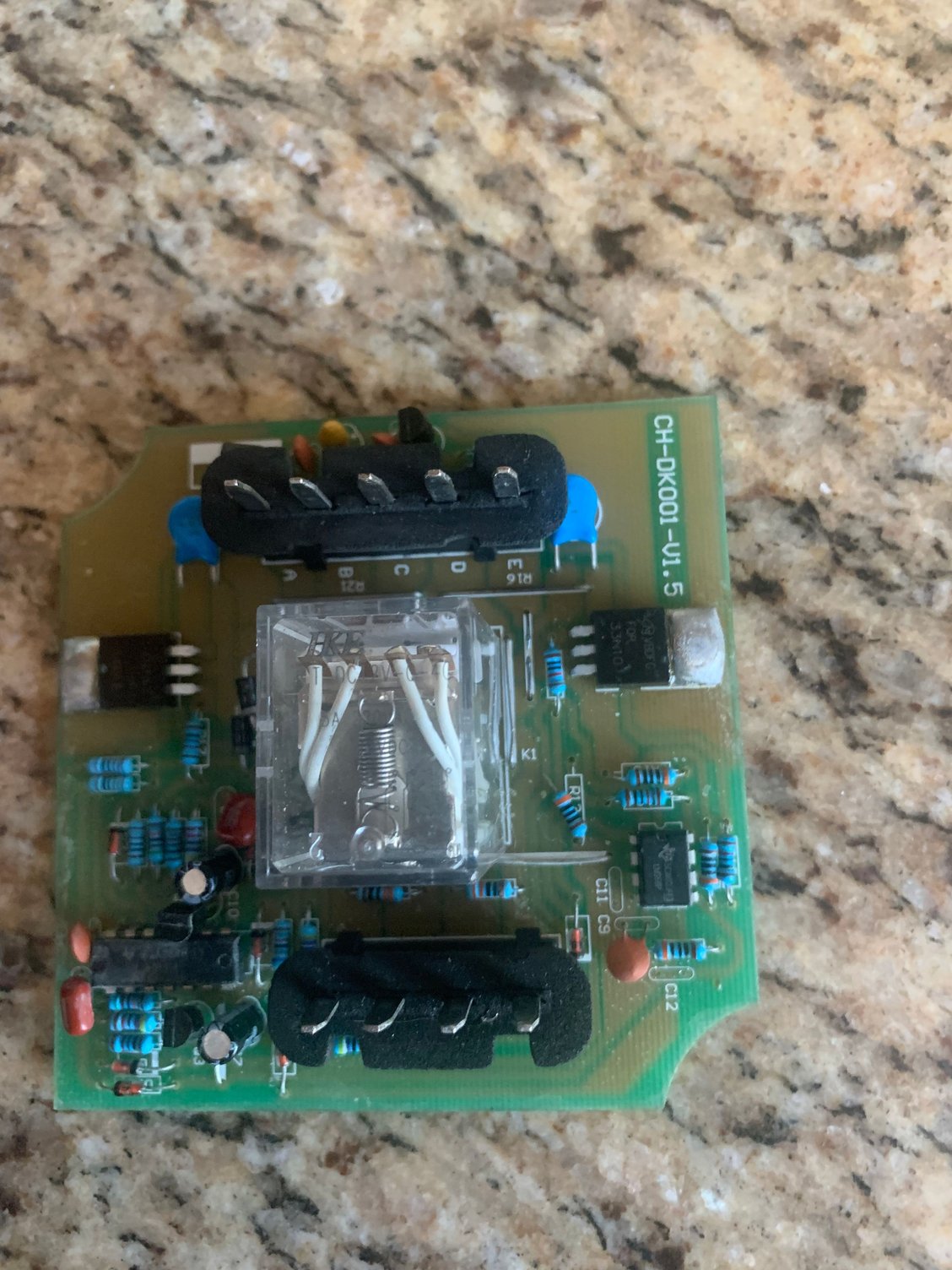

Guys I really appreciate your input and I can’t believe I figured this out! I will try to send pictures if I can figure out how to attach them here. Basically, there is a headlight control module located just in front of the left wheel, a small square box with two screws mounting it to the car and two wire plugs going into it. I disassembled the module and looked at it with a magnifying glass and noticed what I’m going to call a “filament “had been burned in half. I removed the filament and soldered in a new one – which was actually a push pin - and it worked! Other articles I had read said the relay, which is the large rectangular piece in the center of the module, often has burned wires which sometimes can cause headlight problems. My relay looked OK so I just looked over the small circuit board with a magnifying glass looking for any loose connections or things out of the ordinary and noticed the problem. I certainly recommend anybody having weird headlight issues to check out this headlight control module for any irregularities. It is easy to access and to open and inspect.

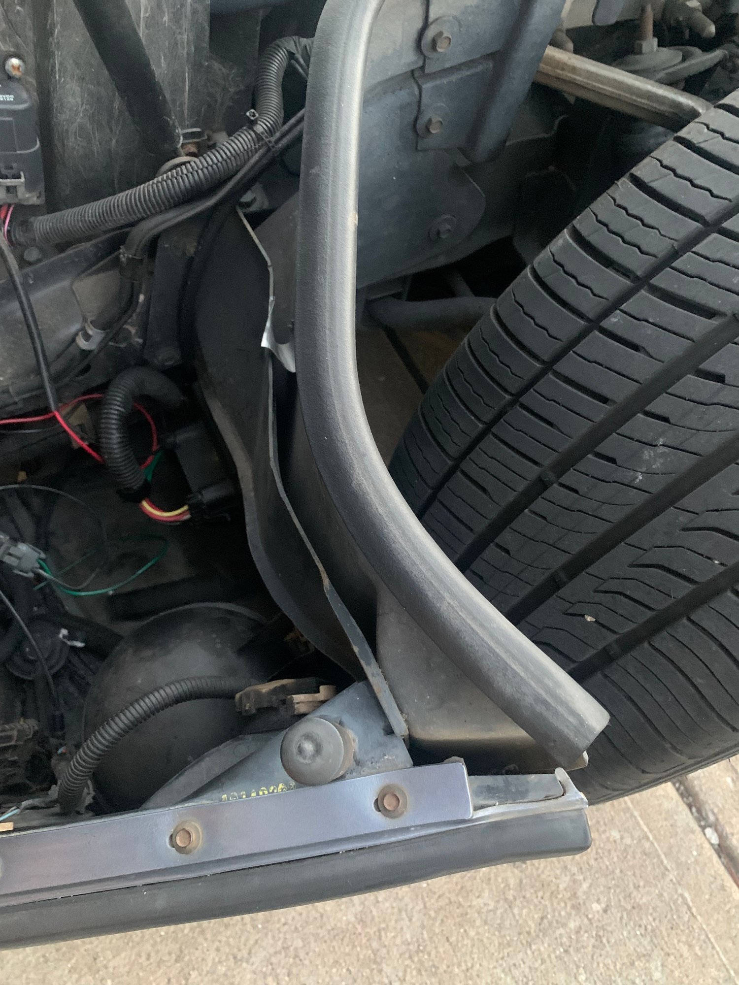

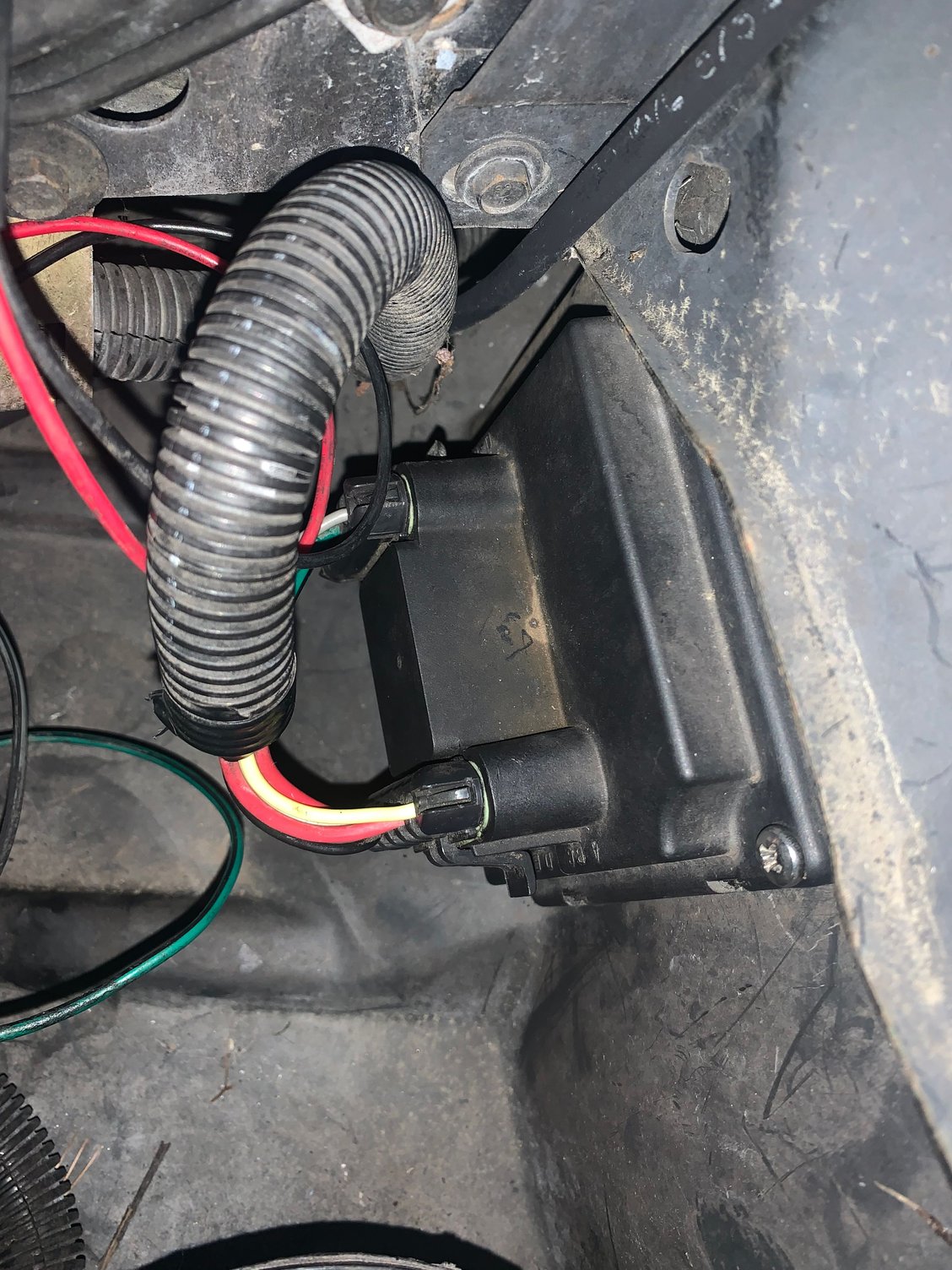

This is a picture of the headlight control module located in the wheel well in front of the driver side wheel. It is the small black box with two sets of wires connected to it.
Old Nov 14, 2022 | 09:09 PM
  #19
Allen55555's Avatar
Joined: Nov 2022
Posts: 12

Old Nov 14, 2022 | 09:12 PM
  #20
Allen55555's Avatar
Joined: Nov 2022
Posts: 12
Open up the headlight control module and the circuitboard is inside. The large square in the middle is the relay.
