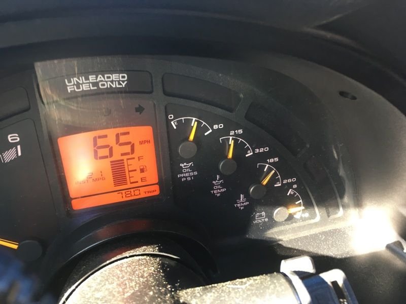

All of the analog and digital gauges seem to work. Readings all look normal at highway speeds. Car idles nice Hot and cold.

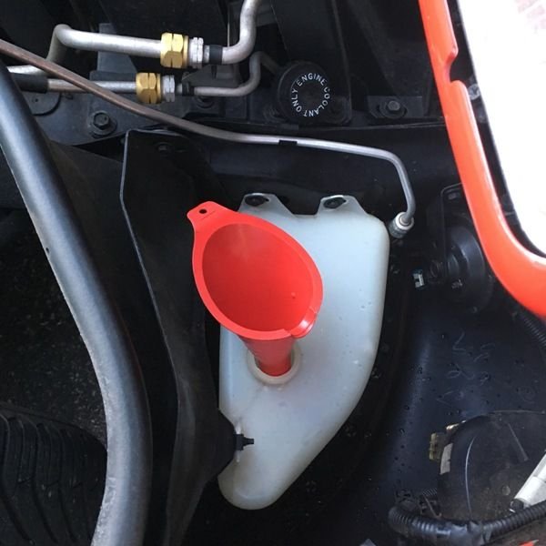

Starting the cleanup process. The coolant tank was full of brown crud. MAW, I may as well, replace the thermostat, coolant and any old hoses while I am at it.

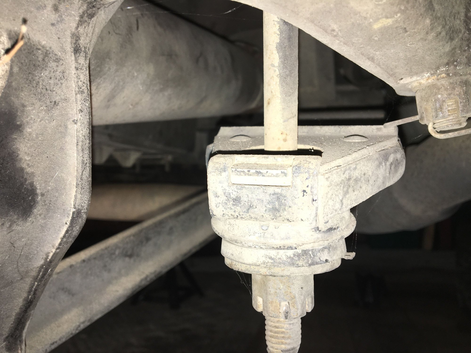

Most of the way through the liquids replacement.
Today discovery is a damaged bushing on the "transverse" spring?
I guess its time to replace the busing's for the spring.
A new set of shocks are not too far in the future.
Can I re-use the long bolts?
Looks like time for new rubber.

Yes, that is your rear transverse spring and yes, you can re-use the old bolts. Make sure you have the is spring supported before you start removing the nut. I can't remember if I caught the metal end with my jack or just used a hockey puck between my jack and the spring on the rear. There is another transverse spring in the front that seats on your lower control arms.

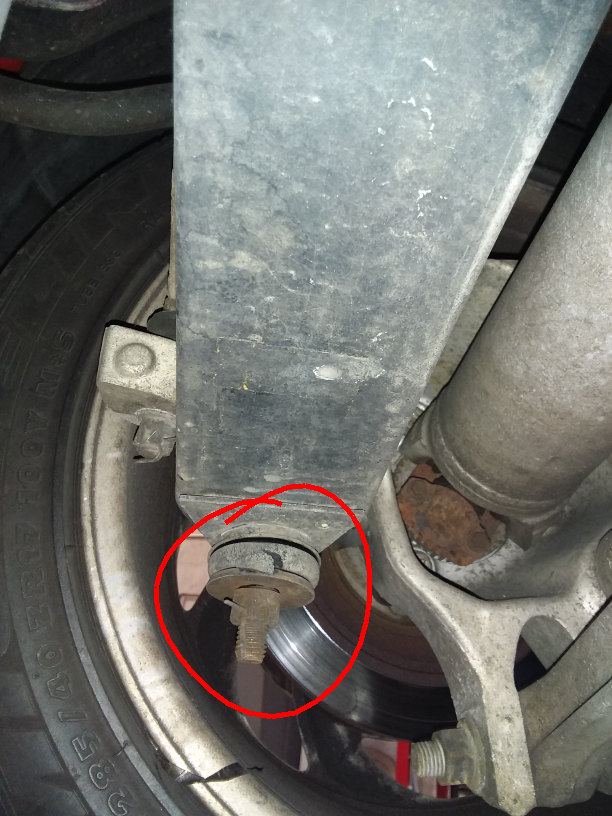

right, passenger side
left, driver's side
I doubt those two bushings alone are going to get it done for you. I just looked at my old pictures and mine looked better than yours.

The coolant looked like a muddy river. I removed the Overflow tank and cleaned out all of the mud.
Now the whole system is Irish Green 50/50 mix (happy st patty's month).

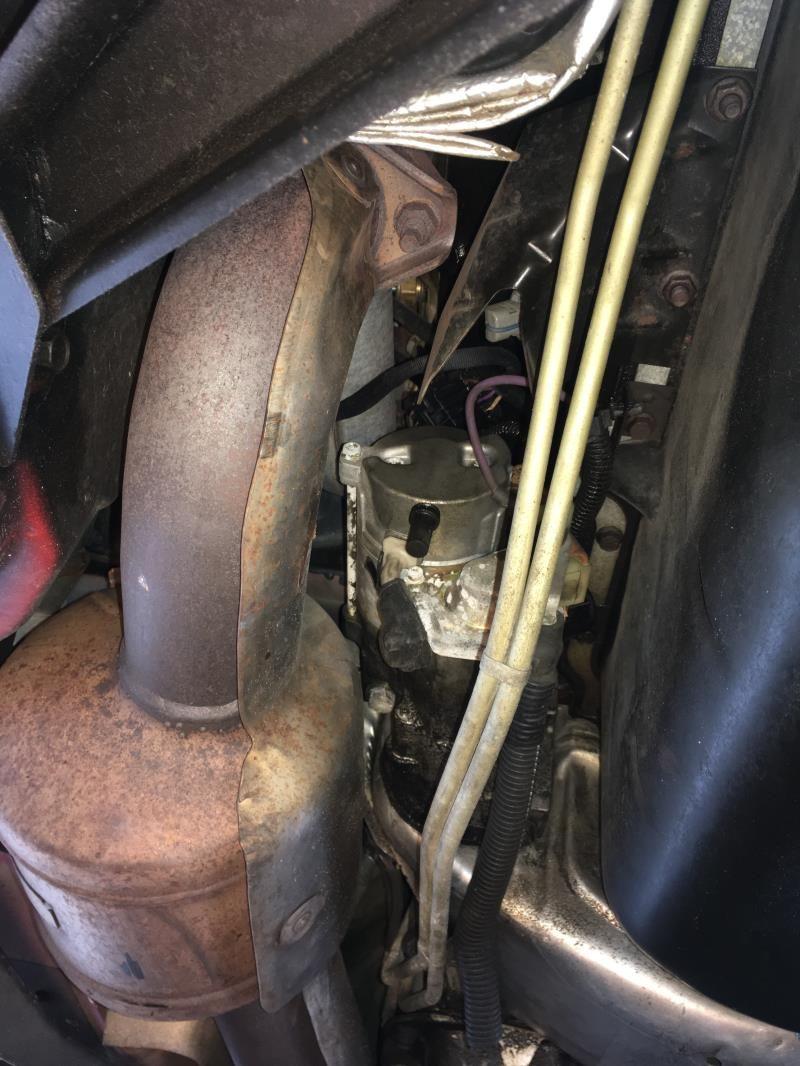

The 95-corvette smell like cooking fiberglass.
I do not think anything is really burning.
I think this may be normal for a car with 2 catalytic converters warmed up to 1400F, sitting a few inches below a fiberglass body.
I am not sure if I am missing any heat shields. My novice looks under the body shows many different types of shielding around the exhaust and other places. Everything appears to be original to my untrained eyes.
While driving, there are no detectable odors or unexpected sounds.
Passenger Side Cat, with Starter. I can see some metal shielding and folder silver insulation blankets.
Driver Side Cat. Similar shielding.
